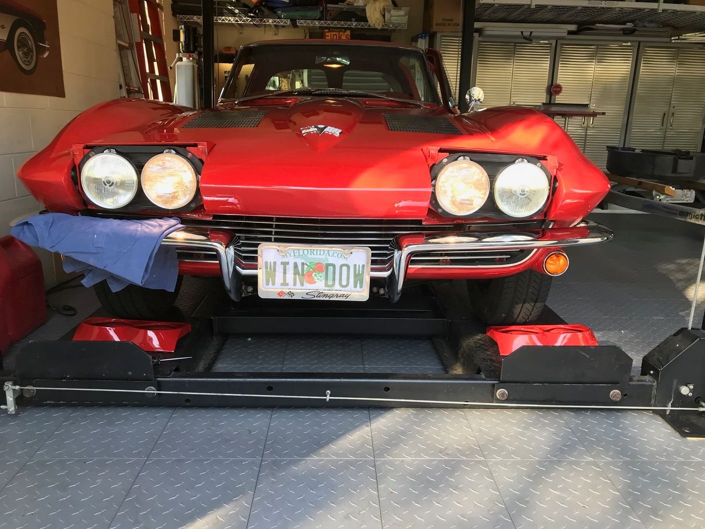

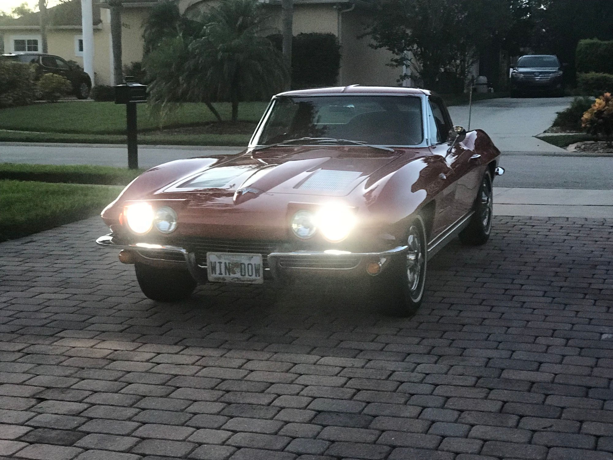

LED light dispersion is indeed a problem....there is one version now that has the reflectors sort of 'hooded' horizontally about 1/2 way down to keep the light out of opposing driver's eyes. You can see this effect in the outboard low beams in the first picture. The inboard lights are the high beams -- halogen and you can see the difference in brightness.
The second picture shows how the beams are focused (although 25' is considered the true test) and directed and the last picture is at dusk.....not cheap but my night vision is crap too. Haven't had any opposing drivers blink their lights at me that the LEDs were in their face...
The LEDs use the factory wiring and headlight switch - no relays...
