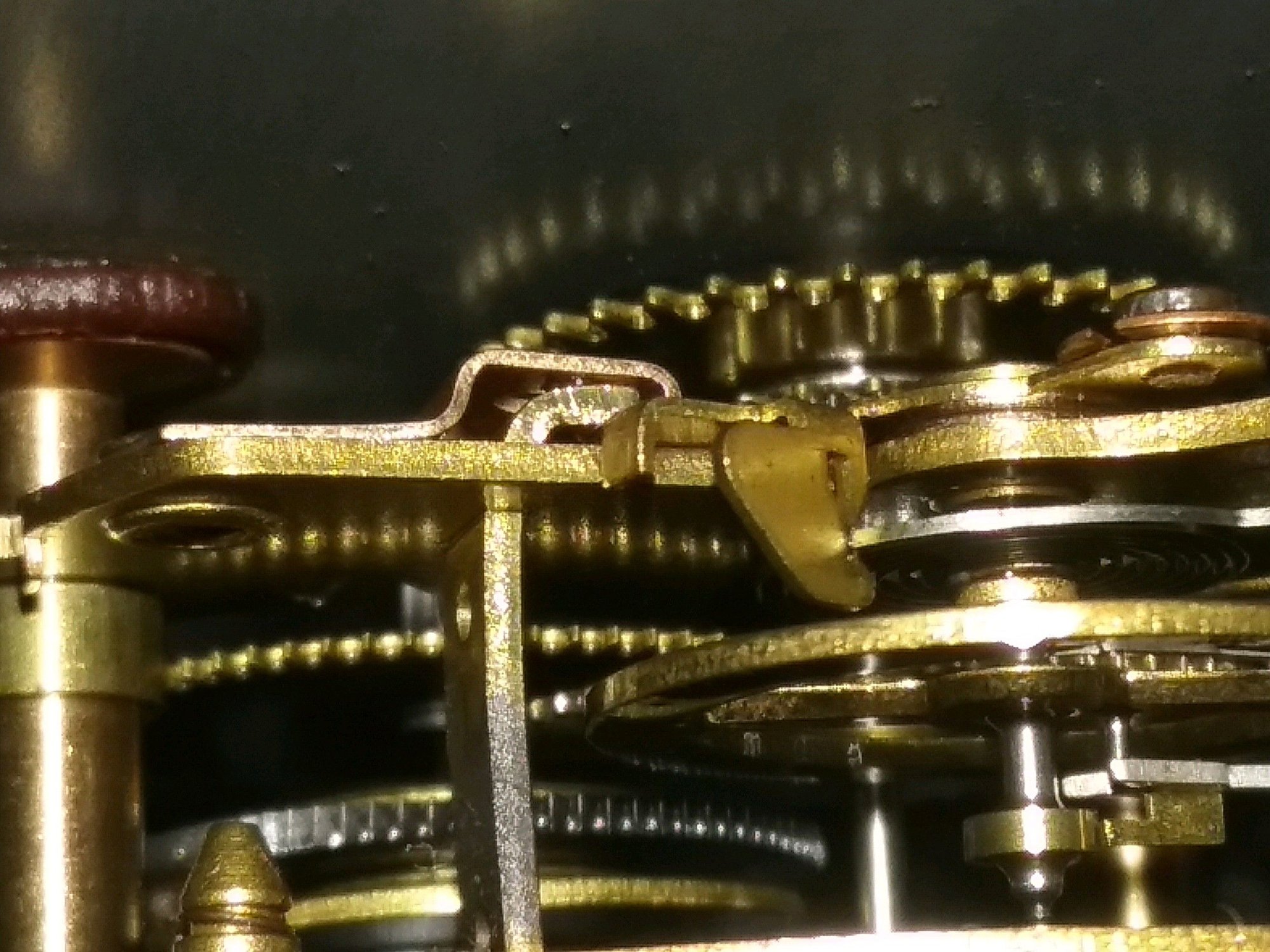

I just went through this last week so I'm very familiar with how to adjust the speed. I never had any luck with adjusting the speed of the clock forward or back using the **** on the front of the clock. If your clock is still apart (or you can actually do this with the clock assembled, you will have to use a screwdriver through the light hole that is behind the 8:00 position) find the lever that the arrow is pointing to in this pic. It slides to the left and right. Push it to the right to speed up the clock, push it to the left to slow it down. The clock in this pic is from a '71 buick (my clock is reinstalled in the car or else I would take the pic. The internals of the clock in this pic are very similar. The lever to adjust the time is definitely the same.)

1FLY65 - is the tab in the middle of the picture. If that is it, there isn't much room to push it to the left, lots of room pushing it to the right. There is a spring (main spring spiral?) that seems to be pushing on the side of it.

judging by that position, it looks like that's as fast as the clock can go. pushing it the other way will only slow it down. I'd try nudging it 1/8" to the right. Then check it against a stopwatch. If you think it's close, hook it up to a power source or back in the car and let it go for another day.

1FLY65 & Nalrops - if where the tab is located indicates that is running as fast as it can go, since I do need it to slow down I will move it a little to the right and see what happens.
