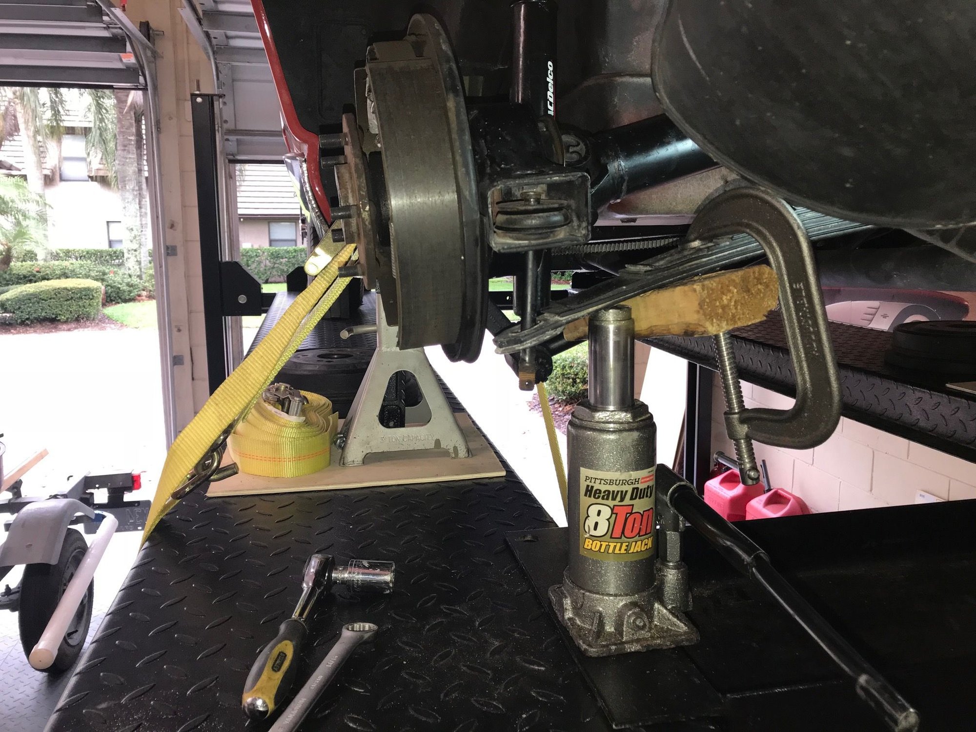

A last bit of advice - those springs can be a bit dangerous....I use a "C" clamp with a piece of wood abutting it with the bottle jack at the end and you have to make sure you aren't jacking up up the trailing arm if the car is on jack stands - making it unstable...
I ratchet strapped the trailing arm to my lift's ramps to do the deed.
