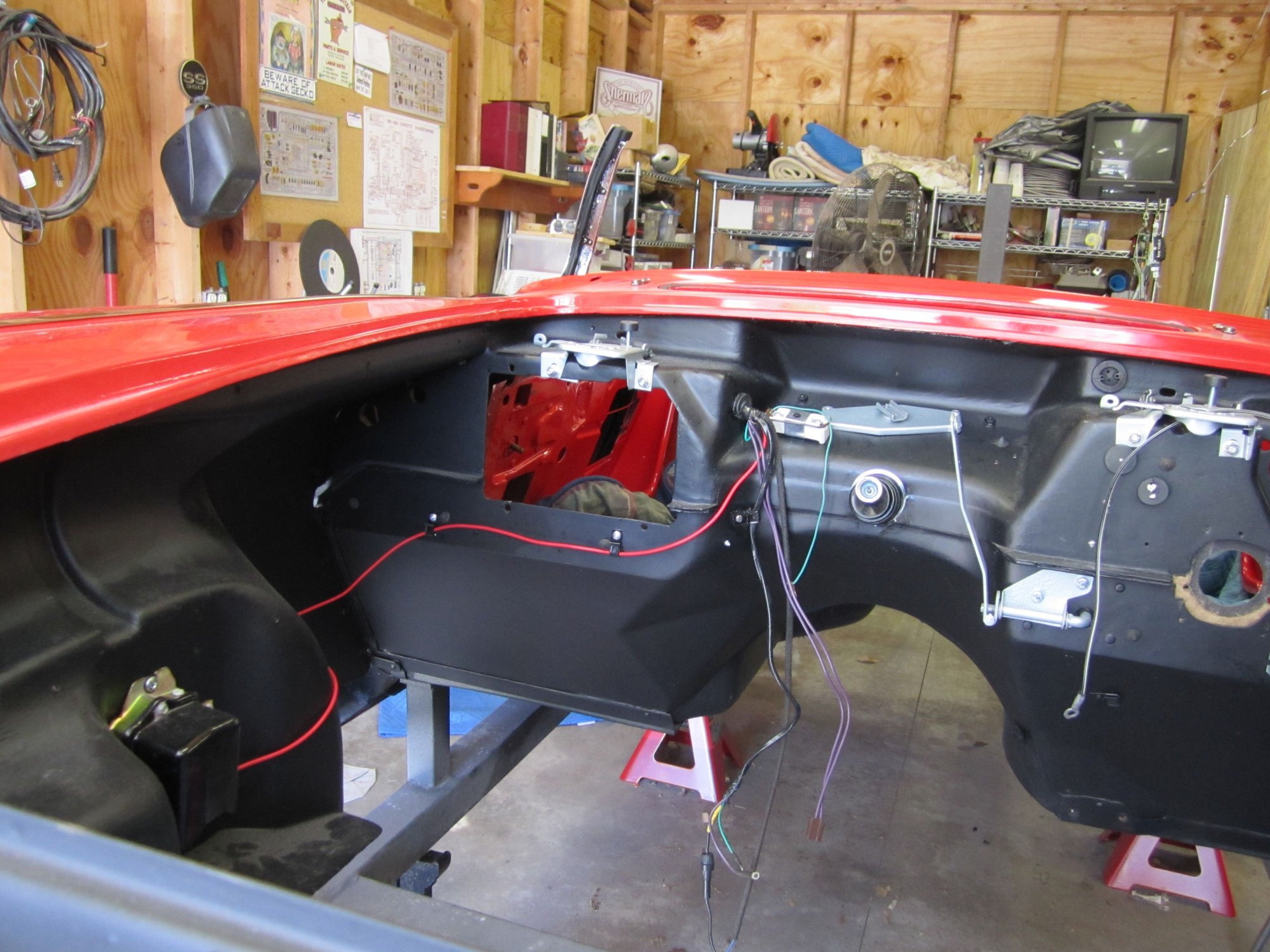

Don't know if this will help you can zoom in on the boot. The prongs do go in from the firewall side its been a long time since I did this If I recall correctly I bent the prongs so I could get them through the firewall them bent them back then inserted the boot from the inside under the dash. Good Luck went through a lot of the things you are going through.
Claude
