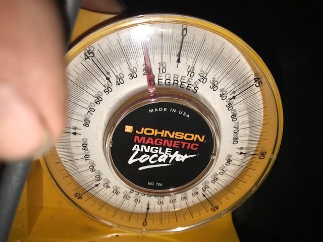

Sorry for the late response Herb - I was at a veteran's car show most of the day.....tough area to get a picture of and the flash distorted things a bit but here ya go. And I'm betting you know this car !
I show about 19* - everything is stock. I think 20* wouldn't put you far off!
