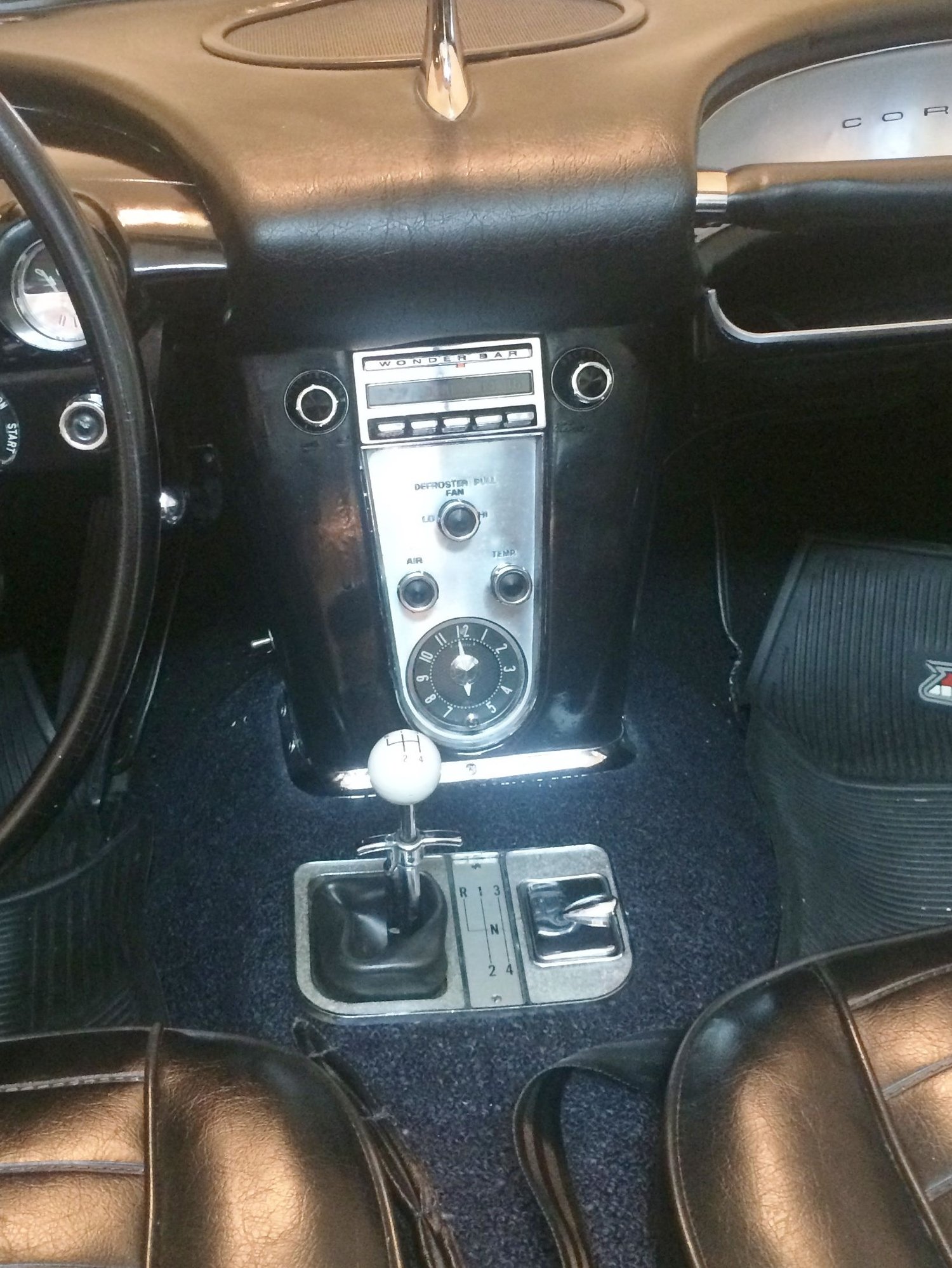

I am at the crossroads of having the Wonderbar repaired or replace it with a AM radio
Which one do you like?

There is a 3rd option.. There are shops that can gut your Wunderbar and convert it to modern (AM/FM/USB/Bluetooth).
There are varying degrees of Wunderbar copies.... ranging from $200 to $700+..
I went with a $200 Retrosound.. no regrets.. Looks OK and I don't listen to the radio too much!
Keeping an original Wunderbar radio in good working order is going to be very challenging unless you can repair it yourself.
Most of the guys who do that work are retired or gone.

FM appeared part way through the 63 production year. There are services that will gut your original radio and install solid state components and support Bluetooth, etc.. Nobody will know it was done unless you tell them..

I've had both -- in my 63 I had the AAR Wonderbar solid state clone which I sold to a forum member and had my original 63 AM/FM internally converted to the Aurora solid state setup... There was no discernible difference in sound IMO (both setups used the 140W dual voice cone 6x9 dash speaker)...
The advantage of the clone radio is that it is only 2" deep so MUCH easier to remove/install and if you have aftermarket A/C (Vintage Air) it allows plenty of room for the ductwork...
The advantage with the internal conversion of the original radio is that it will pass judging and the push buttons and bar has the heft and feel of an original - the repro radio buttons feel light and cheap. It will also have the Conelrad symbols on the dial (if it had them originally) - the repro does not.
Now - on a C1 radio - pretty much the same, however an original conversion will retain the small red sensitivity slide button on the dial, the clone radio doesn't have it.
