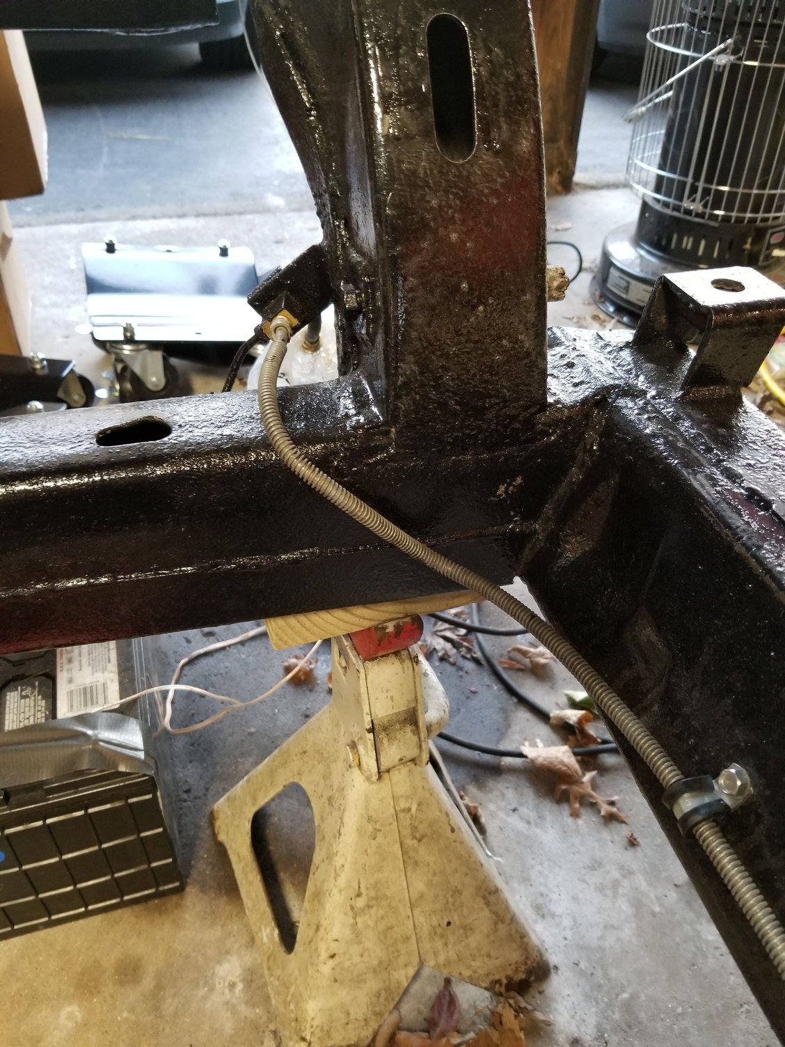

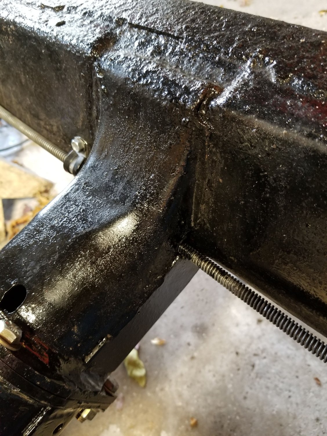

Old Jan 5, 2019 | 05:16 PM
Patrick03's Avatar
Patrick03
Drifting<br><img src="/forums/images/ranks/2k-3k.gif" border="0">
Joined: Aug 2016
Posts: 1,868
Likes: 827
From: Grosse Pointe, MI
I did replace all the lines on my car. I happen to have the body off so I took some pics of the routing.
