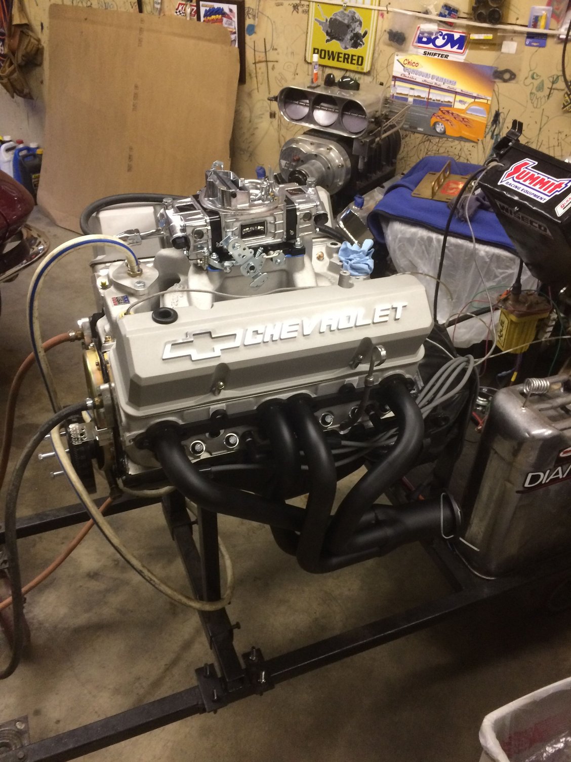

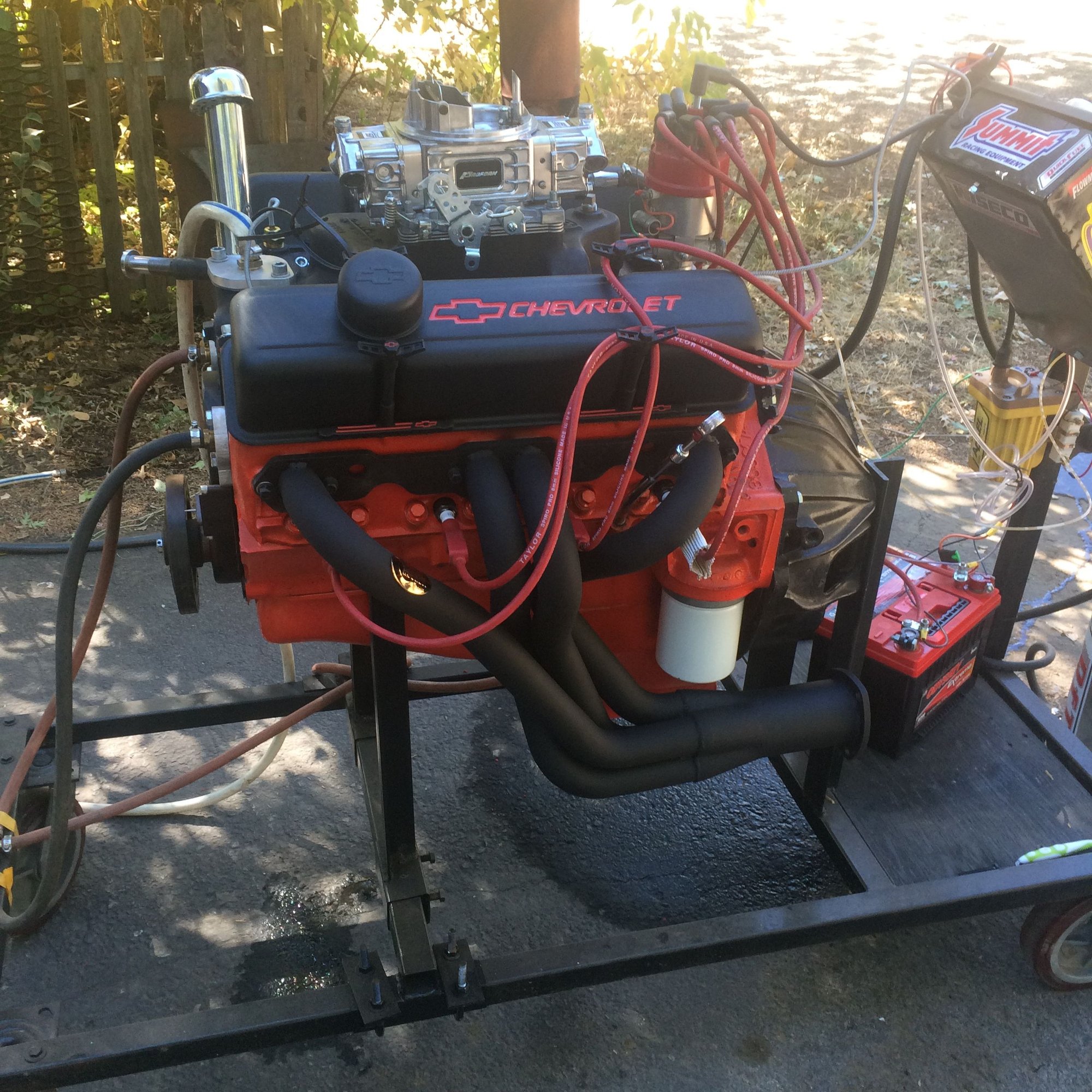

These Summit brand are the cheapest of the two and fit the best the bottom one's are hookers they fit good but a little close to oil filter. I would run the Summit top pic

Why 1 5/8 over 1 7/8? Try AR headers as well. They only list 68+ but the dimensions are the same C2 and C3.... and they come with slip fit connectors.
I would like to see each of those sets in the chassis too... They Summit ones look like they might interfere more with "stuff"

Thanks!!! Pics Very helpful!!!

I have the summit one's in my 64 best fit for any header in any car I have had headers on. Do not interfere with anything. The Hookers are in my 58 and fit nice.
