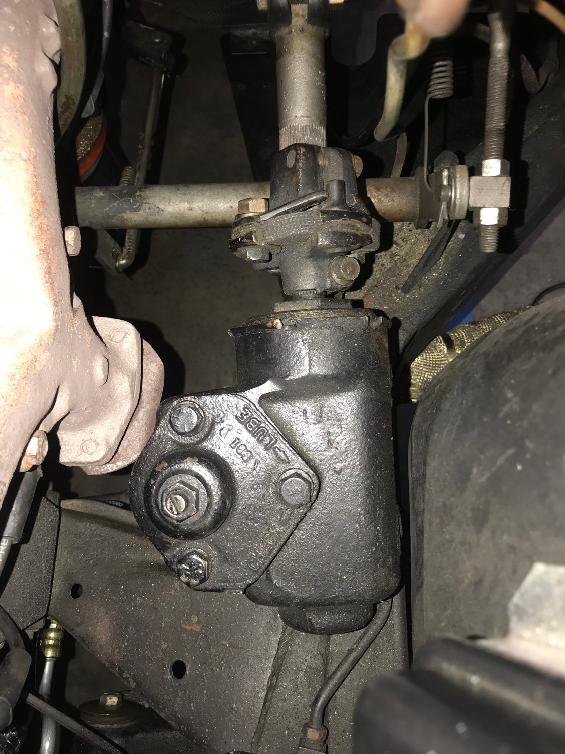

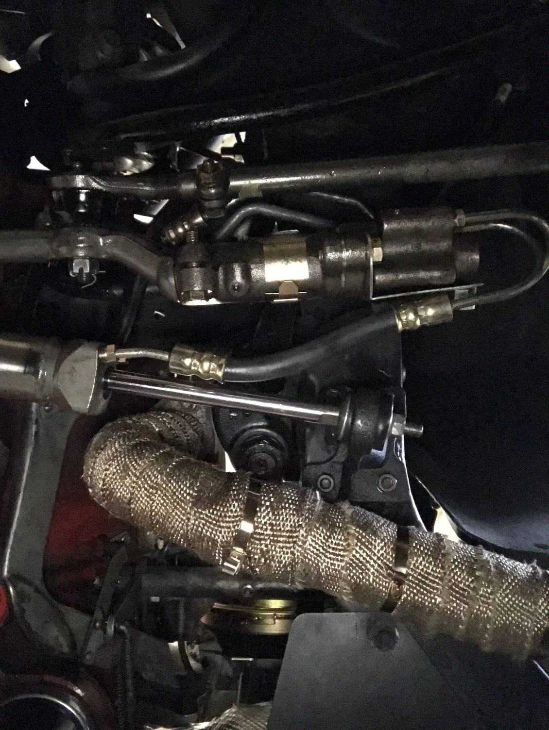

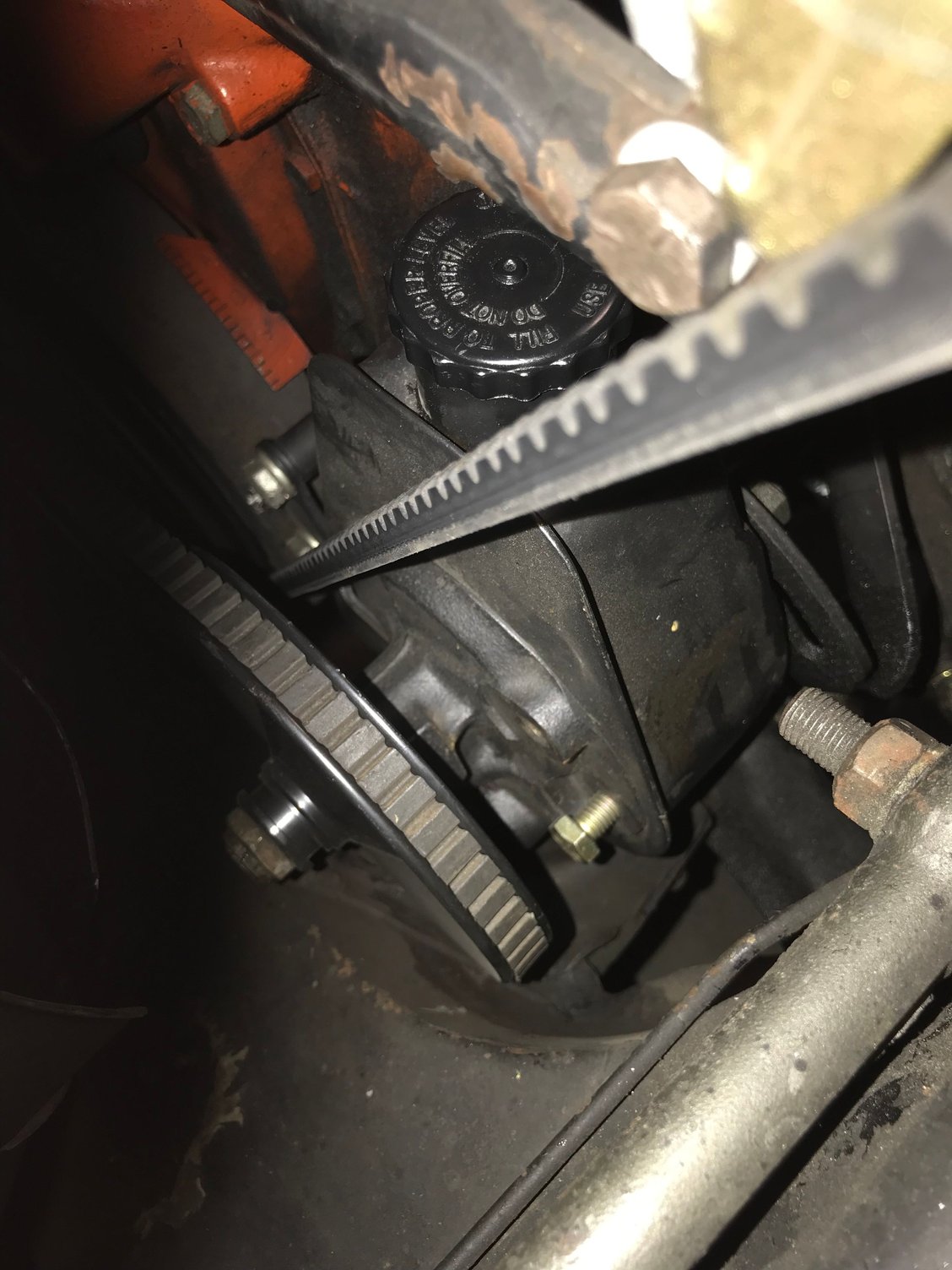

I need to replace my power steering hoses but I don’t know what hoses to order because I can’t figure out what aftermarket PS system my car has. I appreciate any help to ID this:

You have a factory style PS set up
Thanks, Keith. Looks like Ecklers has the correct hoses.

save your self a hassle and order them at your flaps. Your get the same part. Ask for gates hoses

Also make sure your hoses are SAE and your new hoses are SAE. I think later C3 PS system when to metric
Yep. Looks like the change was for the 1980 model year.
