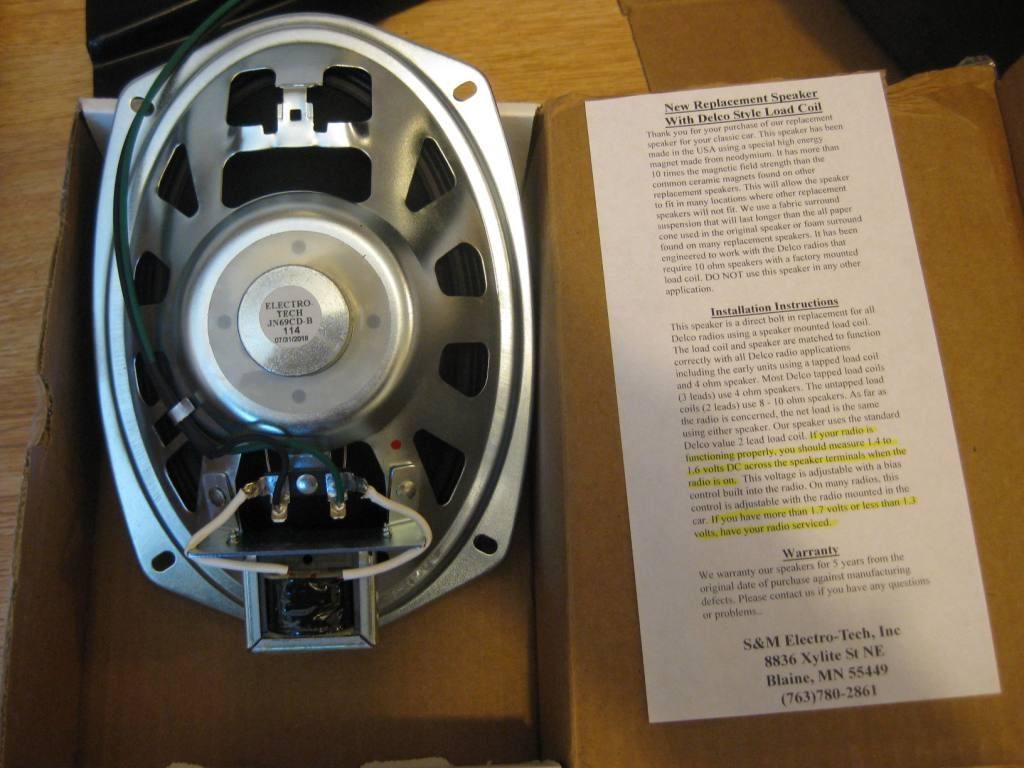

I'm not interested in putting a "system" in my car, but I am going to add a blue tooth receiver, retain the factory radio, and replace the factory dash speaker. My question is what is the highest quality replacement speaker that will fit in the factory opening? By highest quality, I mean provides the clearest sound, at the highest volume, with the least distortion. Obviously there is no "good" option for a single speaker audio system, I'm just trying to find the best of the available options.

For an original speaker ? This one and none other, start out about 2/3 of the way down the page and find out why:
http://www.turnswitch.com/speakers.htm

This one. 'Turnswitch' = 'Electro-Tech'.

The turnswitch speaker looks awesome!
