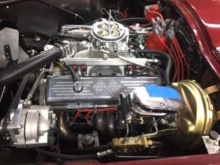

I saw that pic on Toddalins car with the billet alt bracket.
Who makes nice looking bracket for RH side mounting that works with SBC headers?
I am going to get rid of the tach drive alternator on my car and just hook the (new) tach cable to my Accel dual sync dizzy shortly, and would like to replace the stamped steel, ugly, alternator lower bracket.

Changing my thinking a little bit,I now have Dart heads with front mount holes, instead of the old 461/462 heads I had years ago.
Anybody familiar with a mount like this? I need the alternator in the stock (generator) location for hood and fresh air vent clearance. I am using a 12SI alternator.

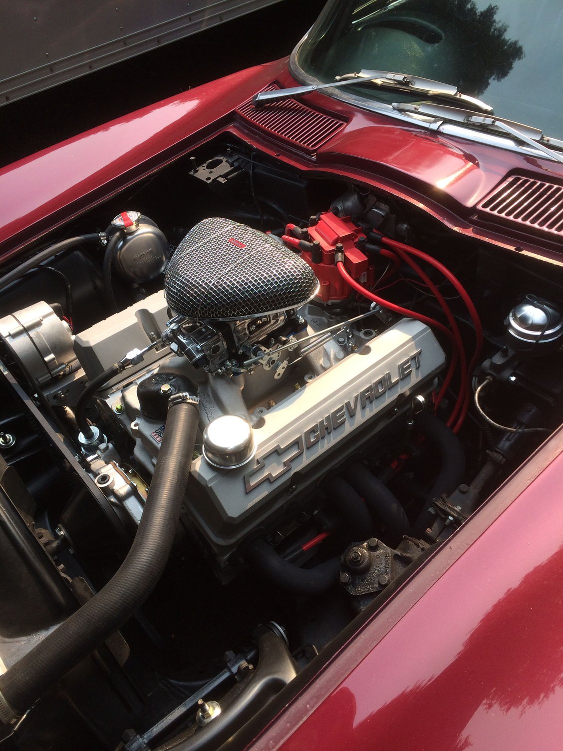

I am using one very similar, although left side, also have Dart heads. It is a March setup, with serpentine dive. You won't be disappointed if you go that route.Not a very good pic to see it though.
