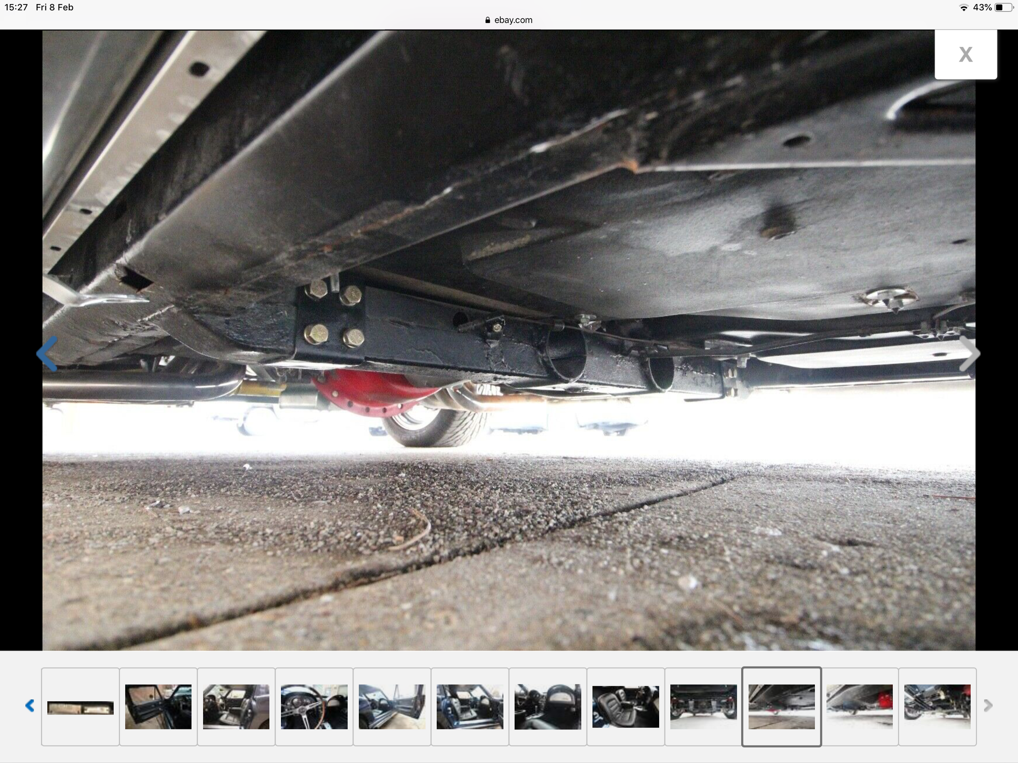

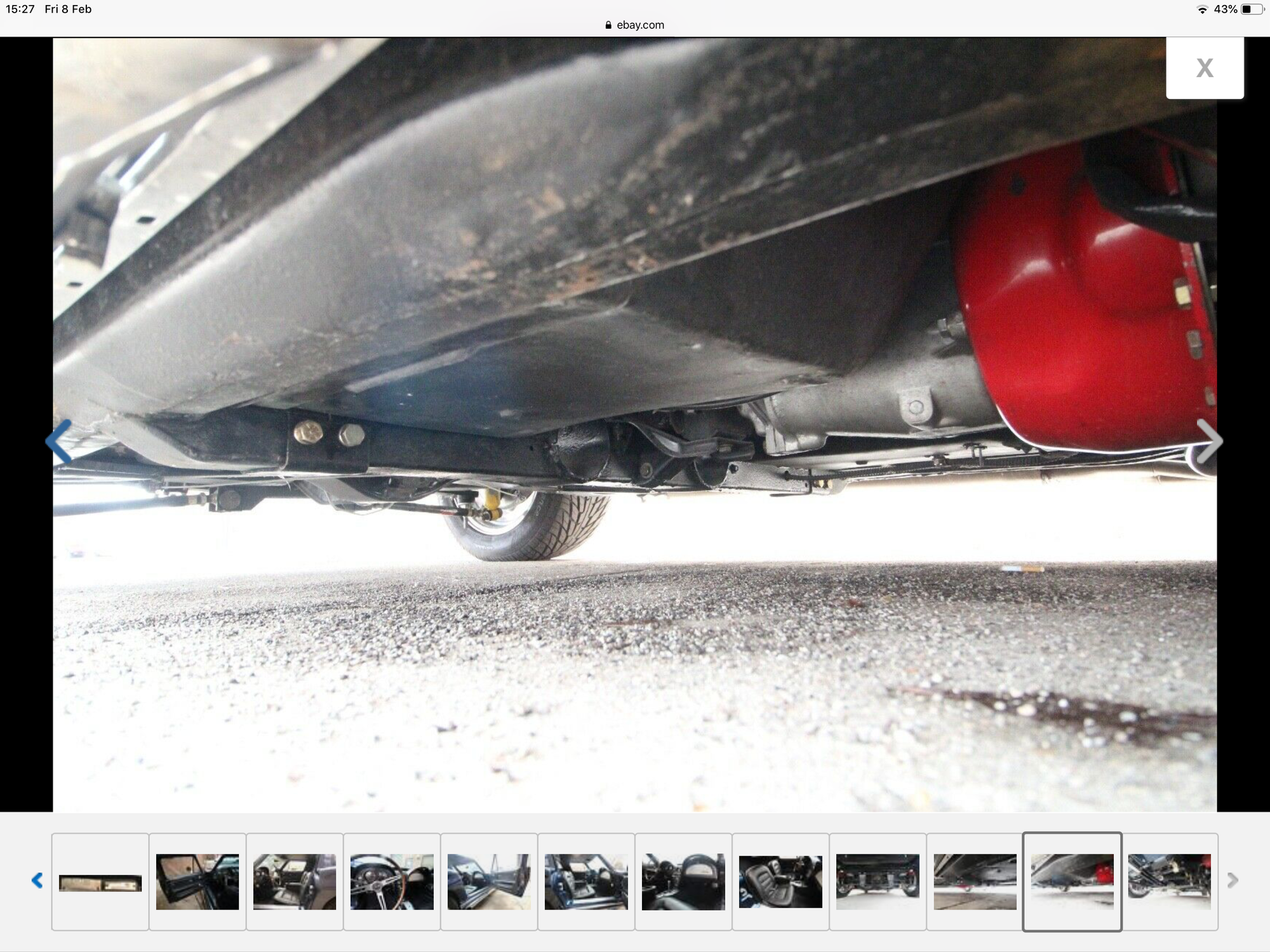

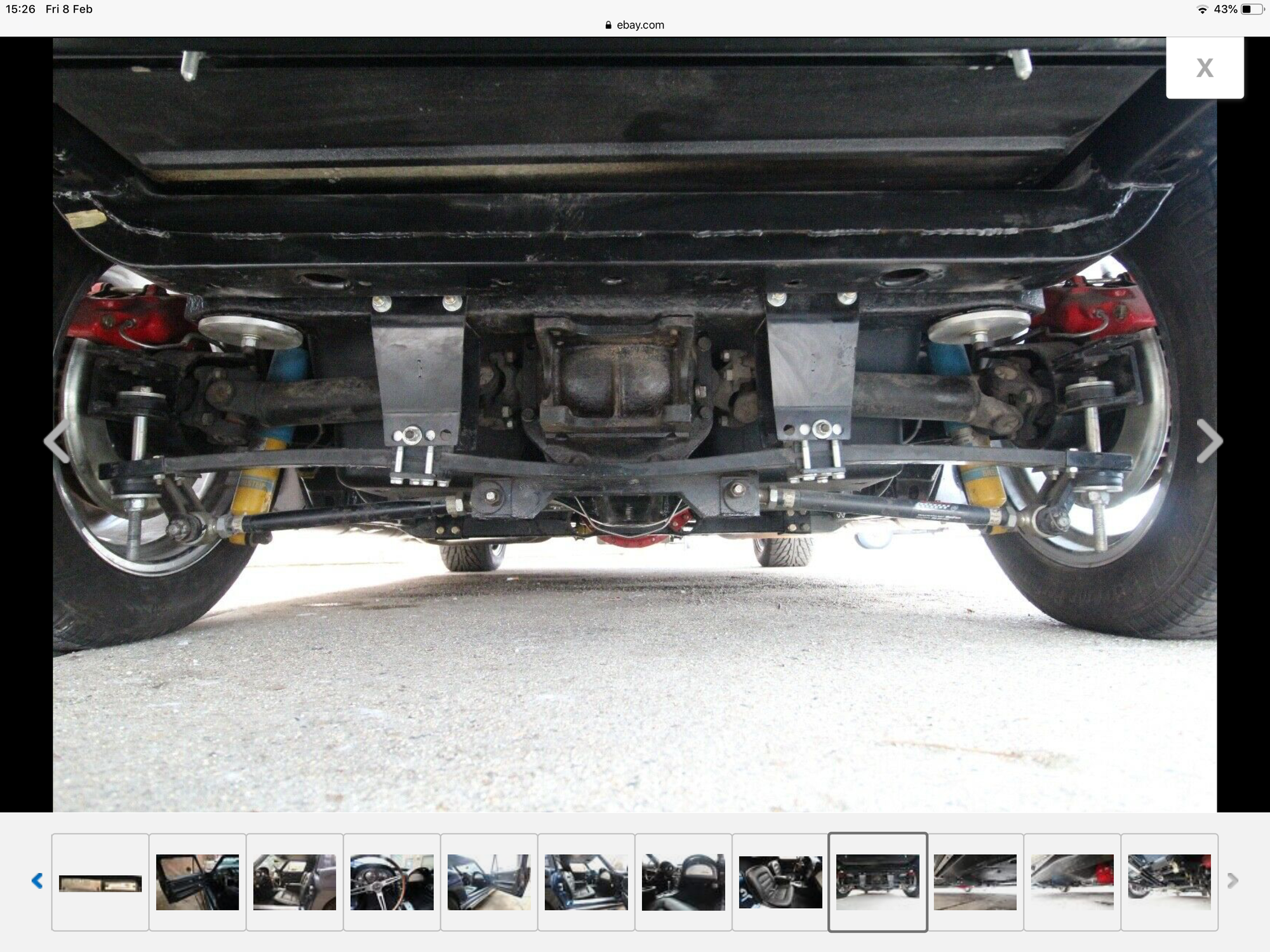

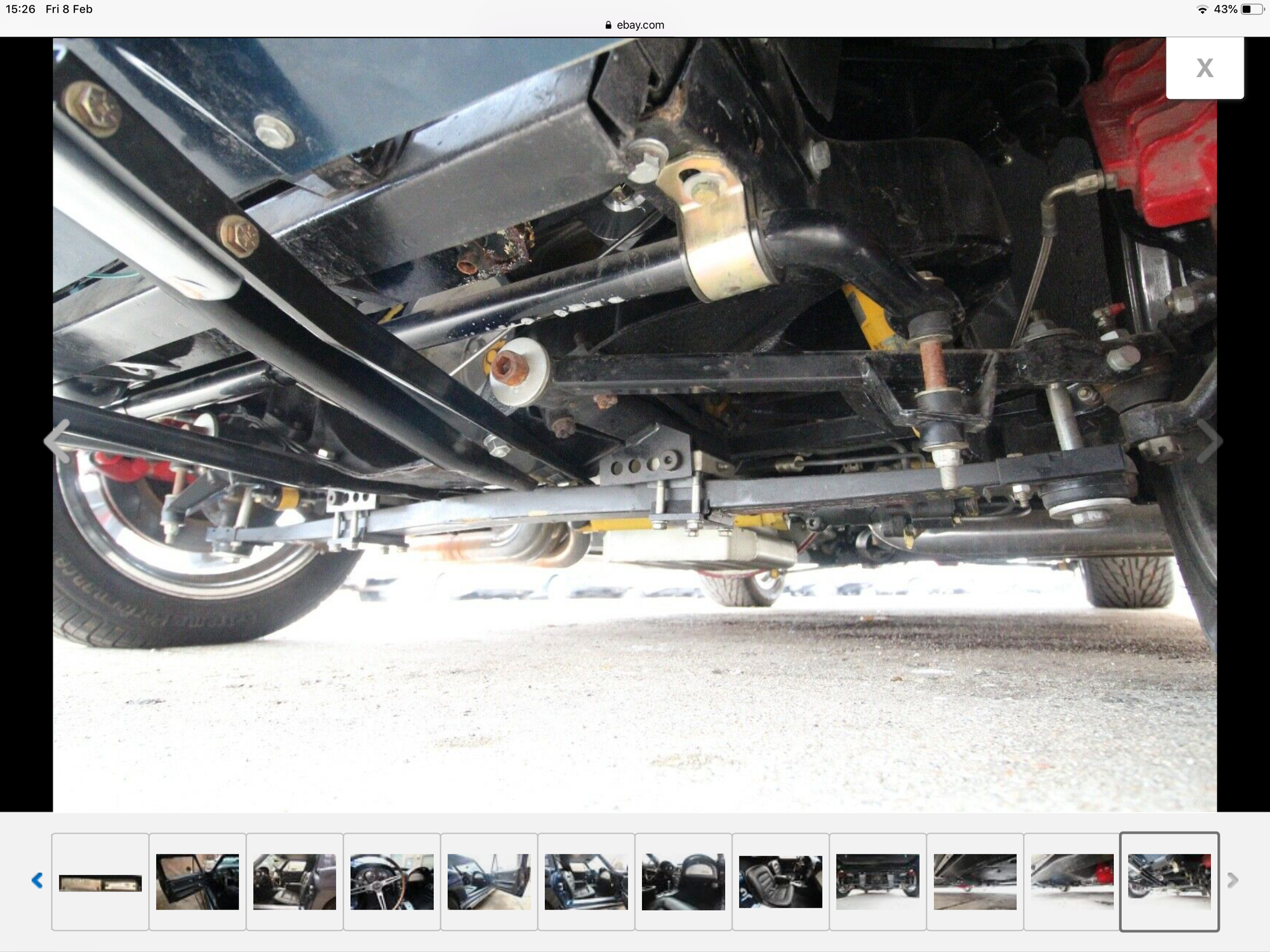

Hi all I am a new UK member looking to buy a nice C2 Coupe
I have found one that would suit but am unsure of the suspension set up, can anyone help with the type under below
I am already on a 1966 C2 in Chicago- its a restomod and although I would prefer an original, the mods on the car would make it a good driver.
I am a bit worried about the suspension setup, its got a “performance11 road set up” I cannot find anything about this, but from what I see its a rear Mono leaf but its attached to the rear cross member on brackets not from the rear diff???? It has rose jointed sway bars and Bilstein shocks-
The front has also been modified with a Mono leaf and Bilstien shocks
I dont want a car that drives hard as rocks I want a good usable car!! Any thoughts on the suspension, anyone heard of this ??
Also the car has a 454 motor AC, P/S, P/B and is fitted with C5 rotors and discs
Thanks guys in advance Adrian

Old Feb 8, 2019 | 10:47 AM
Adriana1's Avatar
Adriana1
Joined: Feb 2019
Posts: 24
Rear suspension
Front set up again with mono spring
Front mounting brackets
Front mounting
Old Feb 8, 2019 | 10:50 AM
Bluestripe67's Avatar
Bluestripe67
Active Streak: 90 Days
Joined: Jan 2002
Posts: 15,354
Likes: 2,726
From: Close to DC
I don't envy you. Your an ocean away from a car of interest, and can't lay a hand or eye on it. The one you describe sounds like it has been built with a system that Vette Brakes & Suspension made, but has now gone out of business. What you describe, would not appeal to me, but that's me. If you find another car that is more worthy of inspection, you should hire a compotent C-2 person to inspect it. Dennis
Just saw the pics. It does look like the VB&S system. I also see a bell housing/blowshield, a removable crossmember, possible aftermarket brake calipers.

Old Feb 8, 2019 | 12:14 PM
kellsdad's Avatar
kellsdad
Joined: May 2001
Posts: 2,749
Likes: 776
From: Dadeville AL
Adrian,
I have what appears to be the same suspension setup in my 1963 Corvette. I installed it around 2002. It doesn't ride dramatically different from stock, and can be put back to stock for the cost of replacement parts. The biggest problem has been that Vette Brakes and Products (VBP) went out of business making it challenging to get replacement parts, mostly polyurethane bushings that fail after a while. Quite a few folks here on this forum have faced that issue and found ways to keep it working. The biggest advantage for the VBP system is adjustability. If the current owner has it well sorted out, it should be fine for a weekend driver. ... I have no experience with the C5 brake conversion.
Old Feb 8, 2019 | 12:18 PM
Mike (Naples)'s Avatar
Mike (Naples)
Joined: Dec 2007
Posts: 94
Likes: 26
From: Bonita Springs FL
I can't see all the pics you loaded, but that car appears to have most the components of what VB&P sold as the Performance Plus package That package, which sold for around $3k, included a rear anti-sway bar that apparently was not mounted. I installed that package on my SWC four or five years ago but replaced it last year with a Ridetech coilover package. The ride was stiff but okay. The reason I replaced it was the geometry didn't work well with my Steeroids rack & pinion conversion (I've since removed that as well and gone with a Borgeson box.).
The stiffness of the suspension is adjustable among 4 settings. That car is on the stiffest setting at the front and second stiffest at the rear. Personally, I found the Bilstein shocks a poor match for the springs, but that's just my opinion.
The problem you'll have is that each spring is held in place by 2 brackets, both of which sandwich the spring between poly bushings. Those bushings seem to have a life of only 4 or 5 years (at least in Florida) before they disintegrate and, with VB&P out of business, you can't source replacements. You could probably fashion replacements out of other bushings, but you'll definitely need to have something planned.

I believe that is the biggest front sway bar I've ever seen on a street driven car
