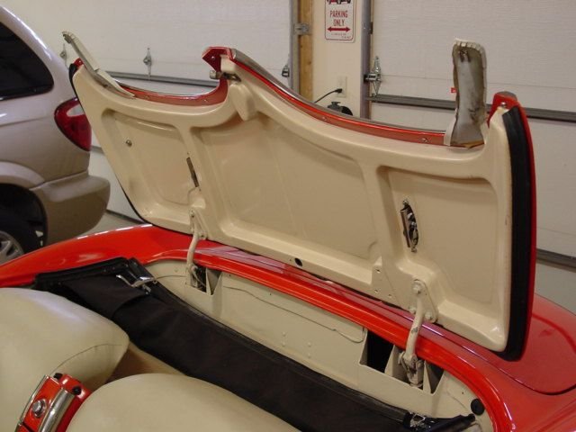

Can someone that has a 58 or similar Vette give me some measurements please?
I've bought a soft top for my car and I have to install the clamps on the rear deck lid. Frame is installed but I'm not sure where to cut in the rear clamps.
Really don't want to screw this up!
I need the measurements etc. Pictures would be awesome too.
Photo below is a '57, but it's similar. Blow up the photo and note that the "double-keyhole" opening for each rear bow clamp is already in the soft top lid inner panel - you just have to add the hole in the outer panel. There are several trial-and-error ways to do that, and they involve having the top frame in place and properly adjusted.

My 62 hardtop only car had the captured nuts in the rear bulkhead for the triangle plates for the softop, BUT, they were filled from the factory with some sort of filler and painted body color which made finding them a bit of a chore. Once I found the filled holes, using the triangle plate as a template, it was simply a matter of drilling out and chasing the captured nut threads in the panel. Same as JohnZ says of the ragtop key holes in the compartment cover. Use pilot holes from the under side and gradually open the top panel to match. Interesting job.

Thanks guys, think I'll start to the project today.
