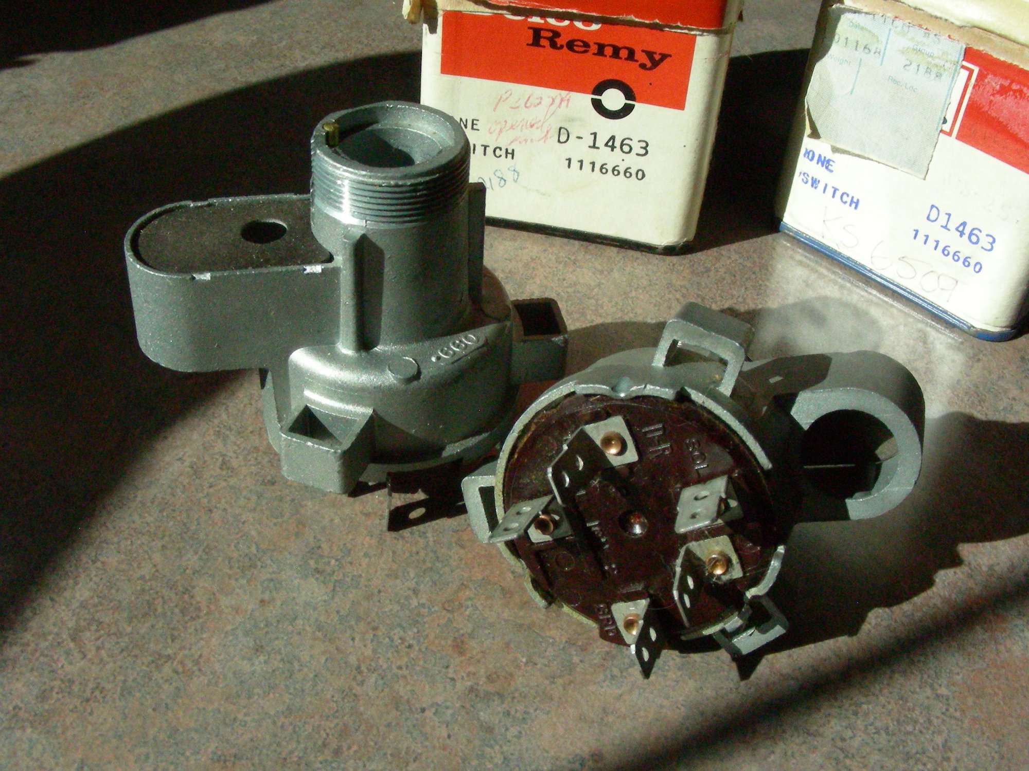

Here's what was installed originally in a '65. The "660" is cast in the body. It takes a unique (tumbler ?) [the part the key goes into].
I have 3 of these; also an NOS "659" which I think is full-size Pontiac ; 1965 only.
