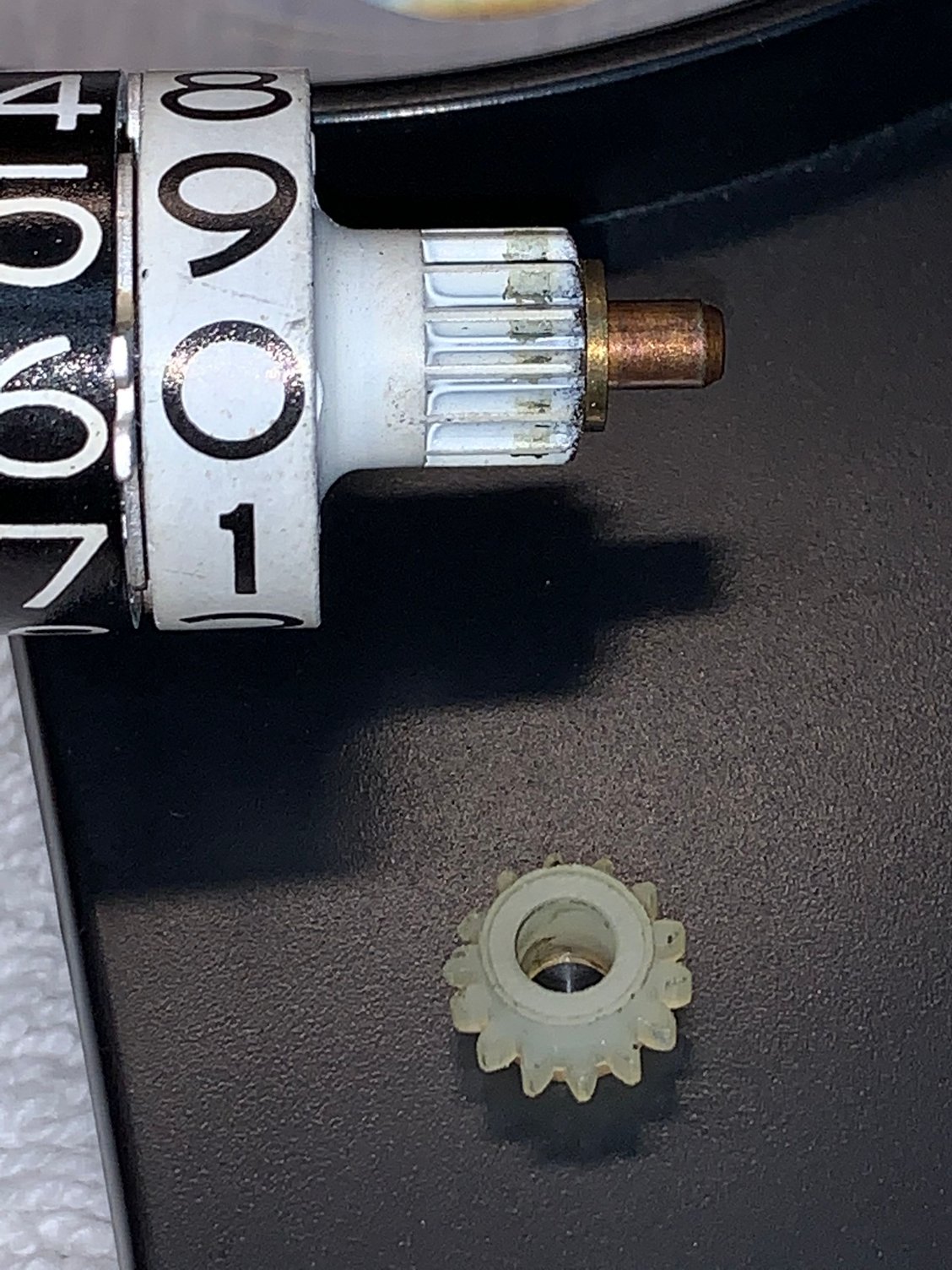

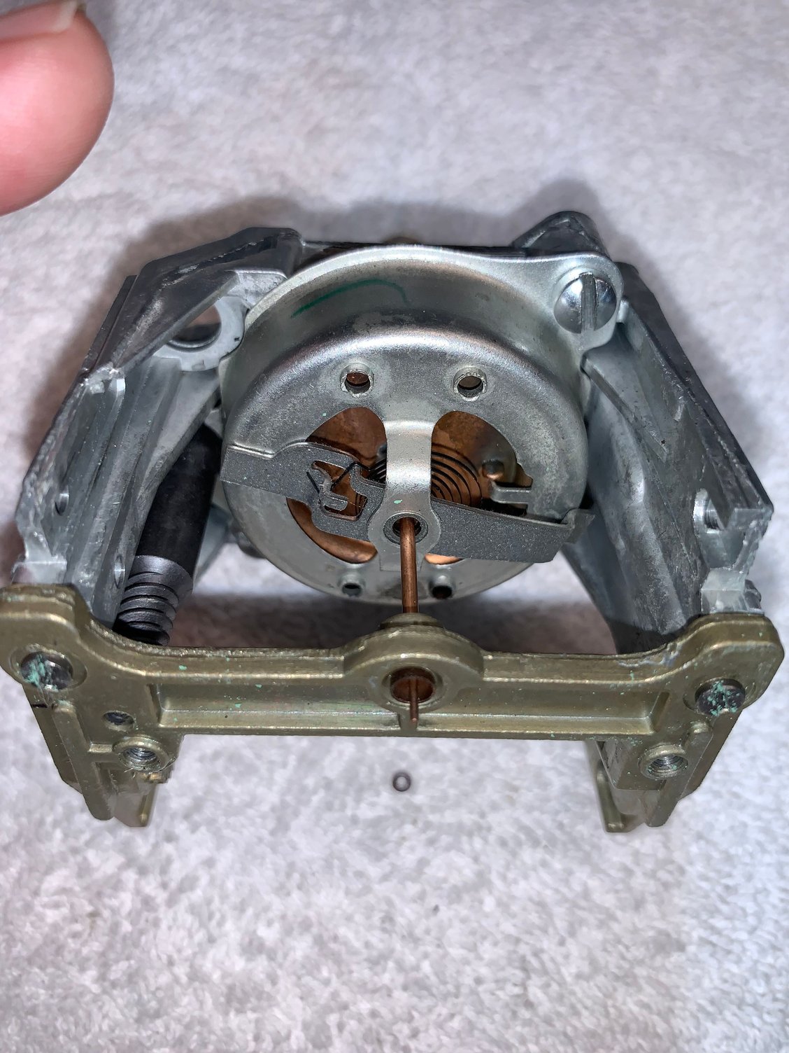

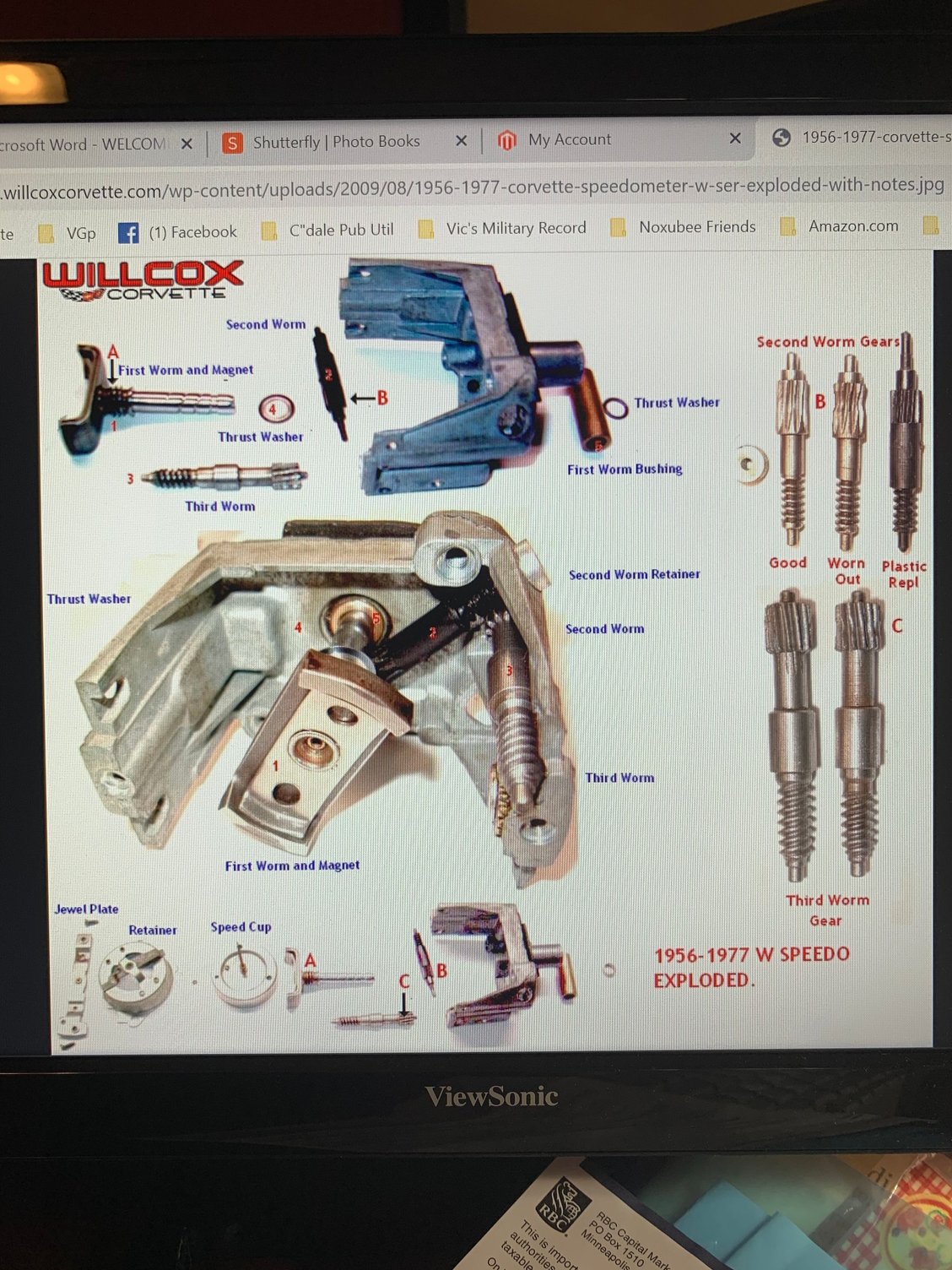

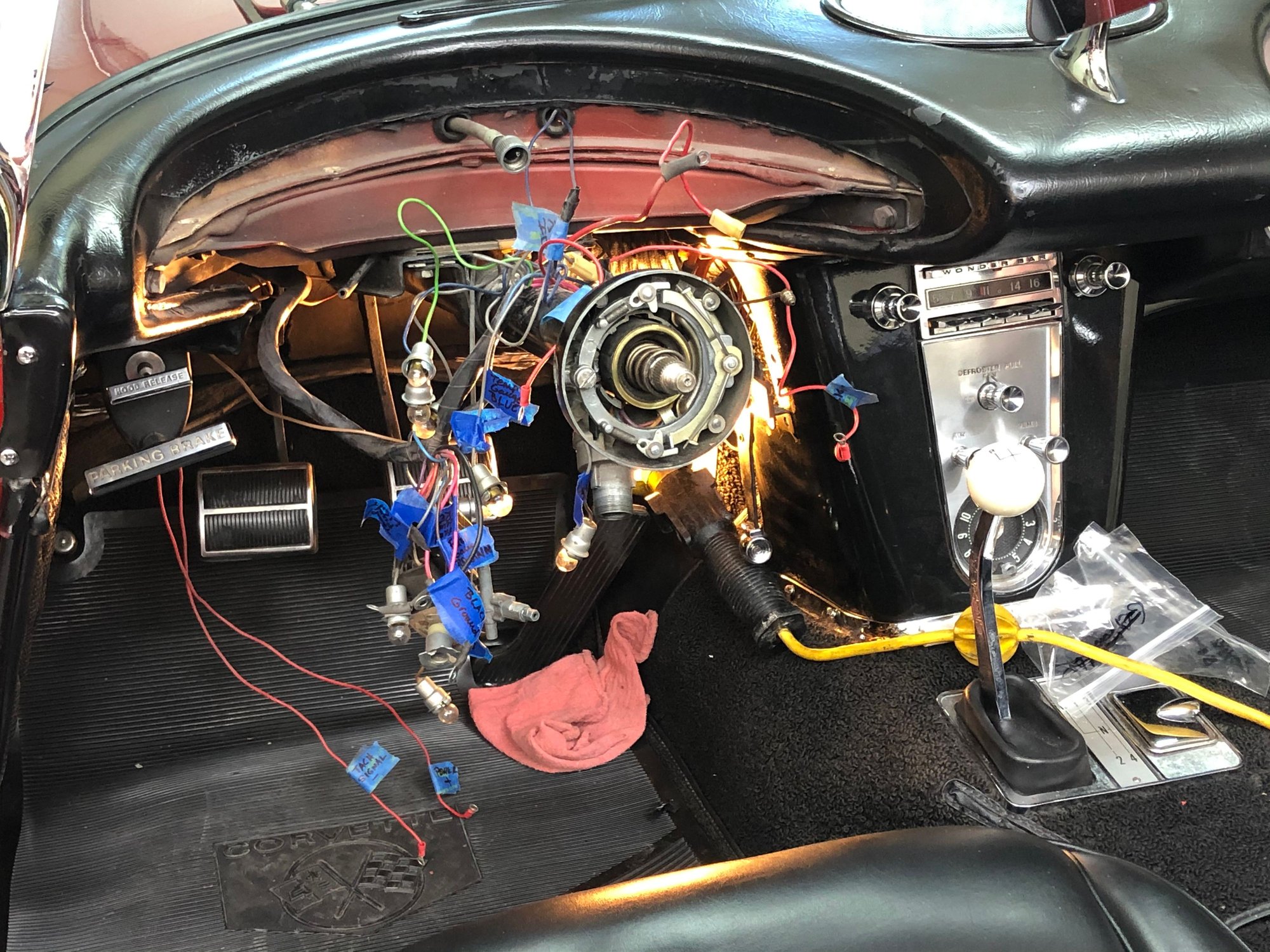

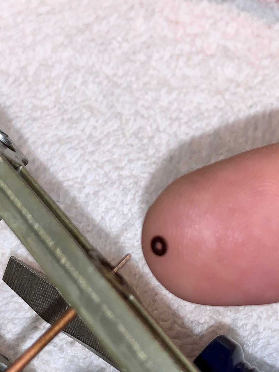

I just overhauled my speedometer and Only tried it because because one of the well known speedometer guys wouldn’t sell me a part because he said “you can’t fix it”. I’d never taken the cluster out and had only a casual idea about how the speedometer works. I found an instrument source (D&M Restoration in Greenville, SC. No association other than this purchase) and they helped me understand the workings of the speedometer and sold me the $12 buck part to make it work. It now does. Wilcox website also has a good instructional video. All of the pro’s were quoting pretty high prices, $6-7 hundred or so. Point is if I can do this, I can absolutely guarantee most anyone can. Use the information that’s out there and find a good supplier go slow and take a lot of pictures. I also used the SuperBright website to buy LEDs for all lights (‘62) No fitment issues. Frankie and others have great instructions on cluster removal. Be sure and tag all wires and label all posts (you don’t really want to depend upon the wiring diagram in S-12). Grease the cable, no grease in speedometer, while working and add the breaker on the ammeter. Protect the dash pad when moving the cluster. There is a very small bushing on the speedometer. None of the posts mention it and it will fall out. Now, if you have to replace the first worm gear, it has magnets that come unmagnetized. You’ll probably Need help with that. Calibrate 60 mph at 1000 rpms. I promise, details on the job are available on-line. Jim
