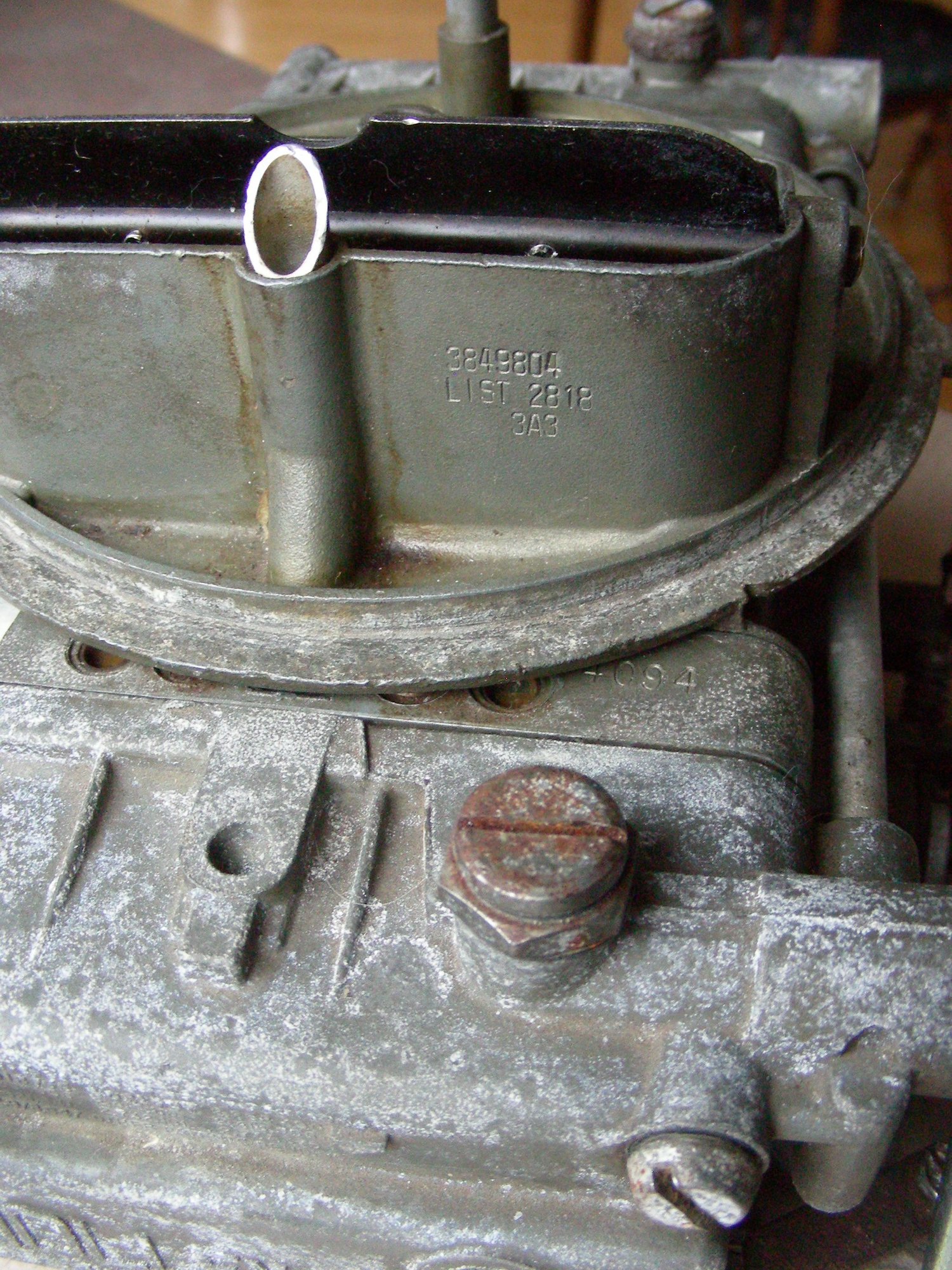

Here's one I have that is more "olive" in shade. Probably off an early '64 L76.
List 2818 (no dash -1); 3A3 1963, November, 3rd week.

That would be a perfect 2818 carb for my 64-365 engine built 12-21-63, car built on Jan 12th 64!!!
Mine has a 2818-1, & I say I am a guy that will never have the car judged, but...
if you want to sell that one, PM me.
