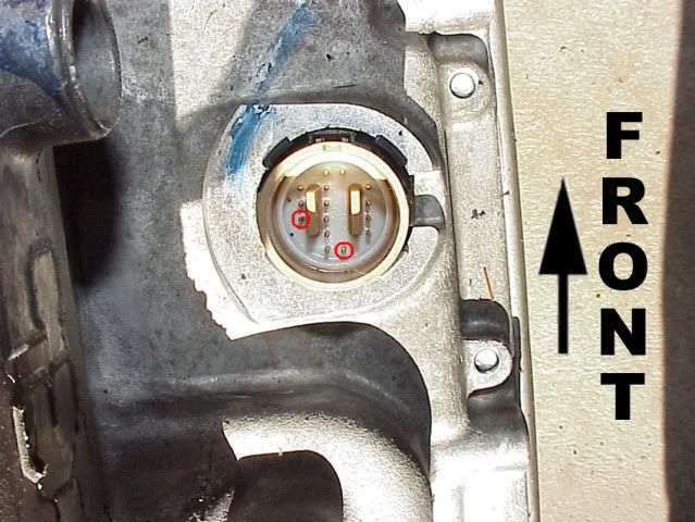

That engine I believe is a 58 reluctor one, and had 4/8 cylinder firing, running on 4 cyl's light load / 8 under heavy load/acceleration.
If I remember correctly, 4L60's electronic/wire harness plug in trans needs to be modified to 4L65 one. Been 9 years since I had to look into this, and that was with LS3 58 reluctor engine.
My guess is if the plug in trans does not have the 2 pins circled in red in it, it want work with the engines electronics, might not be able to convert plug.
Might call RPM transmissions an ask them about subject. Also may need to have company like Speartech make you a engine/transmission wire harness for conversion.
