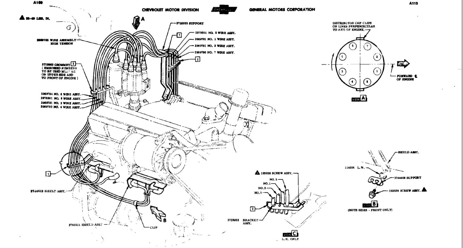

How are plug wires routed on 60 corvette

Seriously - get yourself an Assembly Instruction Manual from any of the vendor web sites:
If you buy correct rubber wire looms they will have numbers over each hole corresponding to the plug wire. The oil pan wire clips are counter-intuitive, they are mounted so the wire snaps in from the bottom.

60 plug wires
