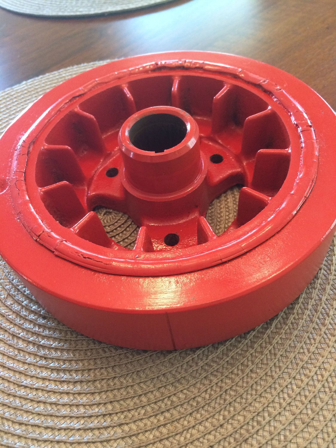

Easy Rhino's Avatar
Easy Rhino
Joined: Apr 2008
Posts: 31,785
Likes: 2,395
From: Middle TN by way of KY, OH, VA, IL, CA, FL, NY, SC, HI
This One (well, maybe a better-looking version of this one). It weighs around ten pounds or so.
