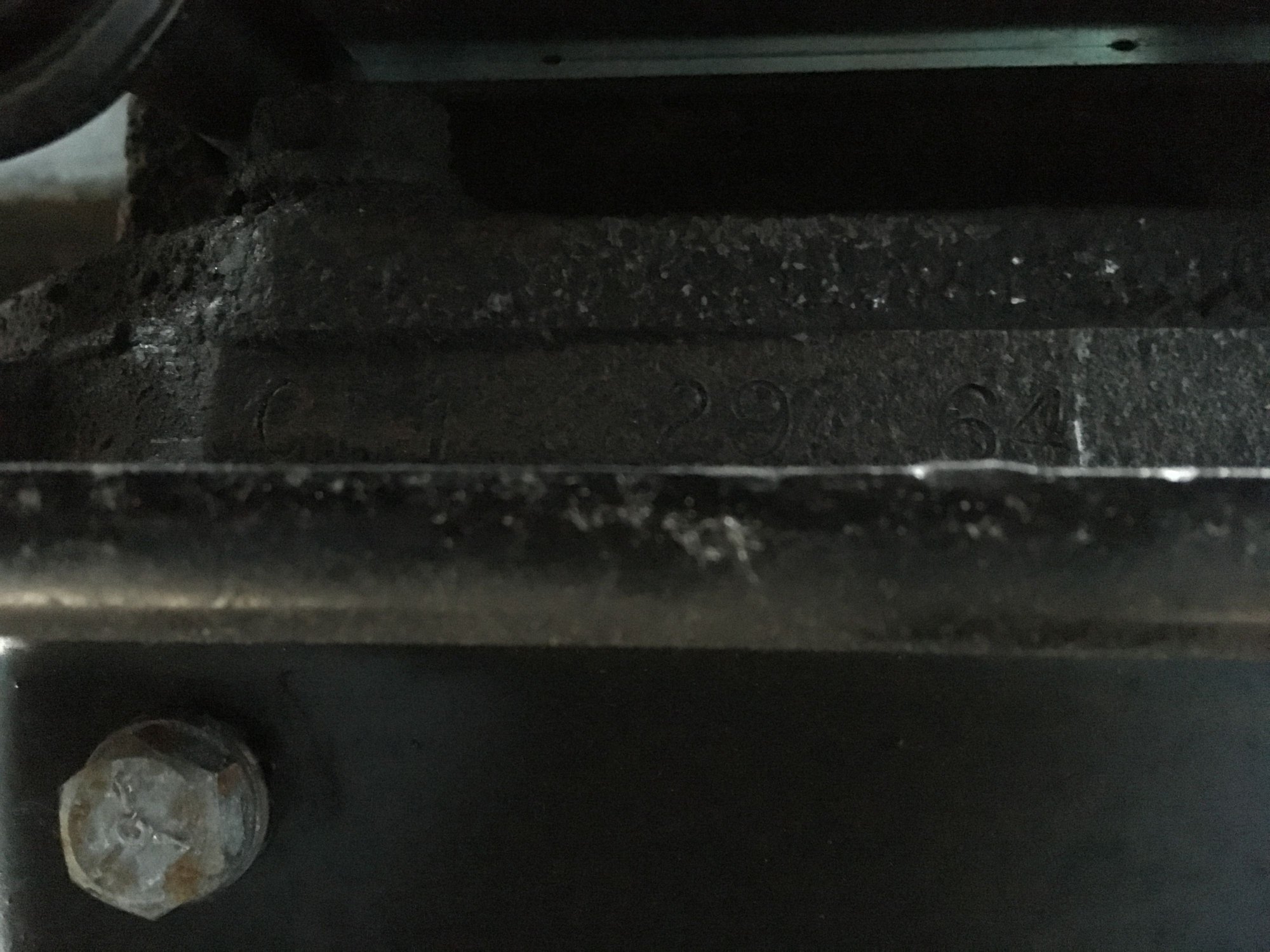

While we're on this subject, I've always wondered what can be surmised by the number on the rear differential. I did the old rotate the wheel and count the drive shaft rotations and believe I've got a 3.35 ratio. The number that's on the differential is 3830303. Does that suggest something else?
Rick
Rick
Rick:
That sounds like the casting/part number for the differential case. Your ratio is likely 3.36 and this is shown by the first two letters stamped into the rear carrier cover. From JohnZ pic these numbers are "AM". For a 1967 car (which this is) AM = 3.36 posi-traction for a small block engine.
Larry

Originally Posted by Powershift
Rick:
Larry
Larry, thanks for the info. Mine looks to read "GM 3". What would that suggest?
You are looking in the wrong location..........keep looking.
GM3 is a mold or pattern number for the mold used for casting your differential case or cover. I can't tell you whether case or cover without a pic.
Larry
Larry
It's barely legible, but readable part looks like "C(maybe M) 29 64" but can't be sure.

CA = 3.36 std axle
CB = 3.36 posi
CC = 3.55 posi
CD = 3.70 posi
CE = 4.11 posi
CF = 4.56 posi
CJ = 3.08 posi
CZ = 3.08 std axle
CX = 3.70 std axle
That's all there is.............
Pick one. Based on what you said earlier, CB is the likely choice. Count driveshaft revs again for one tire rev. If both wheels move together it is a posi.
Larry
EDIT: The 2 9 64 is February 9, 1964. This is the day your differential was made.
