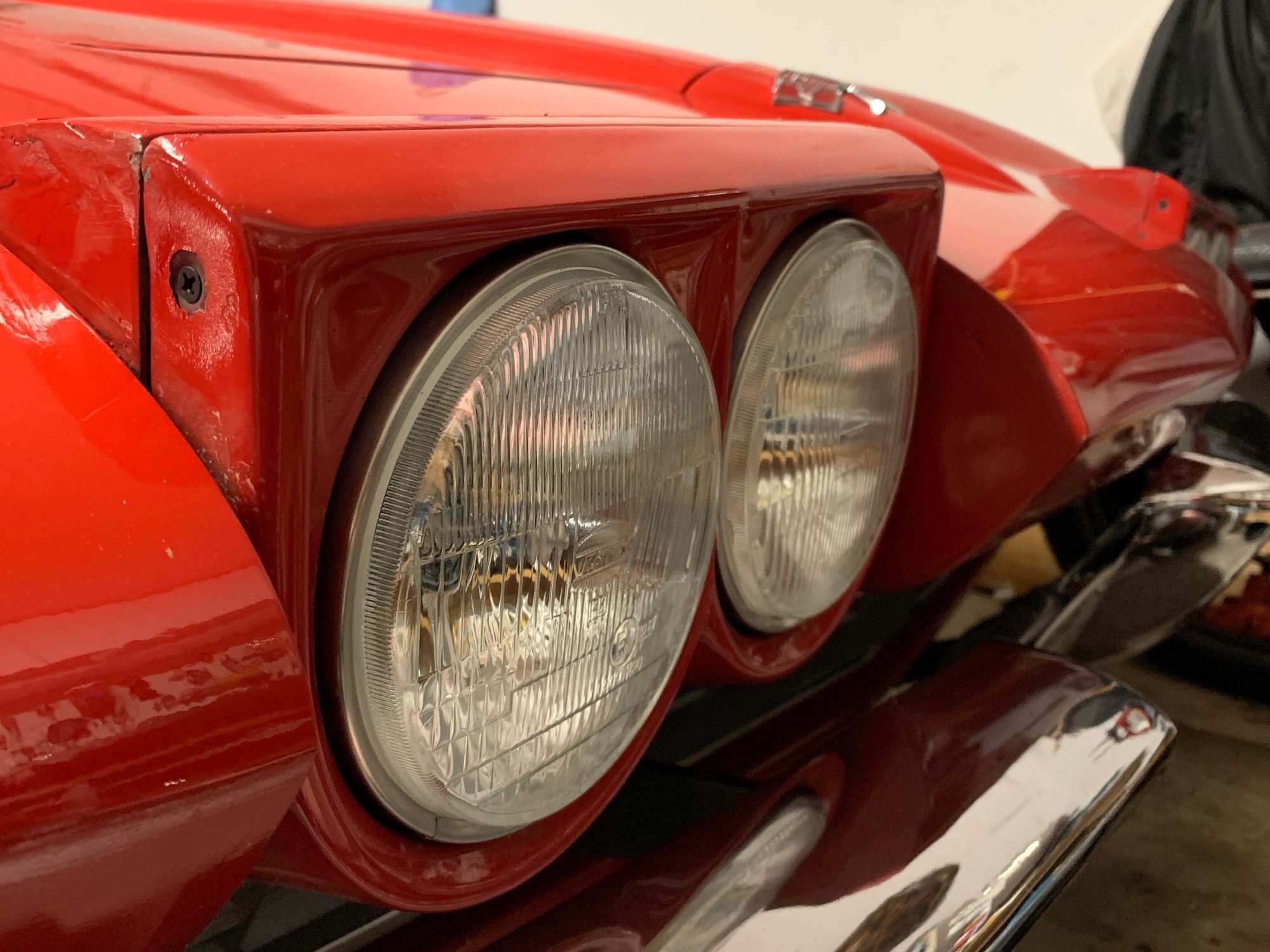

Last March I contacted Daniel Stern Lighting and he recommenced the Koito housings with GE Megalight Ultra+120 halogen lamps. I'm very pleased with the upgrade as they seem to be at least twice as bright as h5001 and h5006 sealed beam bulbs they replaced. This combination also has a nice flat cutoff so drivers in oncoming traffic don't get blinded. Notice that face on both the high and low beams are a little flat. Compared to the Cali brand that do not match each other, one round face and the other is flat. Relays had been installed years ago.
