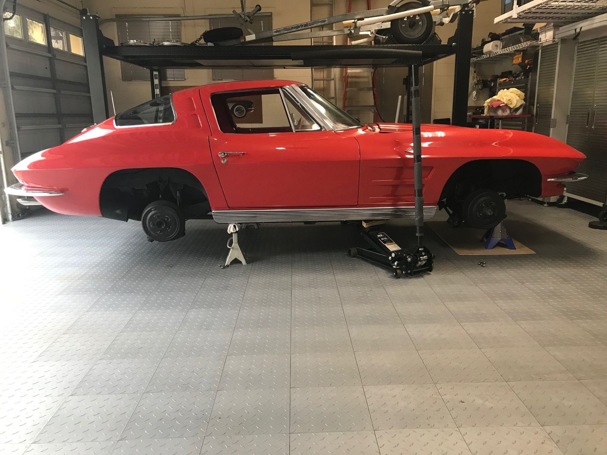

I don't think that's abnormal at all; especially in a convertible - your shop manual specifies lifting points depending on the method used:
Doors here open/close normally - but, its a coupe...

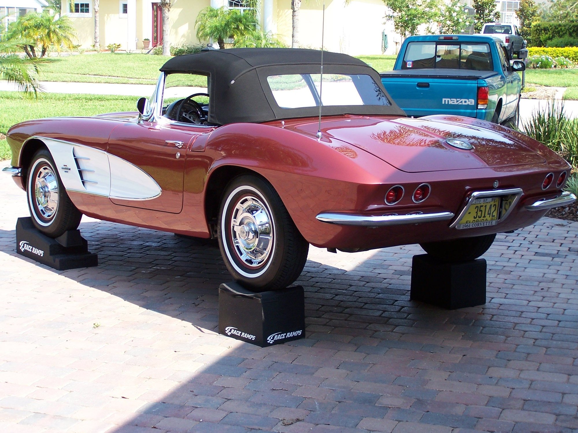

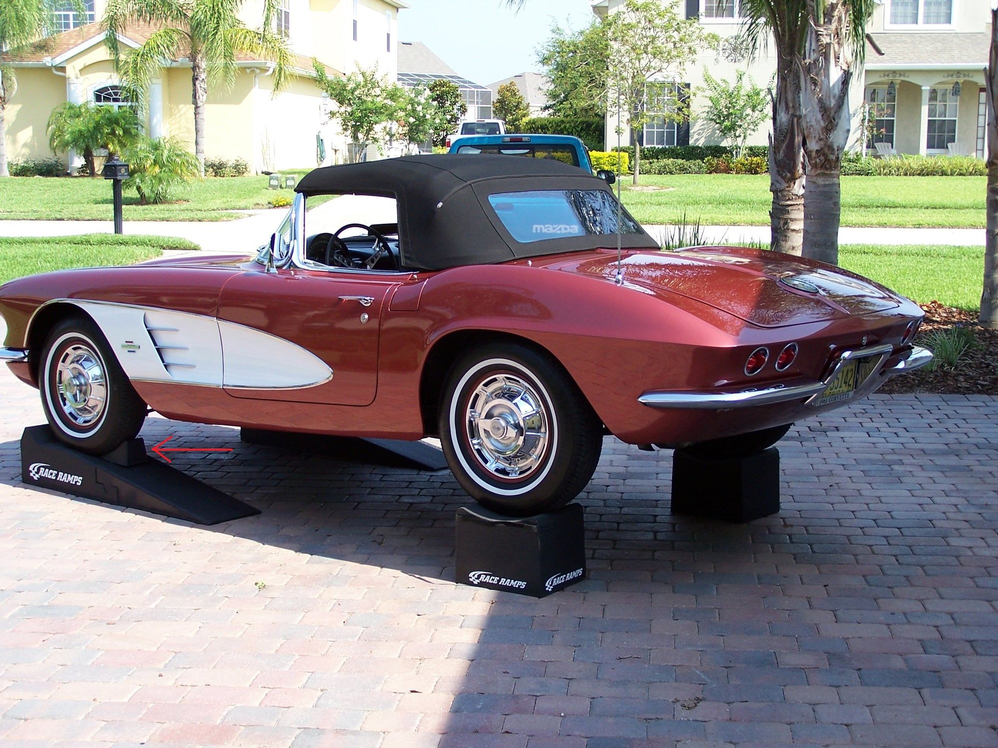

I think you’re talking about Race Ramps. I like them and use them all the time.
I have the 2-piece ramps that you can drive up on them and then remove the long ramp part so you have access under your car from the side. Then I jack up the rear of the car and place the Race Ramp “cradles” under the rear wheels. That gives me an additional 12” of working space under the car.
Steve
