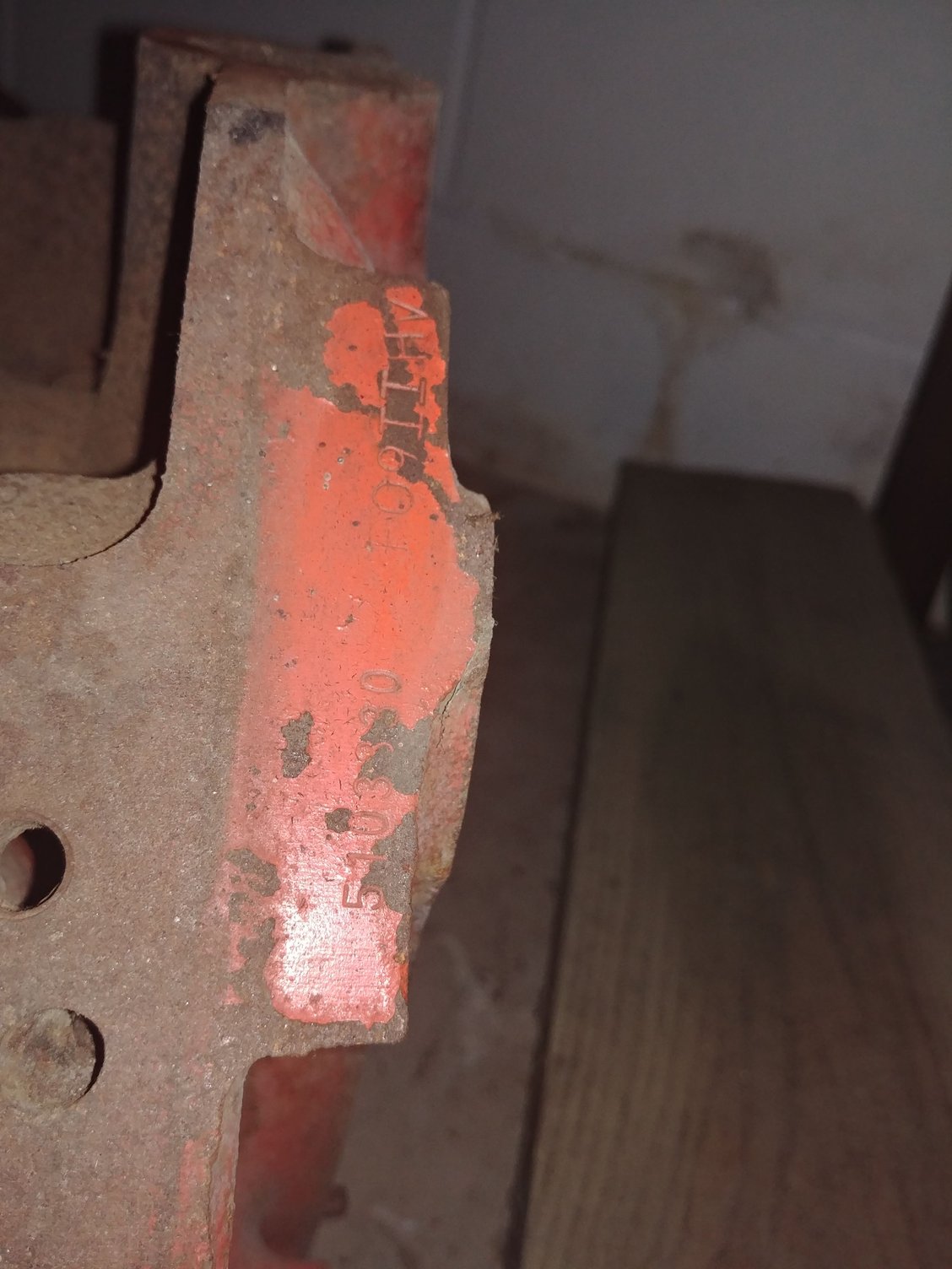

Hi all,
I misplaced my corvette numbers book, so taking the easy way out and asking you all for help. This block was in my Dads basement since the late 70s before transplanting to my basement where it still sits. I thought he said he pulled it out of a 65 coupe he had after it spun a rod bearing. Thanks for the help! Casting number is 3782870 which internet says works.

According to the Lime Book (sticky at top of this page) your engine is out of a 1965 Corvete 327 cubic inch, 350 HP, with 4 bbl carb, manual transmission and TI. Built Sept 11, 1964 for VIN #103330.

3782870 is a correct block casting number for blocks cast and used in Corvettes for model years 62-65 327s.
Your VIN derivative appears to be 5103330? That aligns with a 1965, with a VIN ending in 3330, or a car built in (TBD - I'll get back on this).
Your engine build date is F0911HV, which translates to built in Flint (consistent with all small block Corvettes), on September 11th, as an L79 (350hp) with 4 speed and transistorized ignition.
Problems are that the engine build stamp is not consistent with having been in a gang stamp, which raises questions as to authenticity, and the inability to see original broach marks due to paint and rust on the pad. These were not painted from Chevy, so the block has been worked on at some point. However, the VIN derivative looks consistent with other known originals, as do the characters on the build date stamping.
If the block has been in storage for 40 years, there is little chance of a forgery as no one would have likely forged a L79 block in 1979.
If I'm reading the VIN derivative right as 3330, the "born with" car was built on 30 November 1964, which is about 7 weeks after the engine build date - a little late but within NCRS allowances (and GM did not use first in-first out inventory practices at the time).
The fact that there is a VIN derivative and a build date with a HV code validates that it was a Corvette engine, as long as the stampings are authentic.
FWIW, the 1965 Corvette with a VIN ending in 3330 is not in the registry.

Originally Posted by leif.anderson93
According to the Lime Book (sticky at top of this page) your engine is out of a 1965 Corvete 327 cubic inch, 350 HP, with 4 bbl carb, manual transmission and TI. Built Sept 11, 1965 for VIN #103880.
Leif;
Your 3880 comment caused me to go back, copy and enlarge the pictures, as I have old eyes. I think it is 3330.

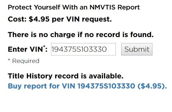

1965 coupe, VIN 194375S103330 exists in the NMVTIS database.
194375S103330 has a build date of approximately Nov 30, 1964.
An engine assembly date of Sep 11, 1964 is a stretch, but still within the realm of possibility.

Definitely looks like 103330.

Not to drift the OPs thread, but can anybody go to this site, load in a VIN and find a car's history?

Originally Posted by Easy Rhino
Leif;
After re-looking, I concur. Not the best of pictures from the OP.

Guys thanks for indulging my laziness. Getting pictures involved crawling under some shelving with a cellphone while doing a wife-mandated cleanout; apologies for the quality.
Mods feel free to move this to the orphan parts sticky. If someone has VIN 103330 feel free to send me a PM, and I can drag it out and get some better pictures. My Dad's still around and can give some history on the car.

OP, whatever you do, DO NOT scrape, wire brush, poke, scratch, sand blast, steel abraid etc the engine pad. Only lacquer thinner, rag, toothbrush and light oil.
Yes. Whoever pays the $4.95 fee can get the info. But all the info will contain is the state that the car is currently registered in (Privacy laws).
Here is the link to the site:
https://mvscusa.com/reports-2/nmvtis/
