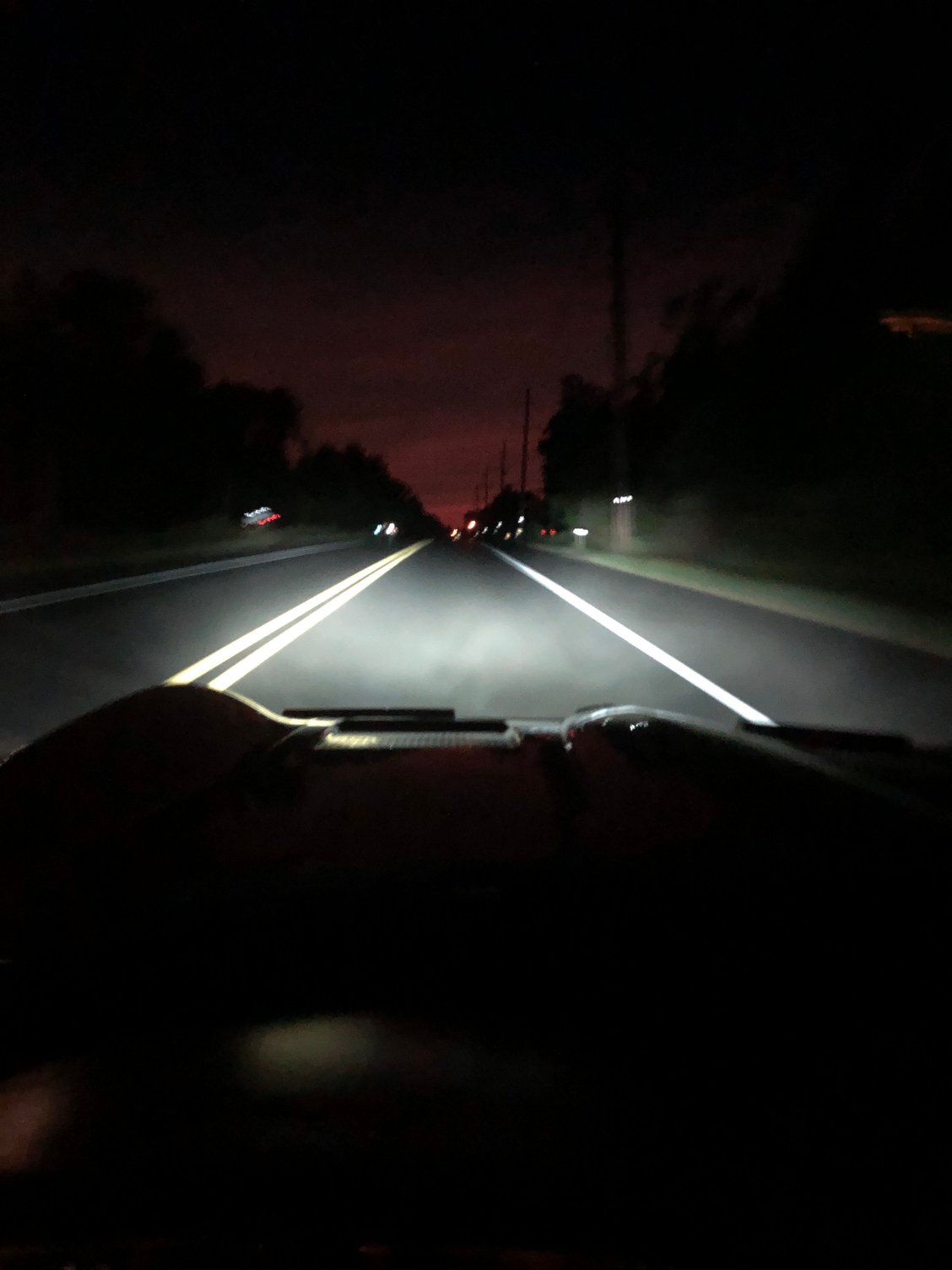

After hours of research I ended up buying these bulbs from headlightrevolution.com and hella H4 housings from Jegs. The H4 housings were far cheaper from Jegs then any other place at a bout $29 each. They are great quality and I highly recommend. The bulbs fit In the housings nicely and the buckets require no modification to work!
low beam
High Beam
The distance and spread of the beam is nice. It looks better while driving then in the picture.

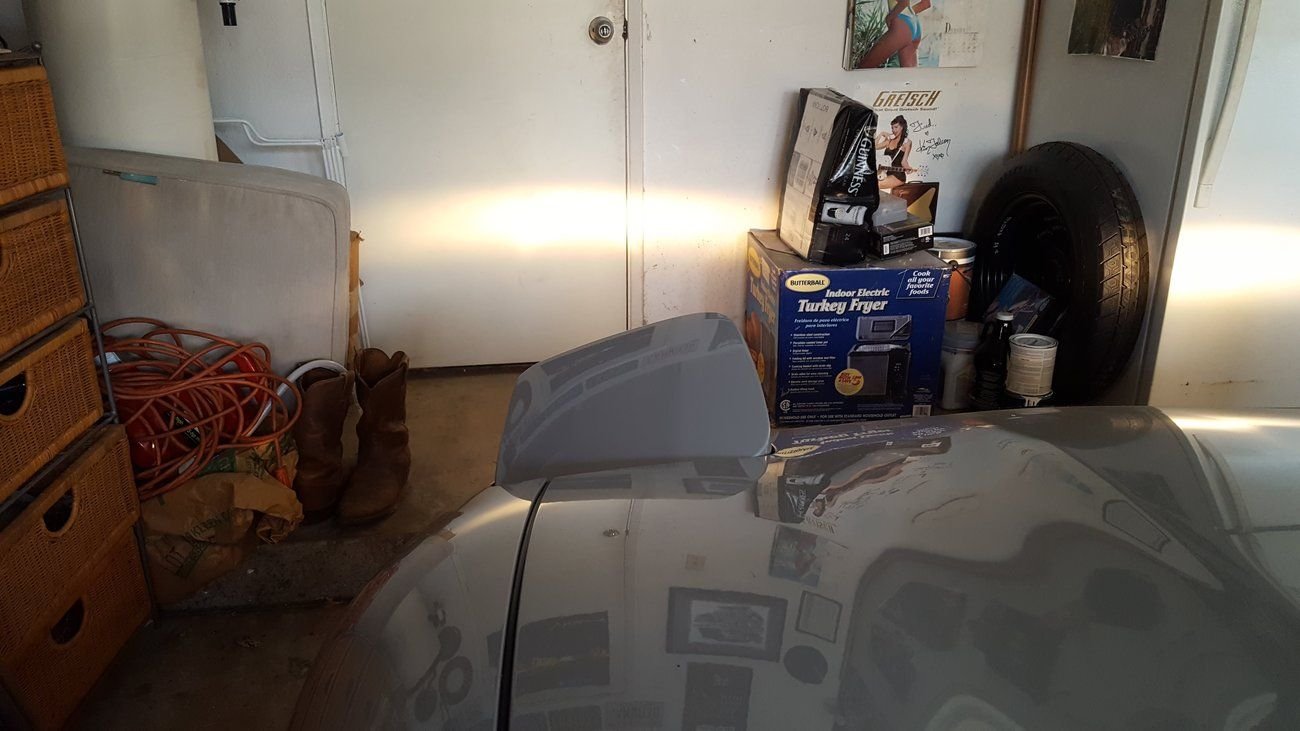

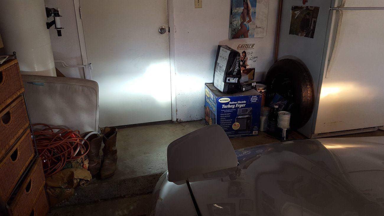

I tried module LED lights for my C5.. that plug into the existing housings.
While nice and bright, the dispersion pattern was altered.. shooting light too high and too wide.
This is because housings designed for a filament bulb will de-focus when you use an LED due to the geometry.
The light emits from a single point (or line) with a filament bulb.... LEDs do not.
Unless I'm missing something, I think you guys will have the same issue with these.
I took some photos of the problem... I'll try to find them.
EDIT: Here are the photos:
Standard bulb dispersion
LED module dispersion
This is my concern with add in LED bulbs.

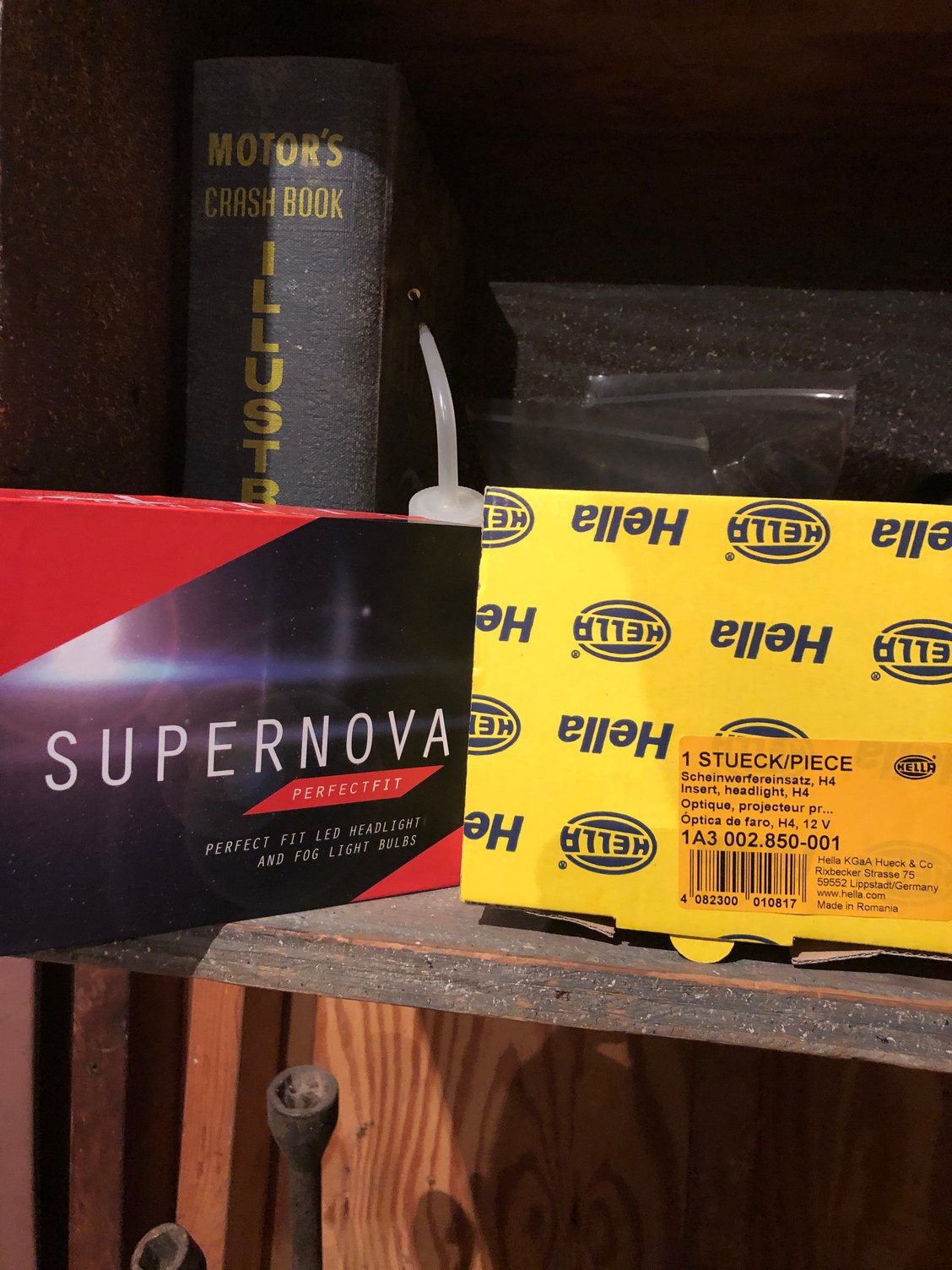

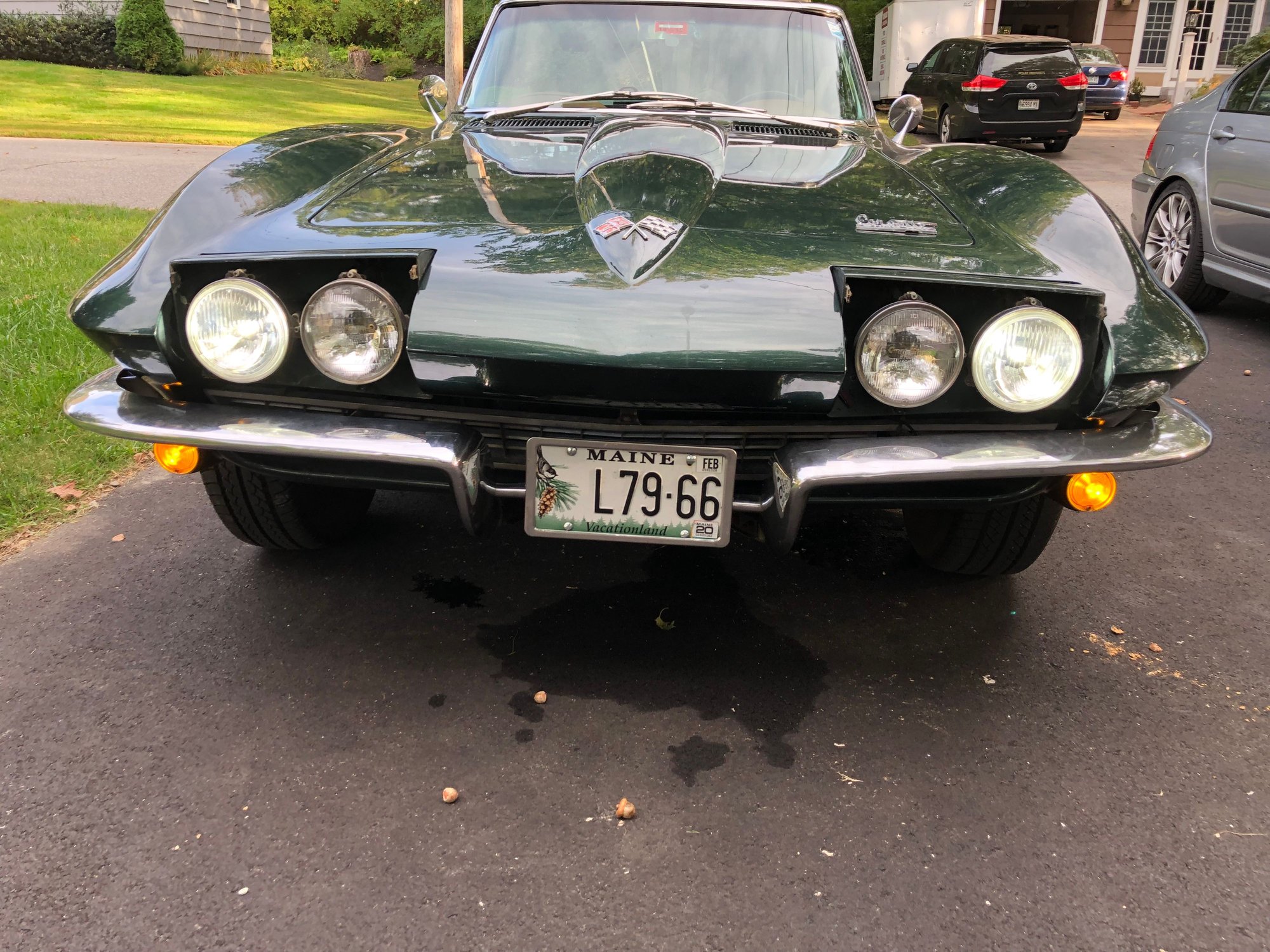

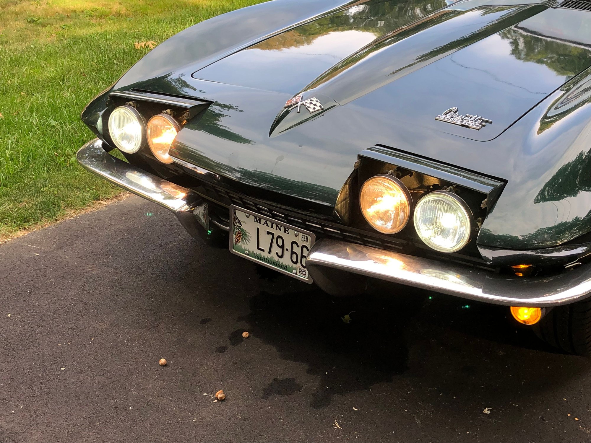

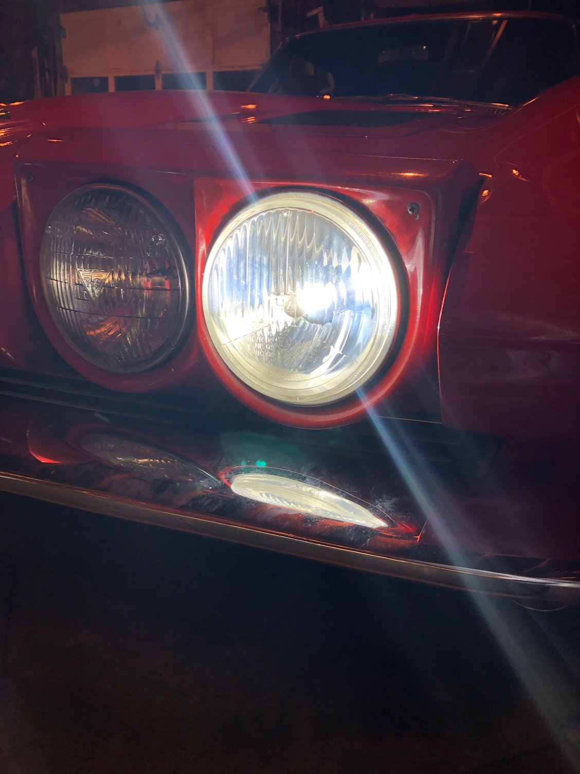

Hi, most of you know I am on the road a lot...Even at night..... I have installed Hella 4 lens & Perfect Fit LED bulbs. No problem with lens fitting chrome ring...only a little bit of space between end of electrical socket & bucket wall.
Here are some some day pictures. I will take car out tonight and adjust lights on a straight road.
I have only replaced the low beam..you can see in pictures halogen hi beam.
I will give my opinion & pictures later tonight.
Jack

Nice Jack - I just ordered the same parts to convert my low beams to the same LED's .... Looking forward to the install!?
Old Sep 22, 2019 | 05:43 PM
Jackfit's Avatar
Jackfit
Joined: Feb 2006
Posts: 5,073
Likes: 412
From: Maine
Hi Tom, only difficulty can be with spring that holds tension on chrome ring for adjustment. You will figure it out when you take ring off to remove sealed bulb.

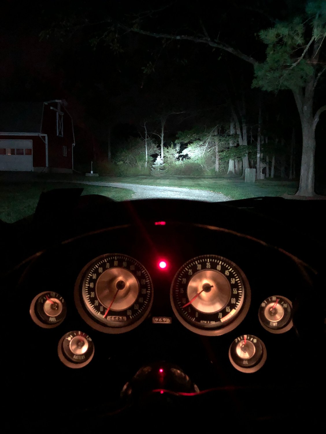

I have been meaning to take pictures of my led bulbs/h4 set up. They will need to aimed slightly lower but the brightness is fantastic and the bulb pattern is great too. I’m glad others are experiencing good luck with the combination.

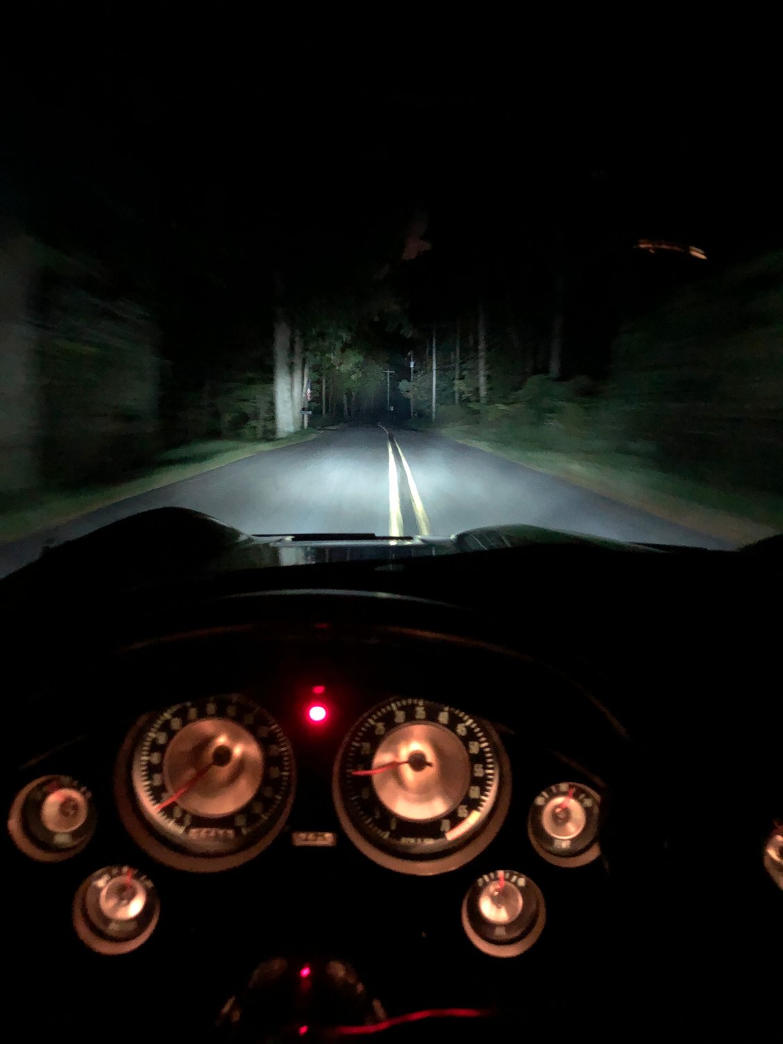

, Light is bright, but I can not properly adjust them due to my buckets do not open enough. When I restored the car 10 years ago, the buckets were installed with regard on to gaps being equal on opening...when I installed my sealed beams I had very little up adjust left.
I will adjust my Y. Stop on my bucket allowing more opening..allowing full up & down adjustments of lens.
So until I am satisfied with down range lighting at speed, I will hold off on judgement.
But definitely, fine adjustments are needed.
Hi, I am in the process of experimenting with LED and H4 Halogen bulbs. I have had Halogen sealed beams for years...but wanted to try LEDs. I have replaced the two low beam sealed beams with Hella 4 lens casings. These will take both LED and H4 Halogen bulbs.
LED bulbs are limited by the size of the heat sink. I have used Super Nova Perfect Fit bulbs with the standard 3 prongs for stock harness plug
I have also ordered H4 Halogen 65 watt replacement 3 prong bulbs to insert in Hella 4 lens.
Adjustment and focus will be the be necessary to really compare all three different systems.
I have found that my buckets do not open enough for down adjustment of the H4 lens. It was enough for the sealed beams although I was at maximum up aim on the adjusters .
MY QUESTION IS : Can I reach the adjusting bolt on the Y bar (top bolt that hits light bucket switch) at end of open sequence...
WITHOUT TAKING OFF MOTOR FROM SHAFT...... can I reach in and turn it....? I have taken the motors out and rebuilt them...but don't want to do more work than needed.
