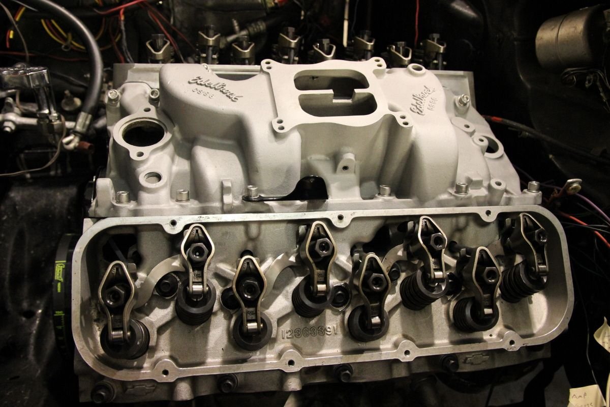

Hello all, I'm having difficulty choosing which manifold to use on my 66 coupe running a 496 ci, moderate+ Howard's roller cam, lifters and rockers, 4 speed, headers and a 780 Holley. I'm not trying to make a racer out of it but want good performance and getup-and-go. I have the choice between an Edelbrook C396 or a GM 3933163 (I currently have them both available) I would use the Holley 3310 - 780 with the Edelbrook or the Holley 3418 -850 cfm for the GM. What is the thinking and why?? :o\
This is the setup today.

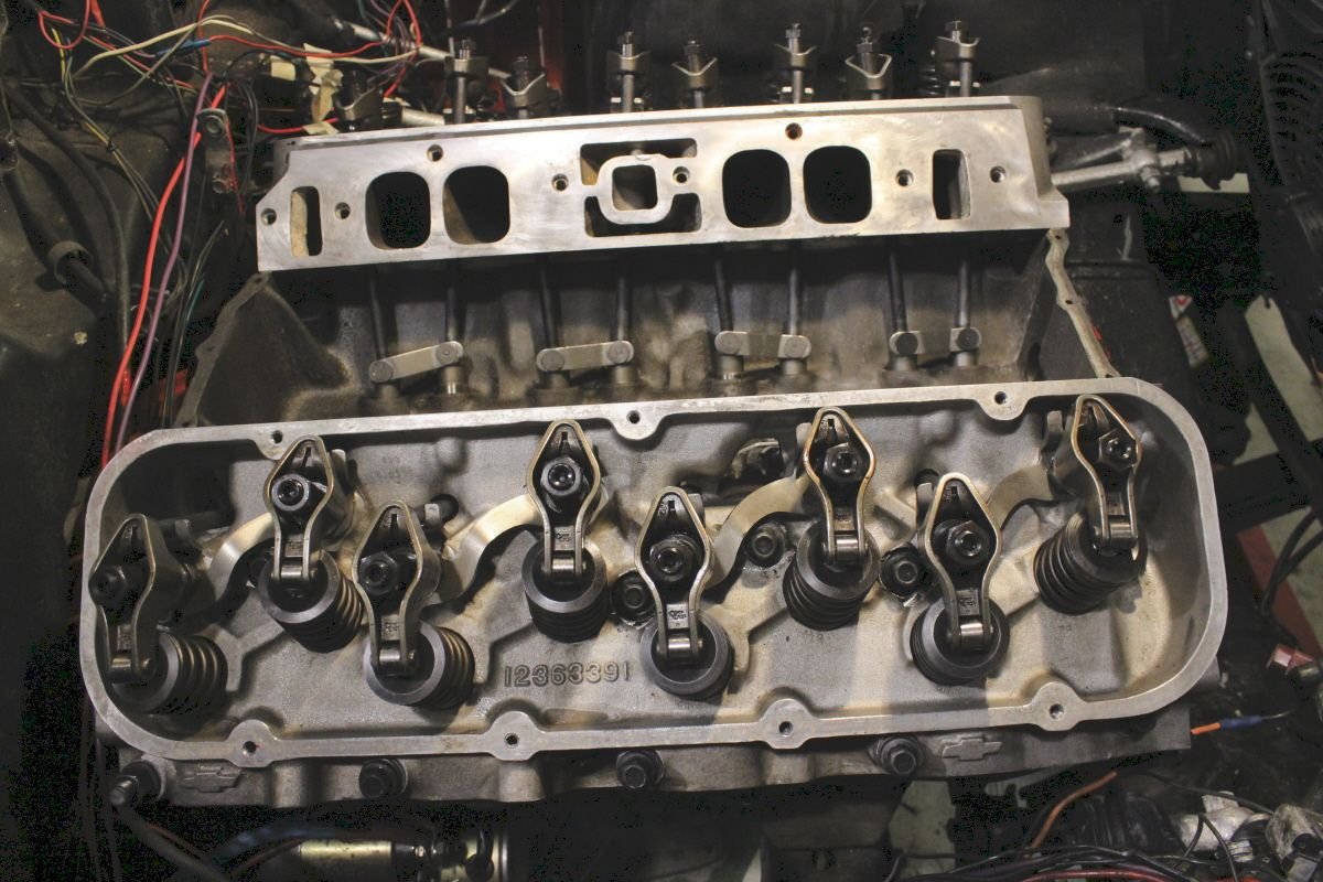

The heads are GM aluminum 391 and the C396 has the notch for the 3 barrel (which I do have). The ports do match up pretty well

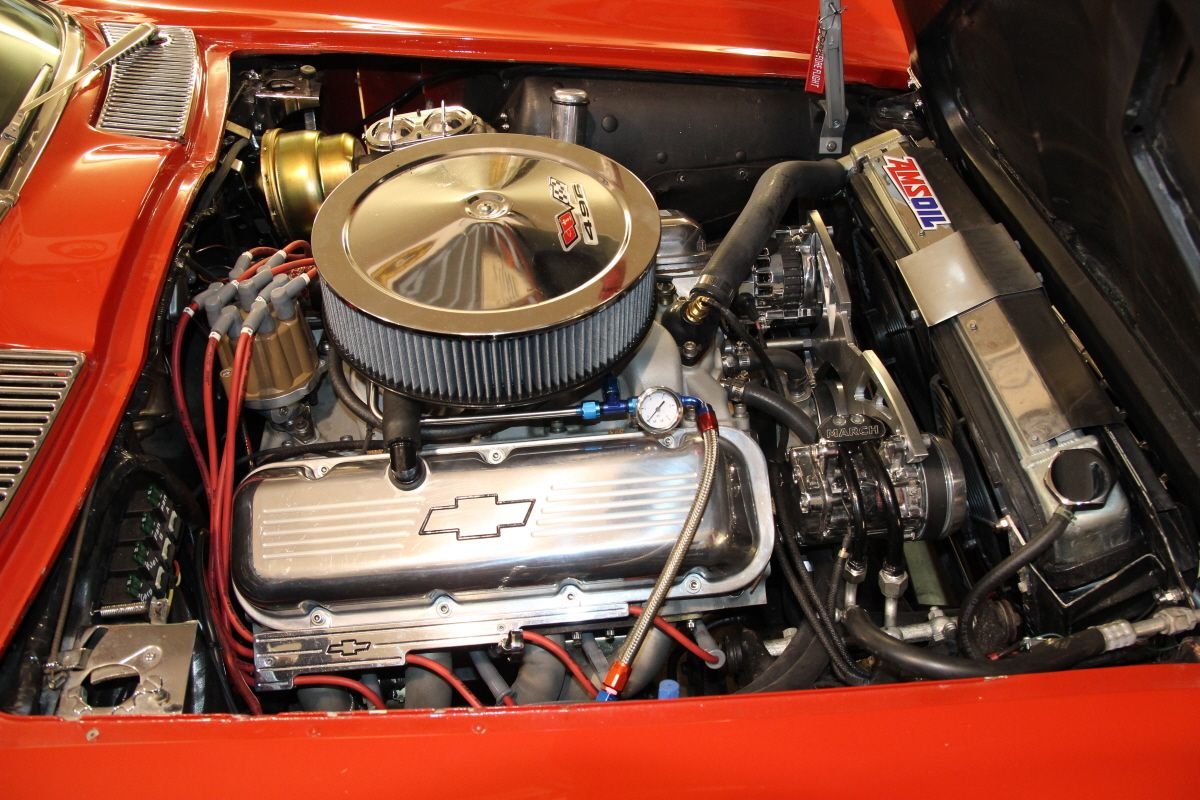

On my 66 with a 496 with a good size hyd roller Howards cam I used the 163 intake. On reason is I wanted the factory look and I knew it fit under the bubble hood. On my car it was more for the look of a GM intake than anything. What Howards cam did you use. I'm just curious.

Good looking motor! Currently it still has a custom Crane roller Cam with their hyd. roller lifters. When I change manifolds I'll be changing the cam to the Howard's 120665-12 roller with their hyd. rollers. I wish I knew more about the Crane cam as it has TOOOO much power and makes it hard to drive. Step on the gas in fourth and the tires smoke (stock size) Howard's recommend theirs for me. If anyone knows how to find out more details on the pictured Crane let me know. I tried contacting Crane by phone, e-mail, and letter but got nothing. The company has closed and opened so many times that don't seem to have any records left
