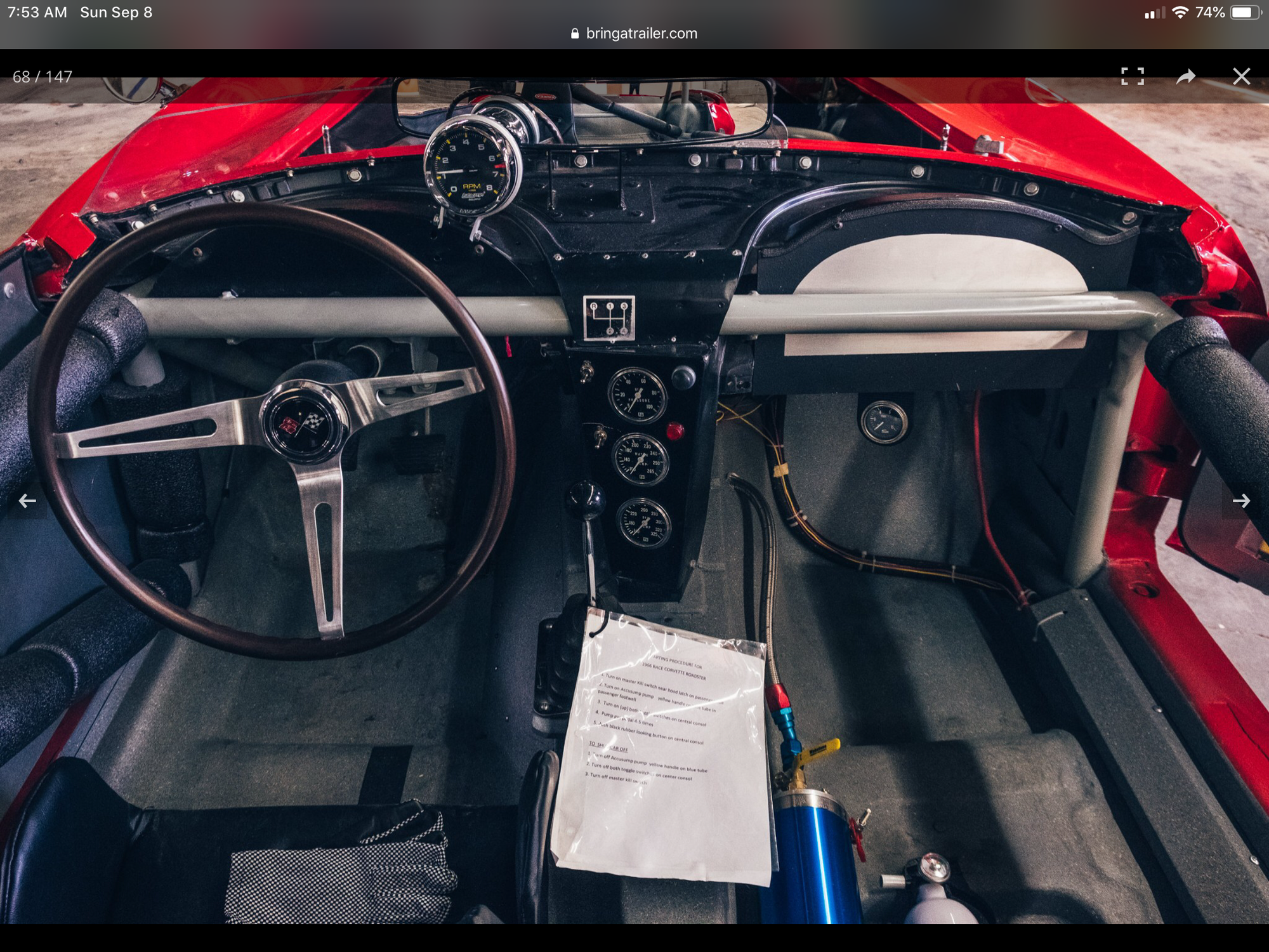

Need pics of roll cages in c2s especially fire wall entrance into engine compartment and cross piece under dash

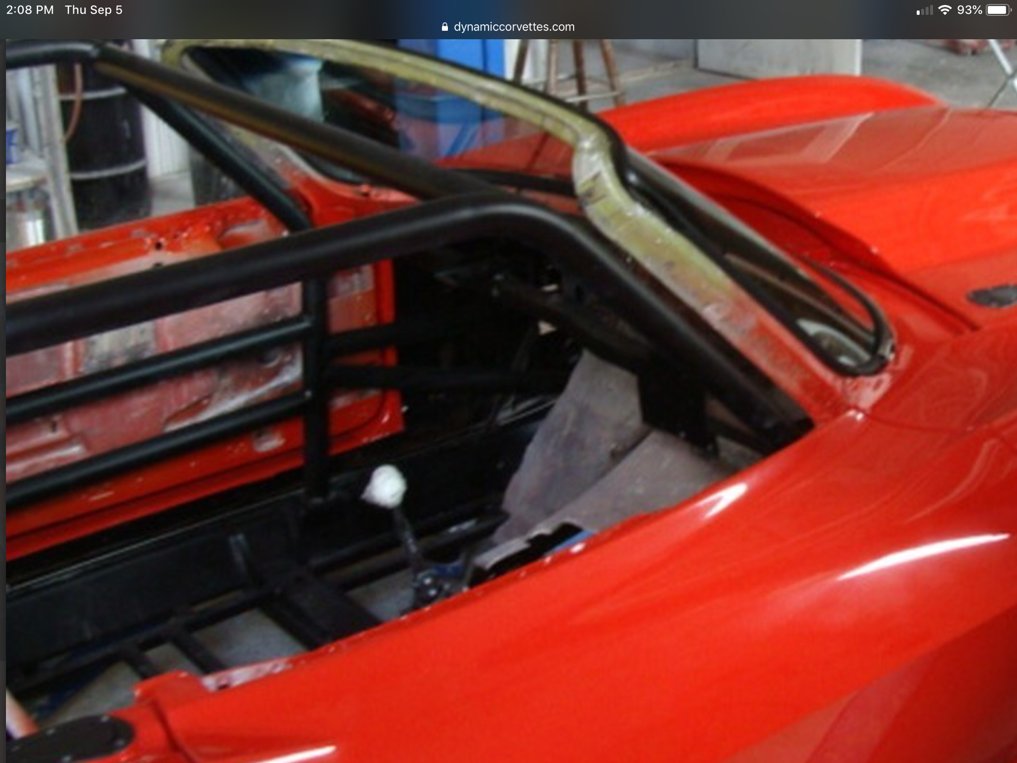

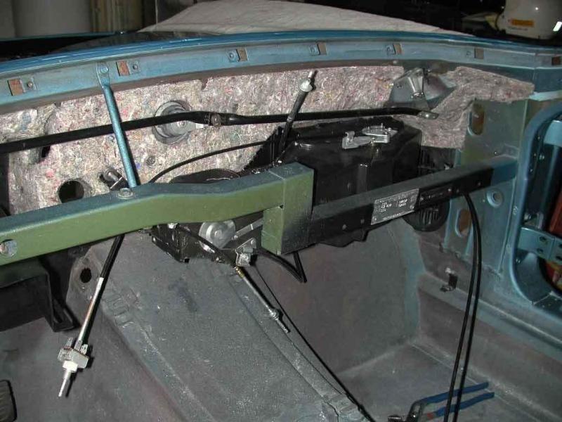

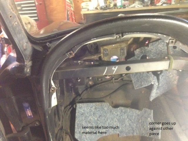

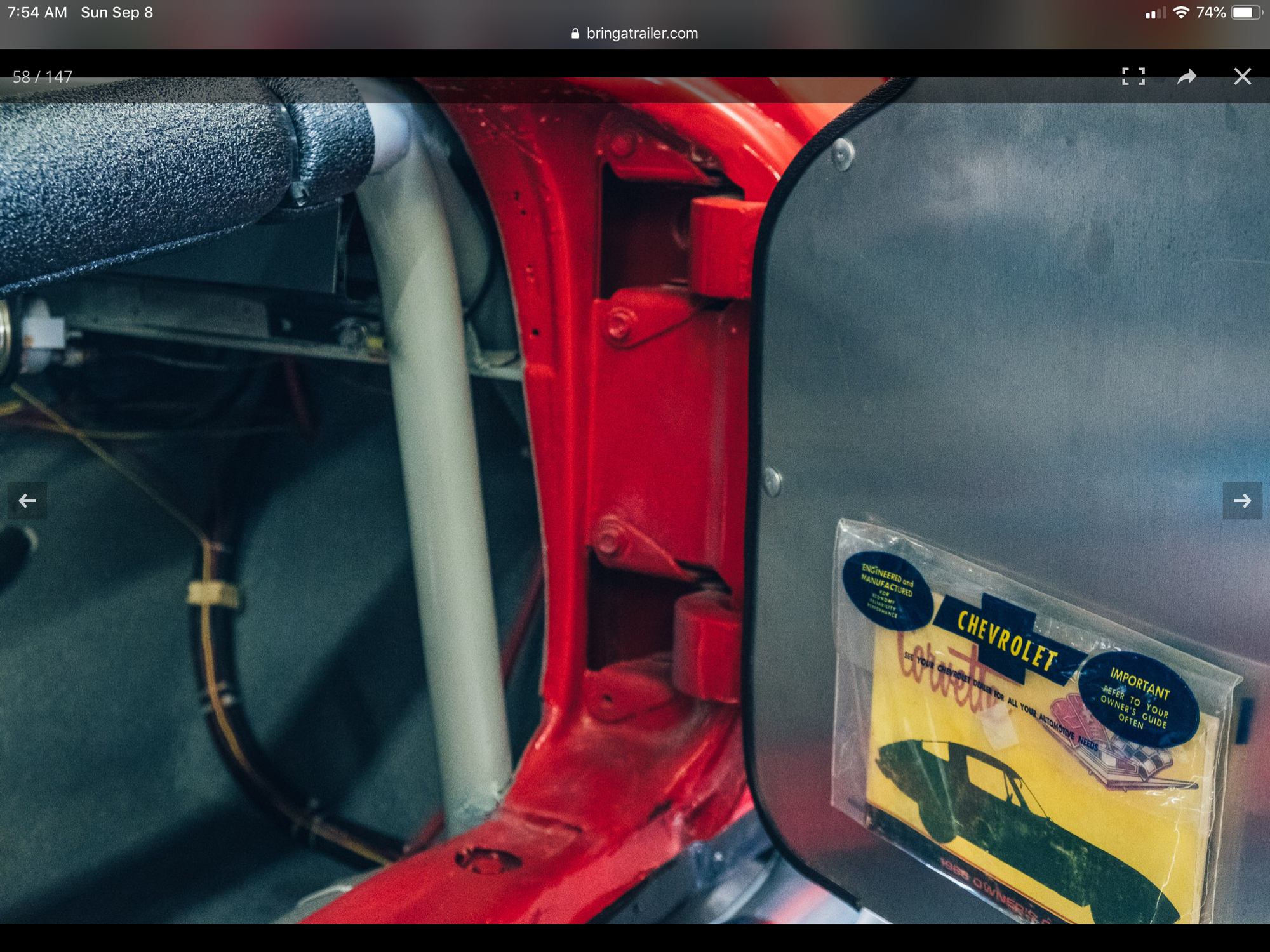

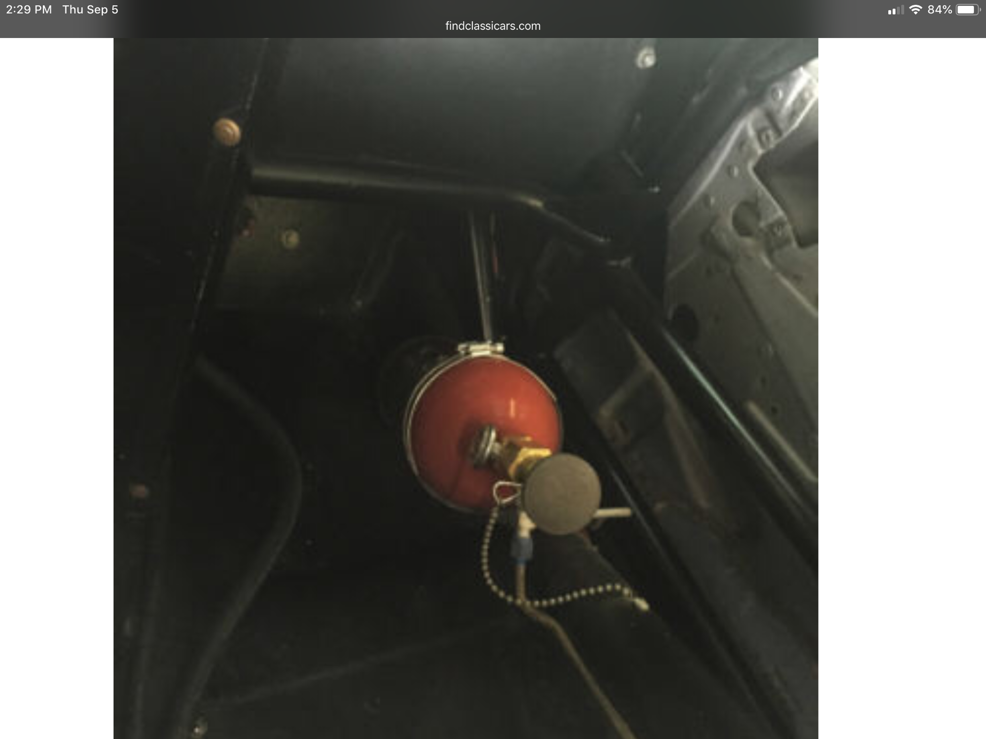

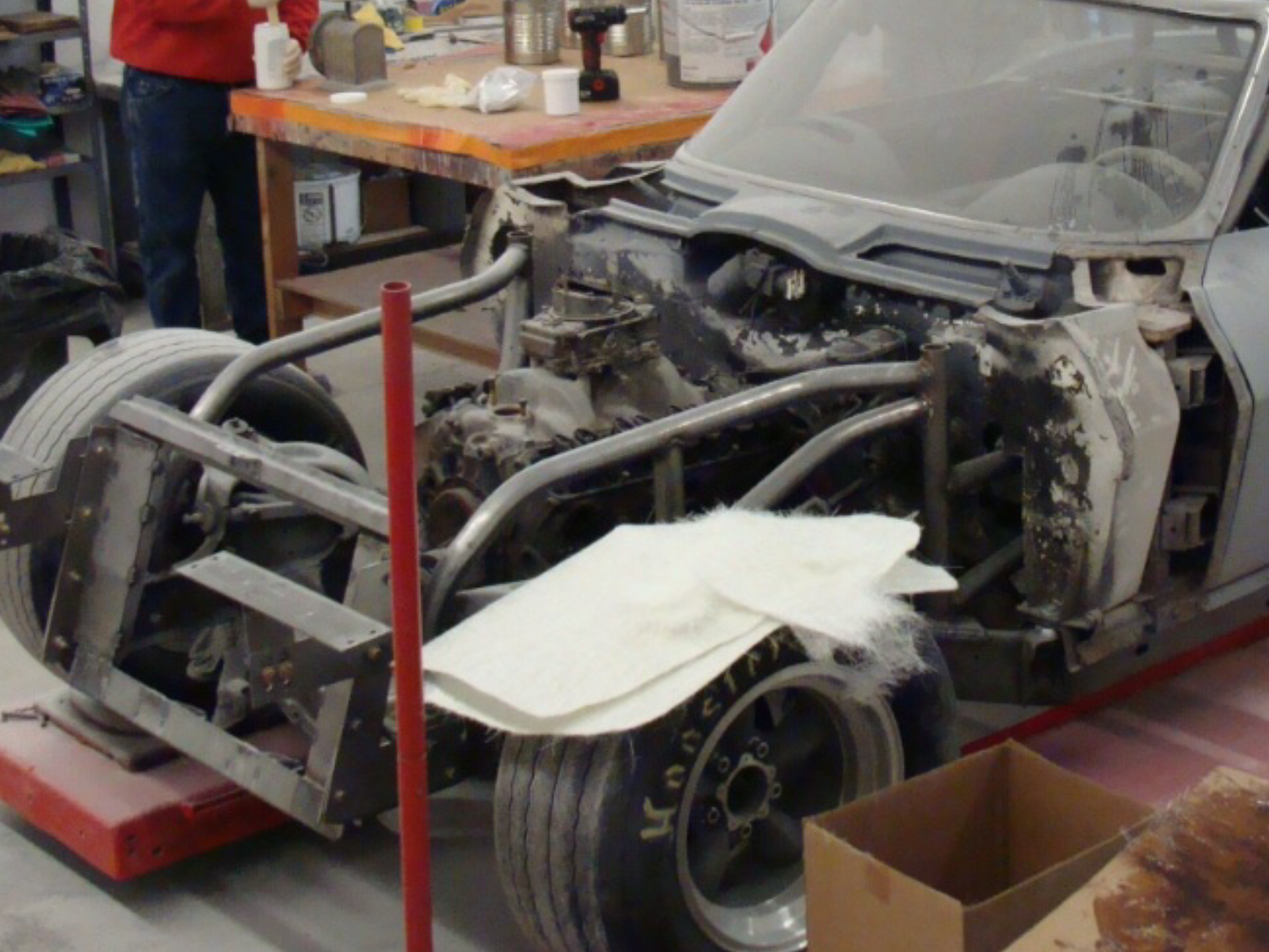

These are from a project on the Dynamic corvettes website.
Old Sep 5, 2019 | 05:33 PM
Saddletan's Avatar
Saddletan
Joined: Oct 2013
Posts: 593
Likes: 199
From: Lower Jefferson
C2 of Year Finalist (appearance mods) 2019
Every one is different.

I just cut the square tube stock crap out of there at the dash and just bring a whole bar across, and then the tie in to the engine Compartment thru firewall is easy!
I saved the stock pieces cut out, even though I think this was a poor way of doing it.

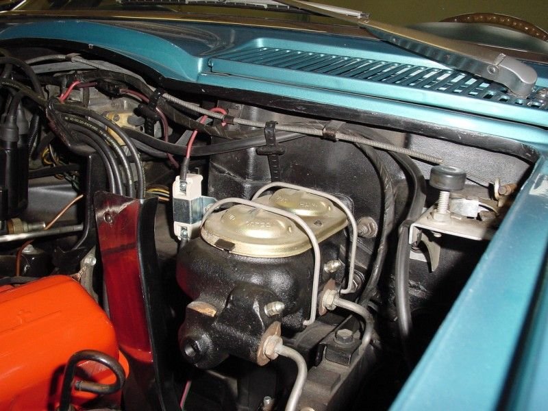

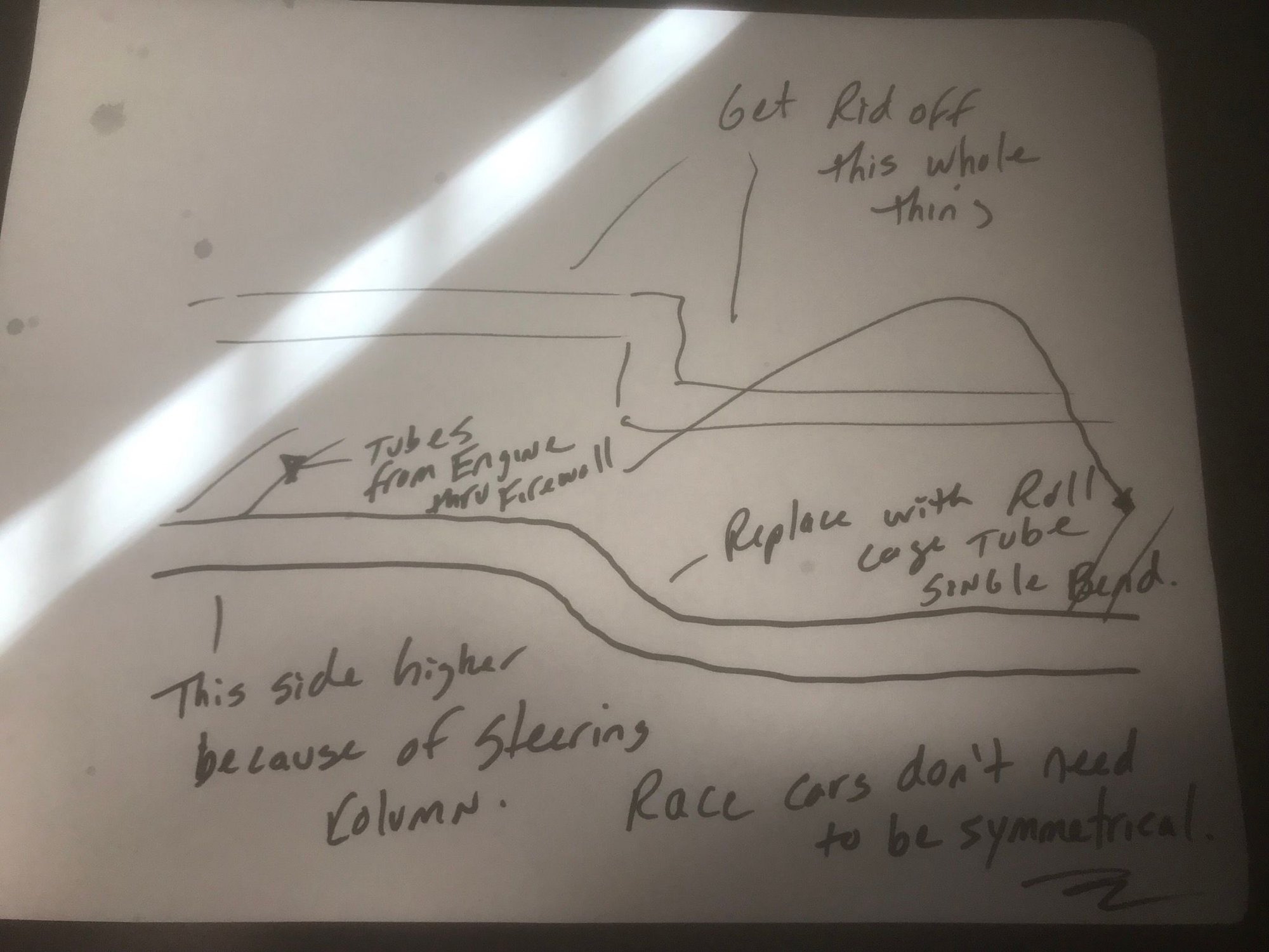

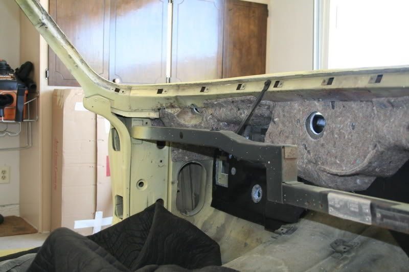

My project is buried under a ton of stuff, I am working on my El Camino presently! And I have it currently out, the cage.
I am using plate welded to frame, welded to the bar structures.
Then for the connection bars, I was bringing in another plate! One plate has threaded inserts welded, and the other just holes. Plan that it all is removalable is my complicated puzzle, I actually was trying to solve too.
If if you look at our cars.
Right side you have the brake mc, the wire loom connectors, steering, pedals, etc and then the headers (got to come in over those)
I have big holes in my firewall, but honestly trying to think for I want or need to come thru the firewall? Just do the standard 6 point, with your own taste!
If you are not racing super high end stuff (I initially was planning on the Silver State Nevada Hilo run), then just protect the drivers compartment! The bars in the engine are really a pain in the azz!

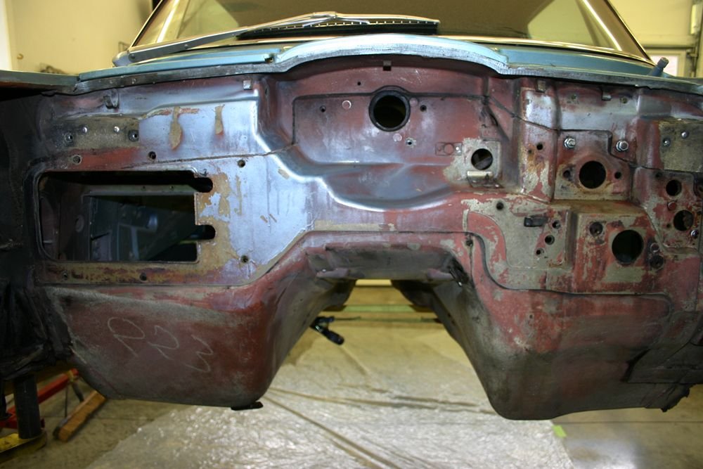

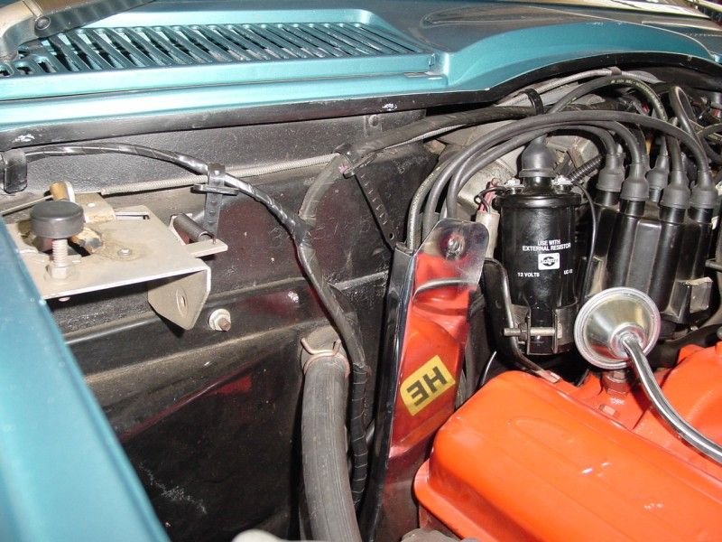

Here is what we face.
That's my '67 327/300.
Old Sep 7, 2019 | 11:26 PM
TCracingCA's Avatar
TCracingCA
Joined: Sep 2002
Posts: 38,348
Likes: 2,076
From: California
Dont worry!!!!!
No need to run to the garage, we are not installing a roll cage. For some reason, those pictues were super handing to show what all we have to think about to punch Engine bars thru the firewall! Nice pictures! 👍

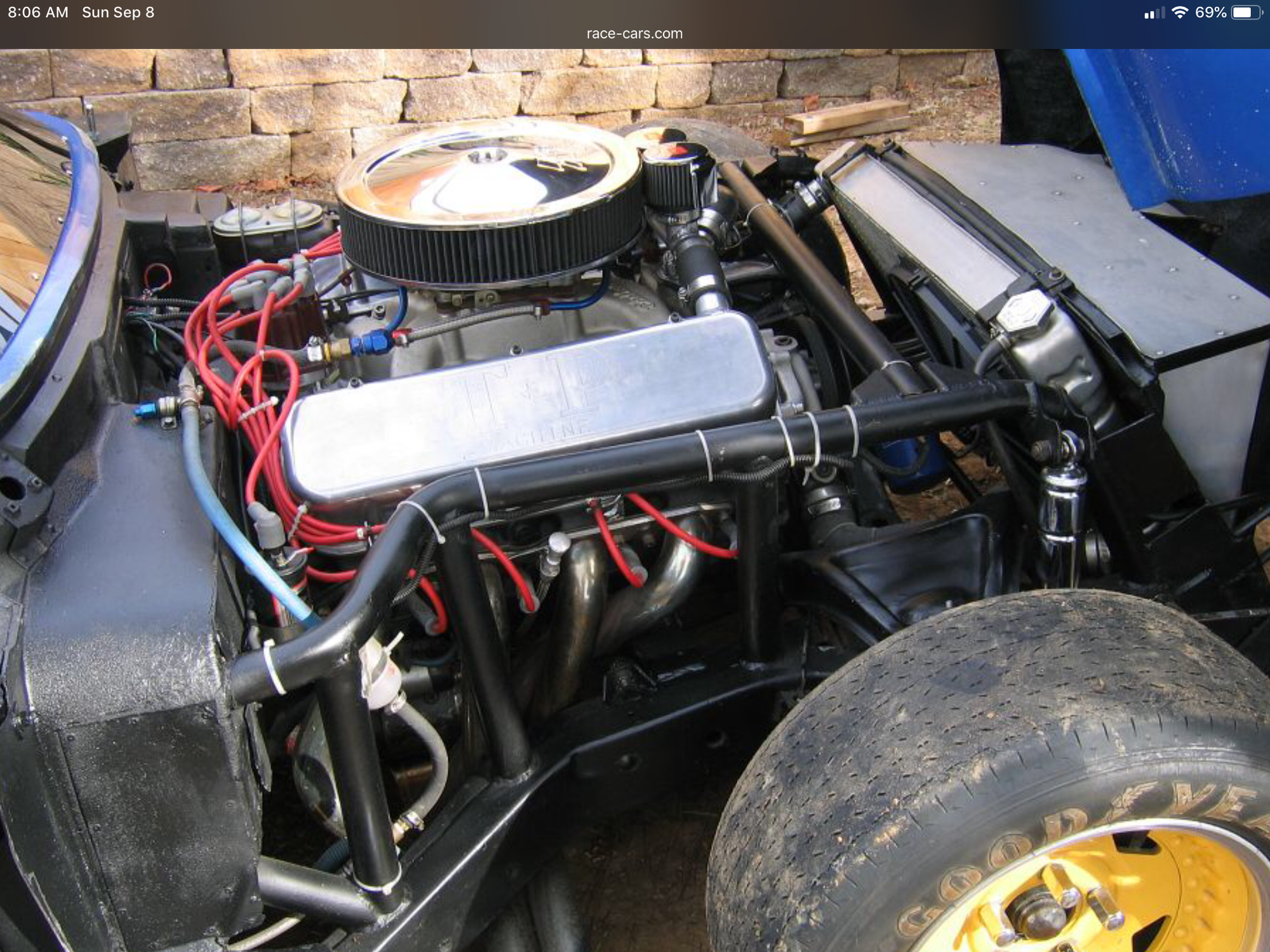

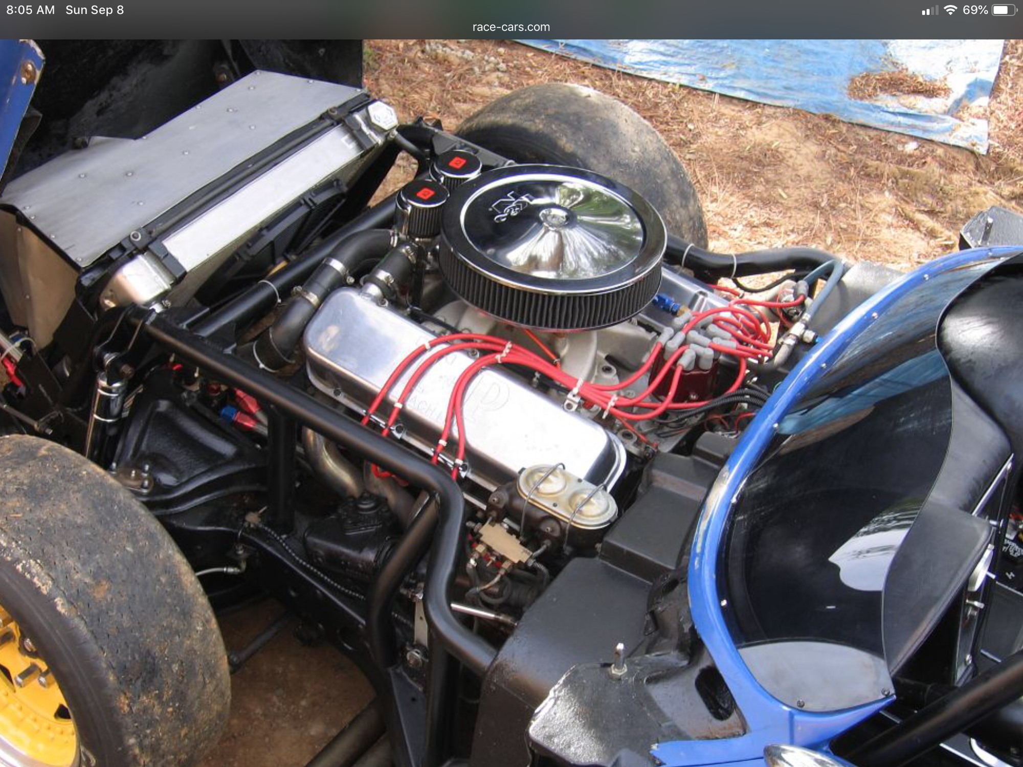

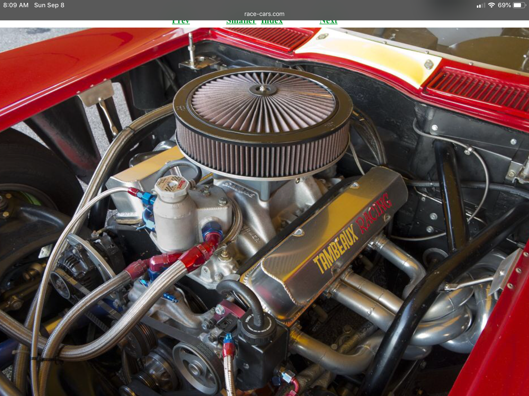

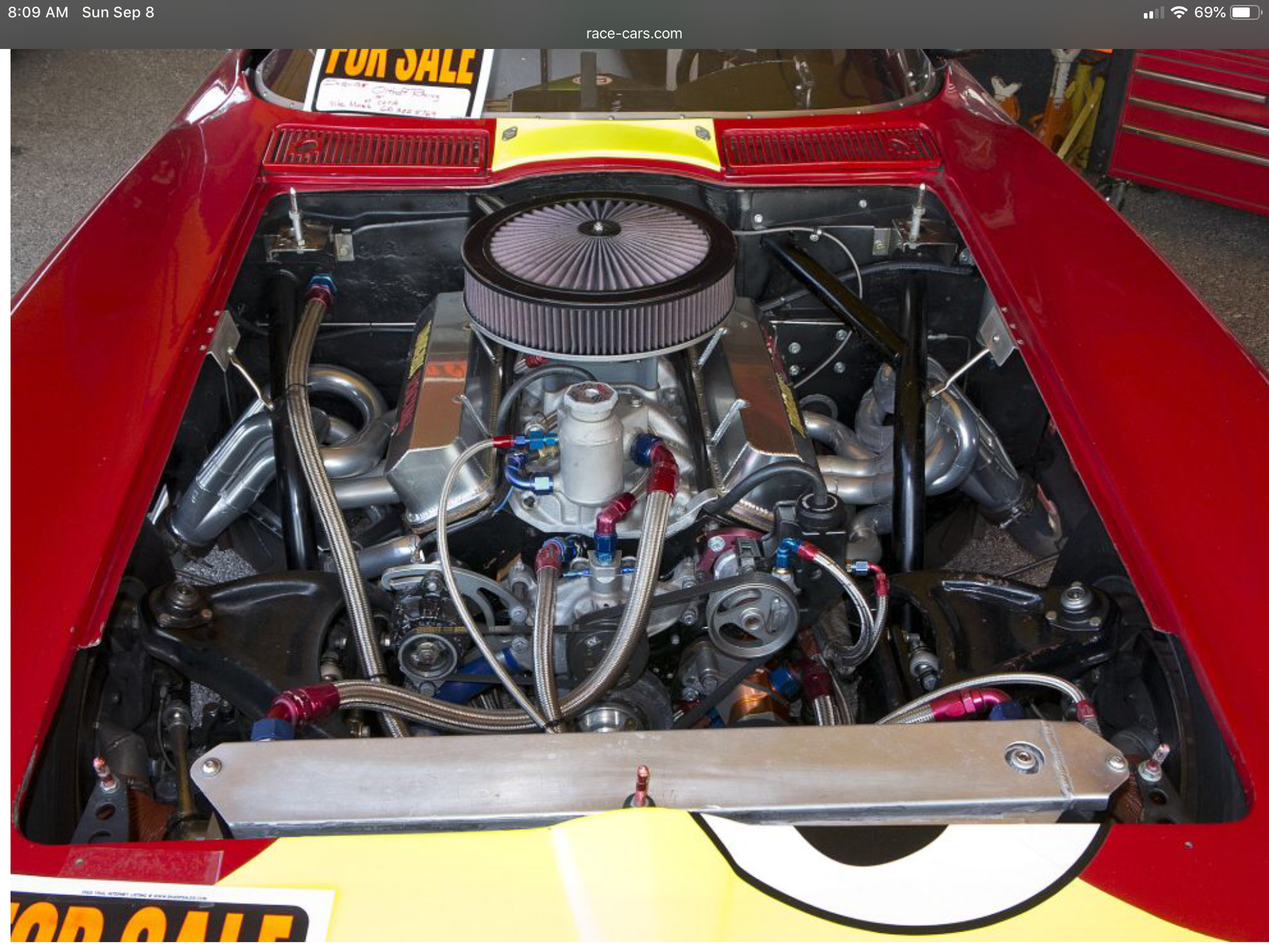

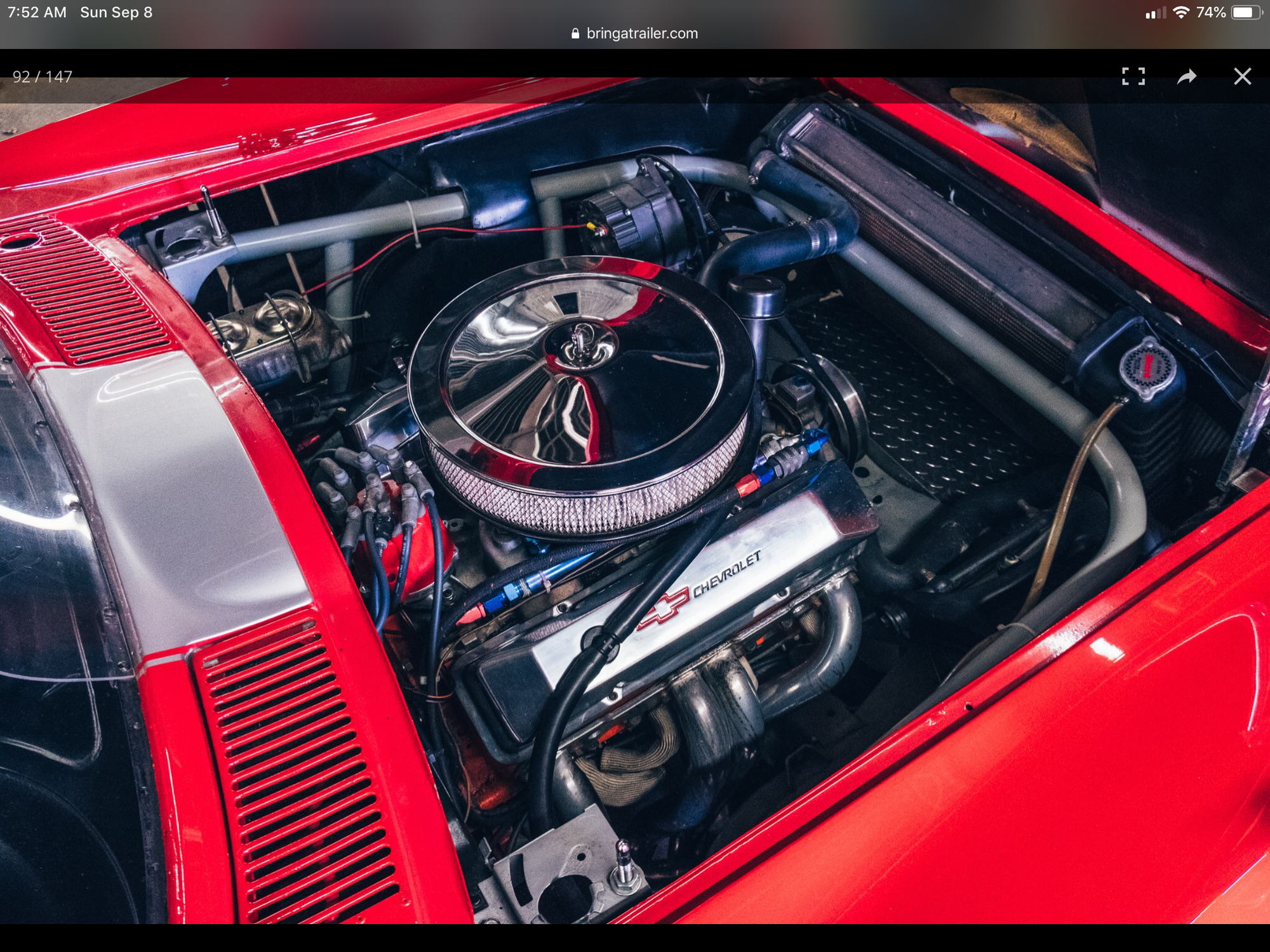

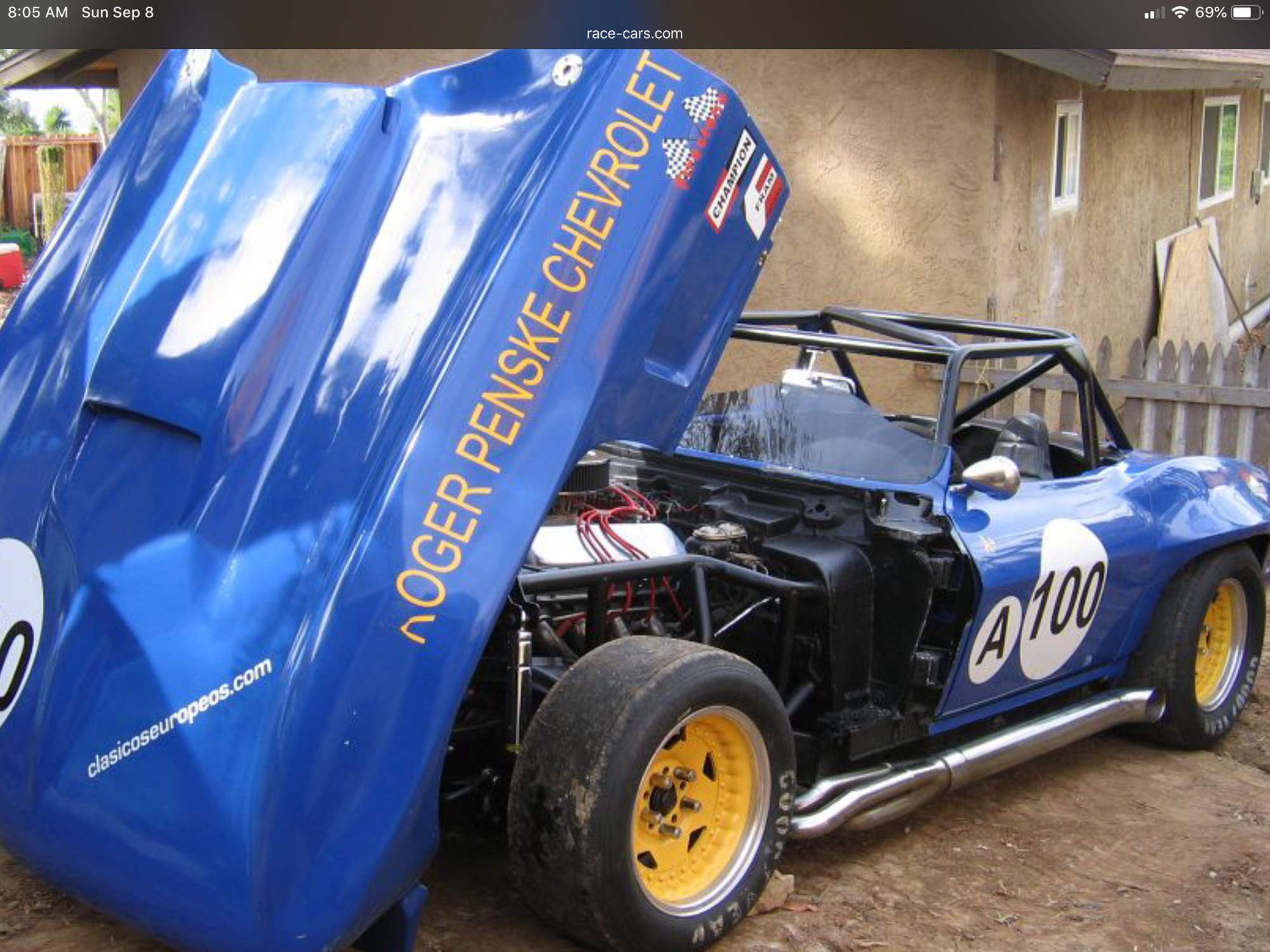

Most of the Vettes I have seen at vintage races haven’t had tubes running into the engine compartment. They weren’t competitive with Shelby’s or Cobras. If the car was GT1 or BP it had a 10 or 12point bar. If you want street/track you have to think about what will happen if you get in a wreck without a helmet on. The best racing cage wont be a good fit if you have a passenger. Here’s some more stuff I found in for sale ads. This one has a NASCAR type tube.

Tilt hoods make it easier to see...
To Roll cage

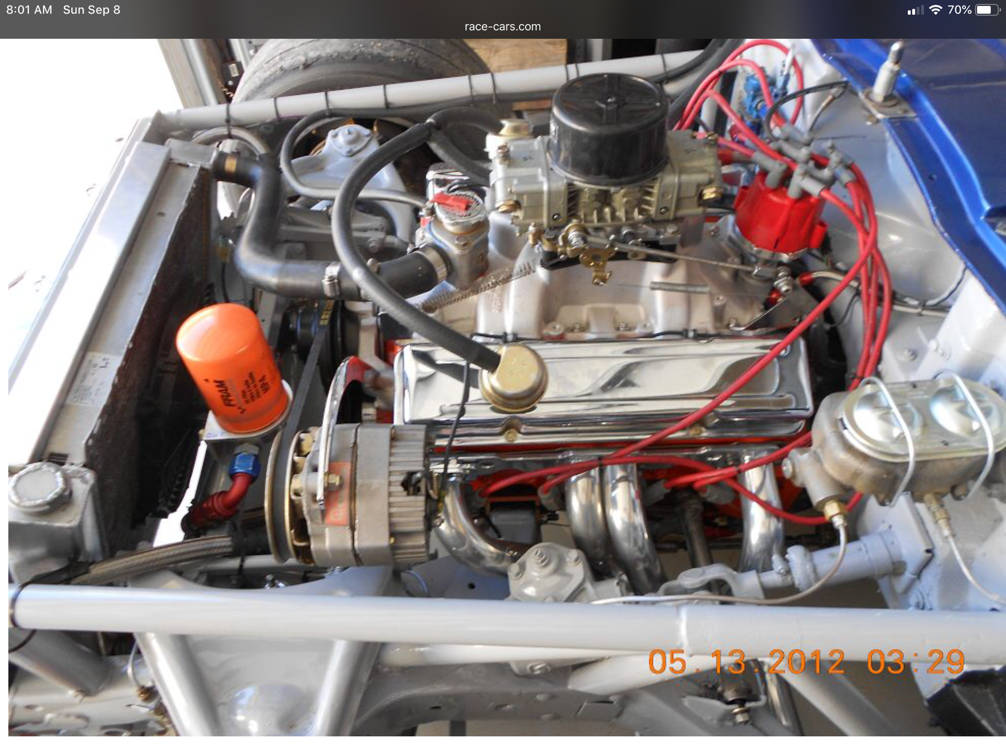

These headers are killer!

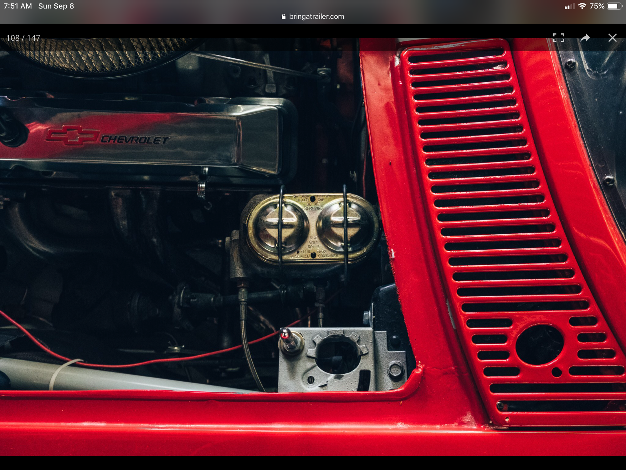

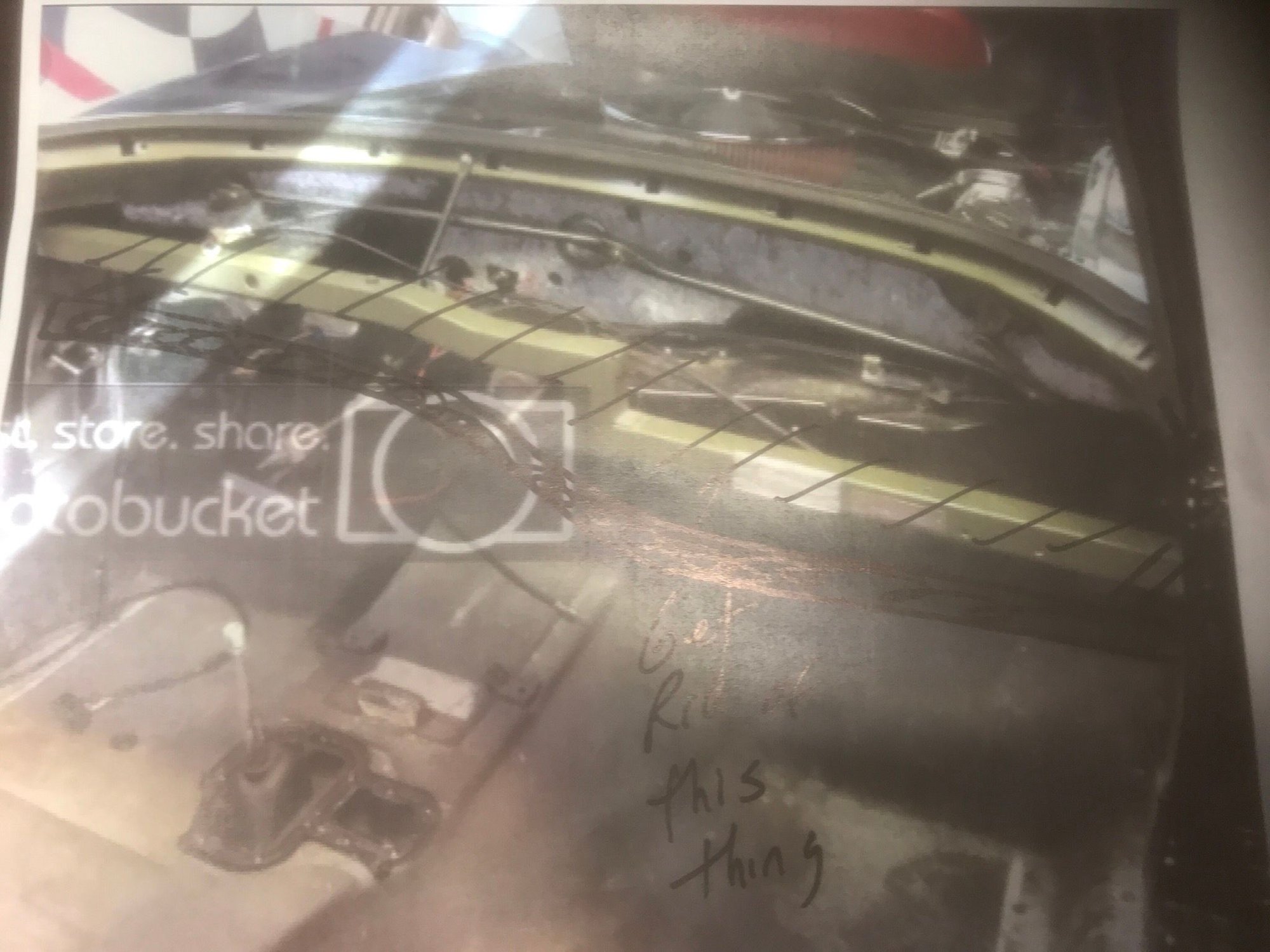

I have a whole bunch of different designs limitedly photographed to, I will have to post the best so have seen! My car was running GT-1 prior to my purchase, I had no camera back then. The only pictures I have of it early were in periodicals! Once I got a camera, I was trying to keep up photographing cool things, mostly cars, and as I was a young guy focused on just buying film, I have 600 rolls of film undeveloped, I need to get into that project.
I was getting out some magazines, so I checked my other car, and on my racer, the rollcage was punched thru under the hood release above the hood release that I don’t have. It is pretty much at the same height as the brake master cylinder hole, just a little big higher. The bar is just slightly higher than the Z-bar.

Old Sep 8, 2019 | 11:49 PM
reno stallion's Avatar
reno stallion
Joined: Apr 2013
Posts: 3,483
Likes: 1,823
From: McCloud CA
Very nice now were getting somewhere
