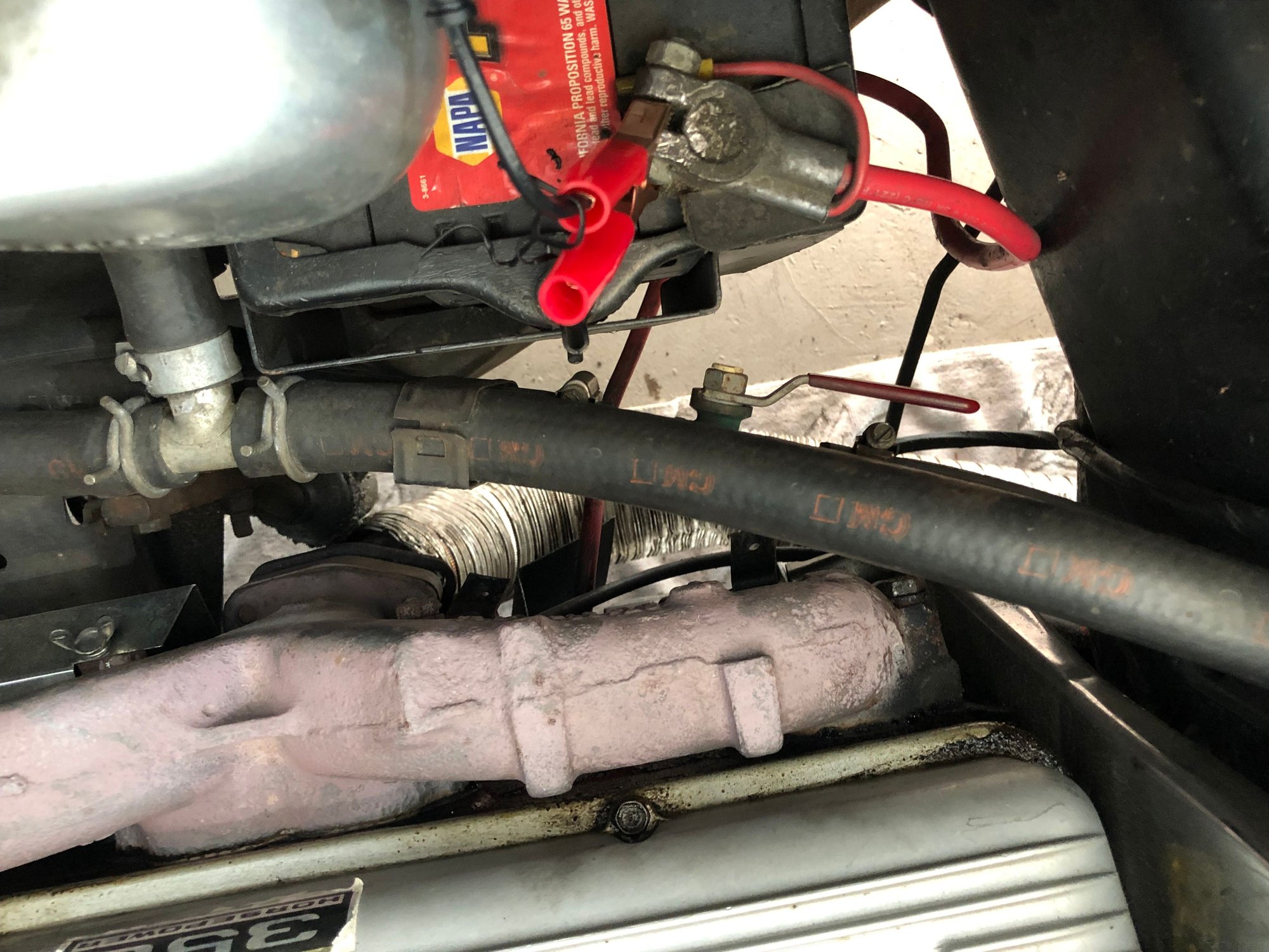

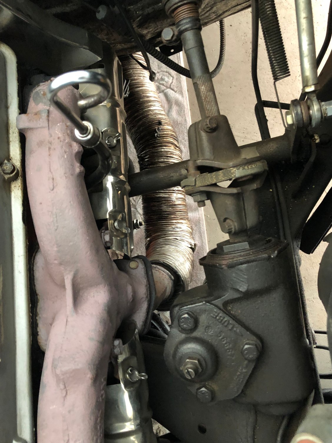

Hi, sorry I am at work and do not have my computer for pictures. Here is what I did . Bought four pieces of flex aluminum dryer hose, 2 1/2 or 3 in dia. four foot lengths . Just side over header pipe from flange to mid point connection. You do need to disconnect pipes at mid point to put on header pipe. I also put one on from mid point to muffler. It will not melt or burn....it is flexible and you stretch it over pipes.

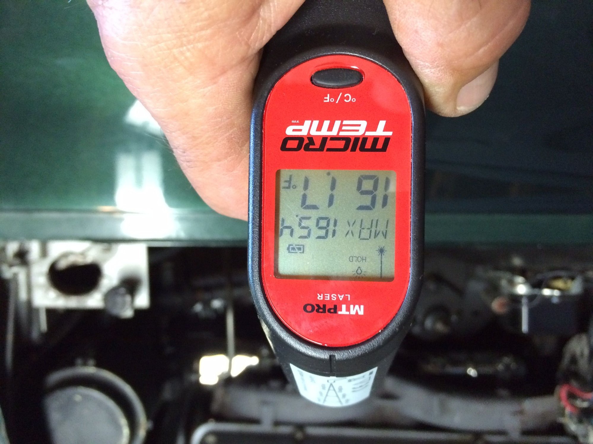

Temp at header...500* plus. Temp 1 foot down header with temp gun.....220*.... The flex pipe keeps the heat from reaching floor and firewall of car.
I drive year round and in the summer it really makes a difference .. Some of you may have seen it on my car when I visited on my 48 state trip....If you live in the south, you will really love this fix.
Jack

Over 500* at header. 161* one foot down
