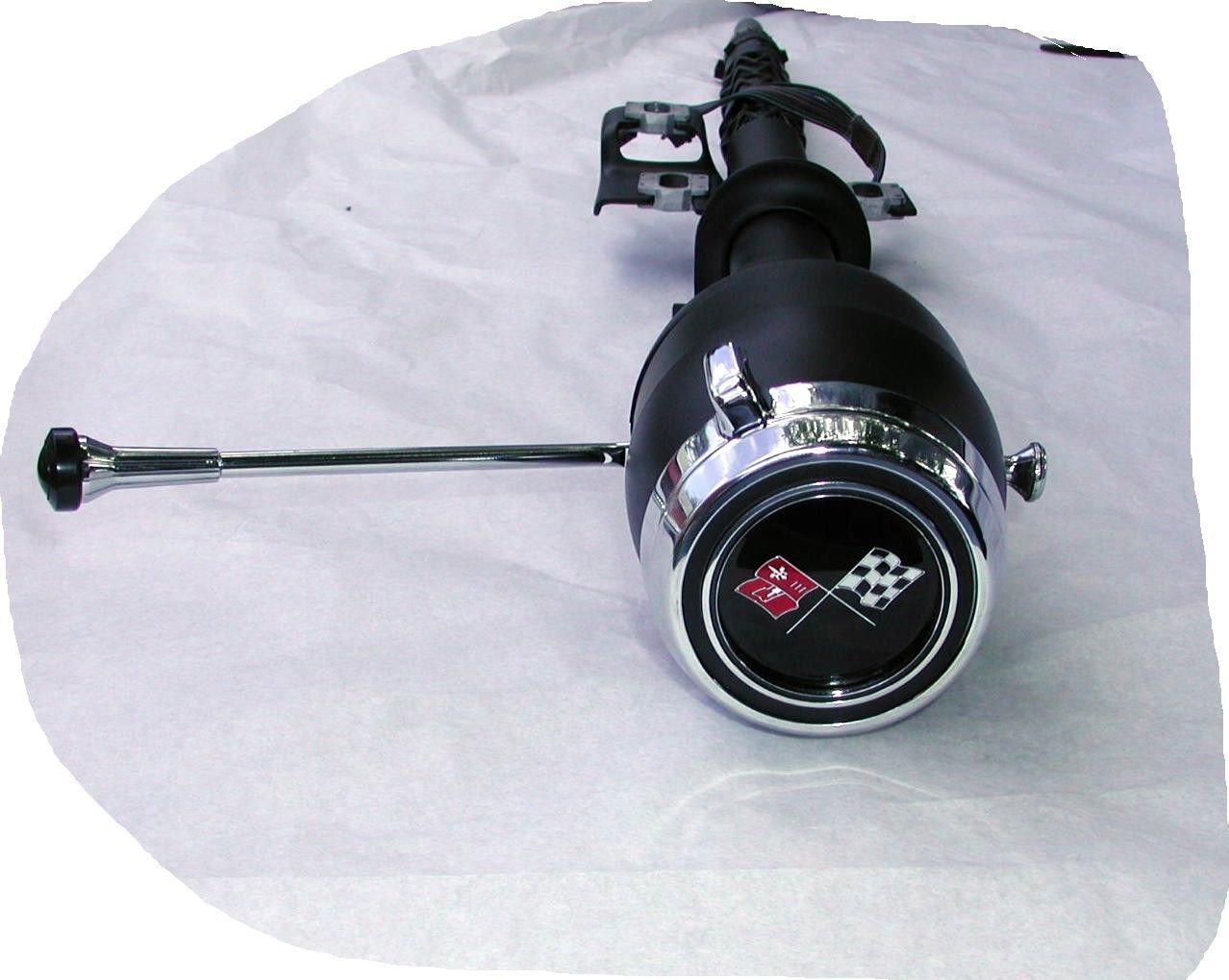

If your column looks like this, you will see the locking lever just behind the horn button. If you don't have that lever, then you have a standard column.
