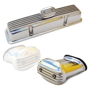

Yes, this has been discussed before. There are some interesting threads and photos showing different approaches. .... I researched them so I could run old finned aluminum Corvette valve covers on a hotrod I'm buiilding with a custom built small block Chevy engine. I'm leaning toward using breathers from Mooneyes like the one below. I plan to mount it to the side of the valve cover toward the carb. The top is removable to add oil. To complete the PCV system I'd need to plumb a fitting, PCV valve and hose from one valve cover to the intake.

Thank you. That’s what I was thinking. I was unaware that you could open the cap to add oil. Looks good.

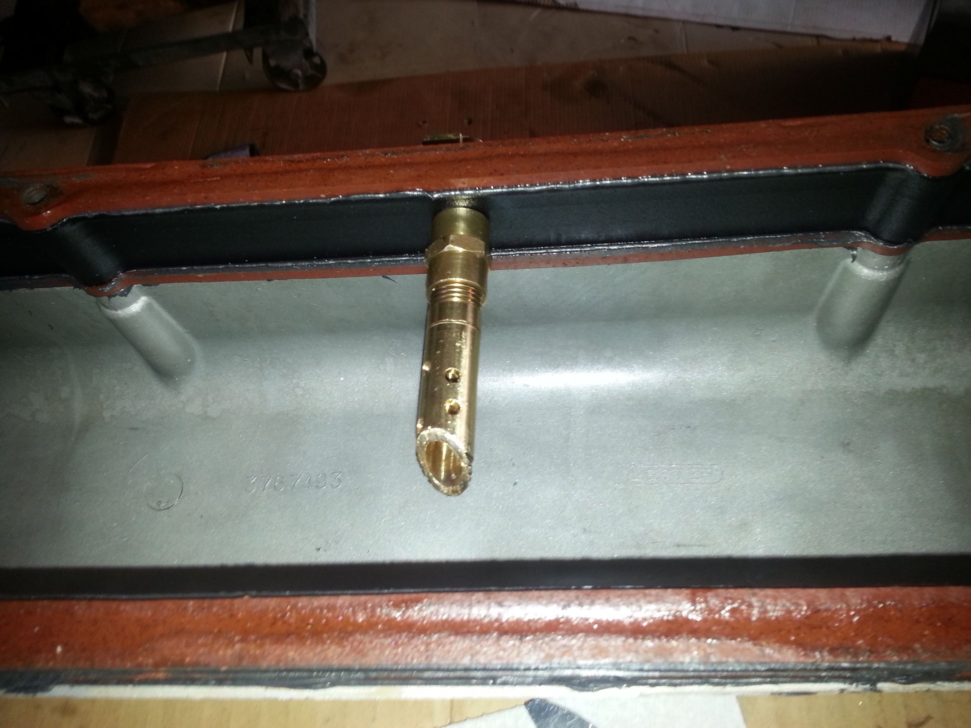

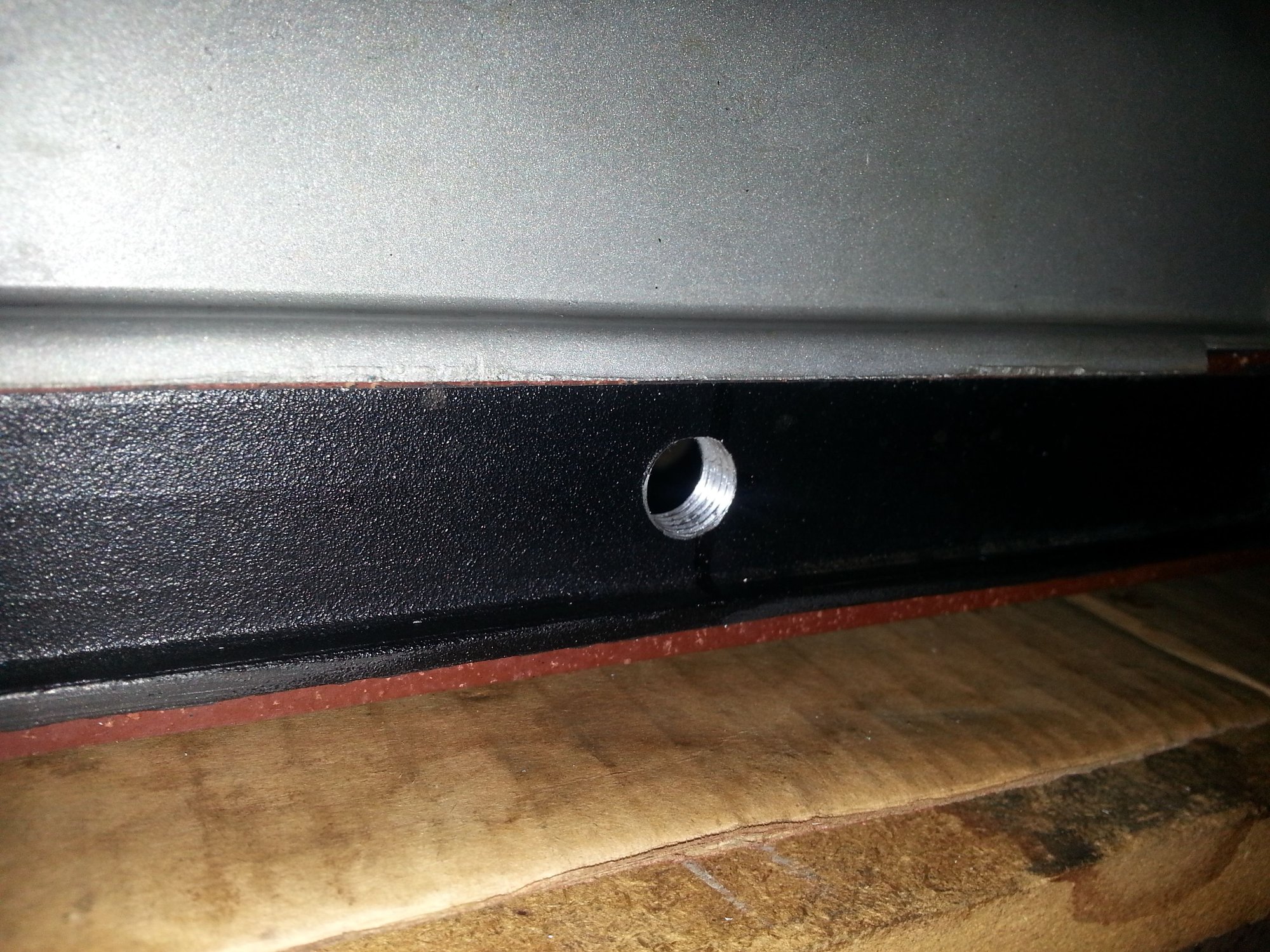

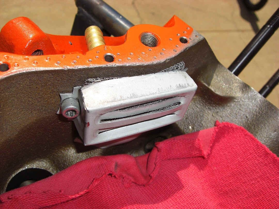

I tried two different methods of venting a 350 block while using finned valve covers. I drilled and tapped a hole in the rear china wall of the block and in my valve cover spacers.
In the block china wall vent I used a valve cover baffle. The valve cover baffle is not as good of an oil separator in the lifter valley as the factory 283/327 tomato can. Extended operating above 4000 rpm pulled considerable oil into the PVC system (about a quart ever 500 miles). This would probable be good for a race car with limited miles driven, or a casual driver that keeps the rpm low, but with 4.11 gears and constant freeway speeds I needed to better address the oil consumption.
I then tapped a hole in a valve cover spacer, and built a few different types of baffles. A threaded pipe goes through the spacer, and pipe fittings on both sides sandwich the spacer wall in between. The baffle nipple in the valve cover spacer shown was eventually shortened because it interfered with the stud girdle, and replaced with an elbow and nipple to draw air in higher in the valve cover chamber.
The valve cover baffle needs a hood to be most effective, to deflect direct oil splash, something more effective than the vented pipe shown or louvered valve cover baffle shown at the china wall. I ended up with an elbow turned up inside the valve cover, a configuration that works, but it would work better if it had a hood. I fabricated another elbow and nipple with a 3/4 copper pipe cap soldered on top as a splash hood, and I tossed it in a drawer until the next valve lash exercise (if I remember).
I tried a few different configurations and realized what makes the tomato can effective is the large interior volume slowing down the airflow to promote the oil to drop out as it flows through the can. I ended up fabricating a remote oil separator that fits under the tin where the coil normally sits (I use a remote E-coil). It draws crankcase air from the valve cover spacer, separates the oil in a large volume chamber with baffles and an air filter, and then scrubbed air is ported off the top of the separator through a PCV valve to the carb base. I use the china wall vent as a drain back hole for the oil collected in the bottom of the separator. Oil filled crankcase air is drawn off the valve cover area through the spacer vent, the oil is separated and drained through the china wall vent, and the cleaner air is drawn into the carb base through a PCV valve. The fresh air intake for the crankcase is through a 63' style oil fill tube in the intake manifold, piped for intake air from the air filter housing base.
This venting ended up being more elaborate than expected, but there is no oil consumption after extended high rpm operation with the separator and piping as described, and the factory finned script valve covers are unmolested and the piping is not obvious to a novice observer. It works, and driving is more fun than wrenching, so it's good enough for now.
If you have valve cover spacers, with or without a stud girdle, this may give you a primer of some of the problems and ideas to come up with a better vent and baffle inside the valve cover & spacer. A vent port in the back of the intake manifold is also a good option instead of a port in the rear china wall, and would probably be an easier location to fabricate a more effective oil splash shield with a larger volume baffle to reduce the air velocity and oil carryover. A rear intake manifold vent port could work as an oil fill port with a funnel, but a normal size oil fill tube in the front of the intake manifold is likely the best solution. A bit of time brainstorming and sketching will come up with improvements over what I did.
