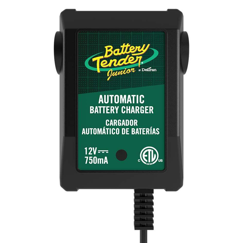

Unfortunately it's getting to be that time of year. I'll be parking my 66 soon and have a couple of other toys I'd like to keep charged. Does anyone have experience with this Battery Tender model? I'd be hooking it up to charged batteries on my 66 L79 roadster, 68 deVille convertible and 2 boat batteries. Generally I just unplug the batteries and charge them in the spring but it seems healthier for them to keep them topped off. I appreciate any advice.
https://www.amazon.com/Battery-Tender-022-0148-DL-WH-12-Volt-Management/dp/B000CIPHUI/ref=sxin_4_af-pna-1_ef9e7037137596678e0e0eafc3774b07b93b30ec?keywords=battery+tender&pd_rd_i=B000CIPHUI&pd_rd_r=6e5a26c6-a51a-4587-8dd1-a241325005eb&pd_rd_w=nteeF&pd_rd_wg=mlvrr&pf_rd_p=04e18f1f-f4d1-4a3c-8900-ae9cd2124c28&pf_rd_r=56Z608C89CAZVRANV8FE&qid=1571760349&smid=ATVPDKIKX0DER https://www.amazon.com/Battery-Tender-022-0148-DL-WH-12-Volt-Management/dp/B000CIPHUI/ref=sxin_4_af-pna-1_ef9e7037137596678e0e0eafc3774b07b93b30ec?keywords=battery+tender&pd_rd_i=B000CIPHUI&pd_rd_r=6e5a26c6-a51a-4587-8dd1-a241325005eb&pd_rd_w=nteeF&pd_rd_wg=mlvrr&pf_rd_p=04e18f1f-f4d1-4a3c-8900-ae9cd2124c28&pf_rd_r=56Z608C89CAZVRANV8FE&qid=1571760349&smid=ATVPDKIKX0DER

jc, I have a Battery Tender that I've had in almost continuous use for about 10 years on a riding mower with an AGM battery with no issues whatsoever. I got it as part of a group buy here on the Forum to try it out and the price was excellent as I recall.
A friend purchased the one you posted from Amazon and has had no issues and seems satisfied.
On my own vehicles (AGM batteries) I have been using BatteryMINDer's for about 20 years. My original one is still in use, they were about 1.25 amps back then. The latest model is now 1.0 amp. If you are starting with a fully charged battery the 1.0 amp will be just fine.
Newest model available at Northern Tool for $37
Just be sure you are purchasing a minder and not just a trickle charger. Minders do not 'float' or charge continuously. They charge to a preset value then turn off until battery voltage drops to a lower, preset voltage, then turn back on. If it doesn't say it's a minderit probably isn't...

I use Battery Tender products on all of my cars and motorcycles when I expect to have them sitting for a while. They seem to work fine on cars, but I have had several motorcycle batteries end up dry after a while.

I had one go bad on my truck = the truck is used mostly in the winter. It cooked the battery.
I have 4 Sears Brand and they range from 20 to 10 years old with no issues. I still have 2 battery tenders but put them on a timer so they are on only 10 hours per day. This way if something happens the issue will be less.

I have about 8-10 in use during winter on the vette, tractors, mowers, ATV, etc..... The real Battery Tender product seems to last longer than the knockoffs. About $25 at Walmart. I only buy the small one ~3"x2"x1" and permanently attach the plug to the batteries so all my stuff's ready to go.

But, the Battery Tender series are good quality, I use them at home.

Probably a dumb question on my part but in reading the reviews they're all over the place. My first thought in getting one of these was to just plug it into my batteries while they're still hooked up. My clocks are set, I'm running a Sniper in the Corvette (I'm not sure if it matters if that has power to it), etc. I'd figured I'd uncover the car in the spring and the time would be right and away I go. Is this safe or is it more designed to unplug everything and charge it on a bench? It was a huge pain just to try and get a battery topper on the midyear battery.

I have two of the the two port models. One of them is hooked up to two cars year round. The other is hooked up to a car and a generator. No need to remove your batteries from the cars. I have one of them for over 10 years and the other since 2016.
