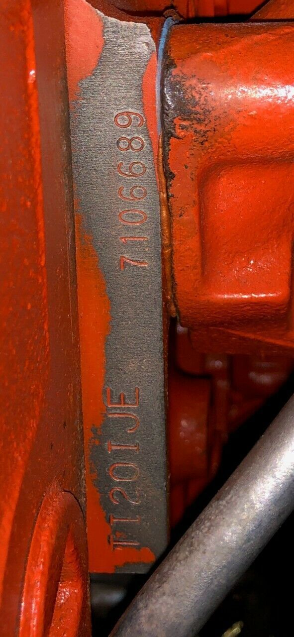

Seems too crisp for me, your thoughts?

To me that looks good but being a 435 others with more experience can chime in.

Looks very good to me, and that opinion is worth everything you're paying me for it.

Pretty broach marks...no opinion on the stamps as I'm not too familiar with big blocks

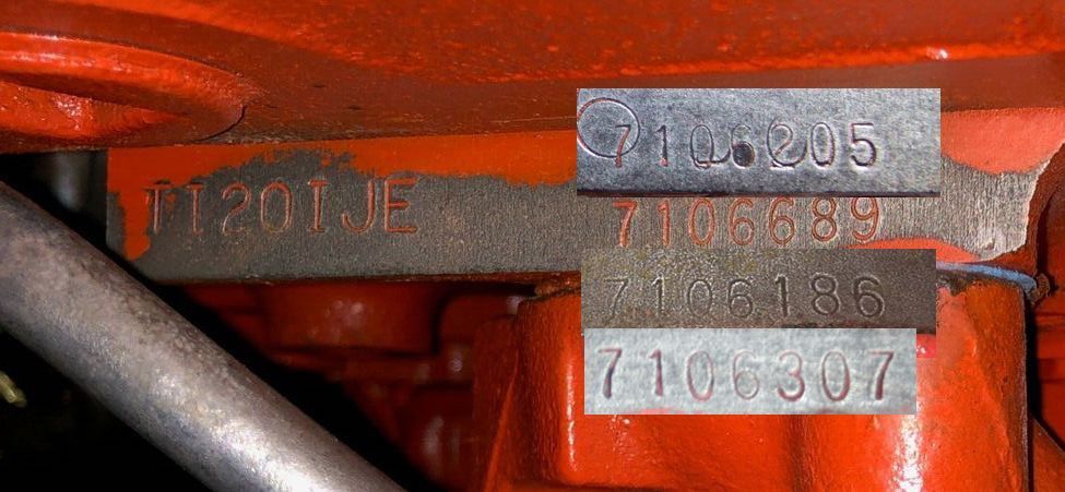

Compare for yourself... what do you think?

In king rats comparison the top and bottom examples are typical where the number one after the 7 is at a slight angle consistent with other original pads in the range. My opinion is well done restoration engine which could well pass in a judging situation.
Great collage for comparison. My opinion is the number 6 doesn't look the same as the other photos. Thats just my opinion. Very cool KingRat!

”Restoration engine” re-stamped or original what ever you want to call it.It looks RIGHT to me. You will get all kinds of opinions here simply because it is a BB. If this car were 300 h.p. with a stamp like this everyone would say it is original—end of story. There are as many PERFECT looking stamps as there are ones that aren’t out there. Re-stamps have improved vastly over the years especially with the ability to recreate the correct broach marks. Today collectors know all of this and often will not buy a car without documentation to prove a “born with” engine. You say too “crisp” but if it were always painted from day one it will. If not it will have some rust or discoloring from the rust which can easily be created with water and very little time.
I would call it good but many will require further documentation because there are more 1967 435 h.p. Corvettes out there today then Chevrolet built.

To me the broach marks look too deep. JMO

I don't see broach marks. I see a bunch of man made chicken scratches.
They vary in depth depending on how long the cutters were used and wear. engineslimited.com has had a factory broaching machine for several years now.Look at their website and you eyes will be opened to all of what has been going on for over 40 years with just THEM.

To me, both stamps look to be just too perfect. I won't say that I haven't seen perfect stamps, but it's rare, and even rarer to see both the engine and VIN stamp to be so perfect. Normally you'll find at least one digit crooked, lower, higher, or out of line some how with the others, and mismatched fonts are also common. For every digit to be perfectly and evenly positioned, and every one of them to be of the same font type, is highly unlikely, in my opinion.
When I do a pre-purchase inspection, unless the suffix and VIN stamps are way off, I'll usually describe them as follows; "the pad appears to be typical of factory stampings", and that's about all I could say about this car's pad.
As far as documentation, it's nice to have, but just like all of the bogus stamp pads out there, there's also plenty of bogus documentation floating around. Personally, I usually doubt the validity of any tank, window sticker or P-O-P, that comes with a 67 big block today. Other than original dealer paperwork, such as a dealer invoice, I consider most other documentation to be suspicious. Admittedly, even things like order forms and dealer invoices, can be forged.
Unfortunately, the best anyone can do is know what they're looking at, and do their due diligence.
