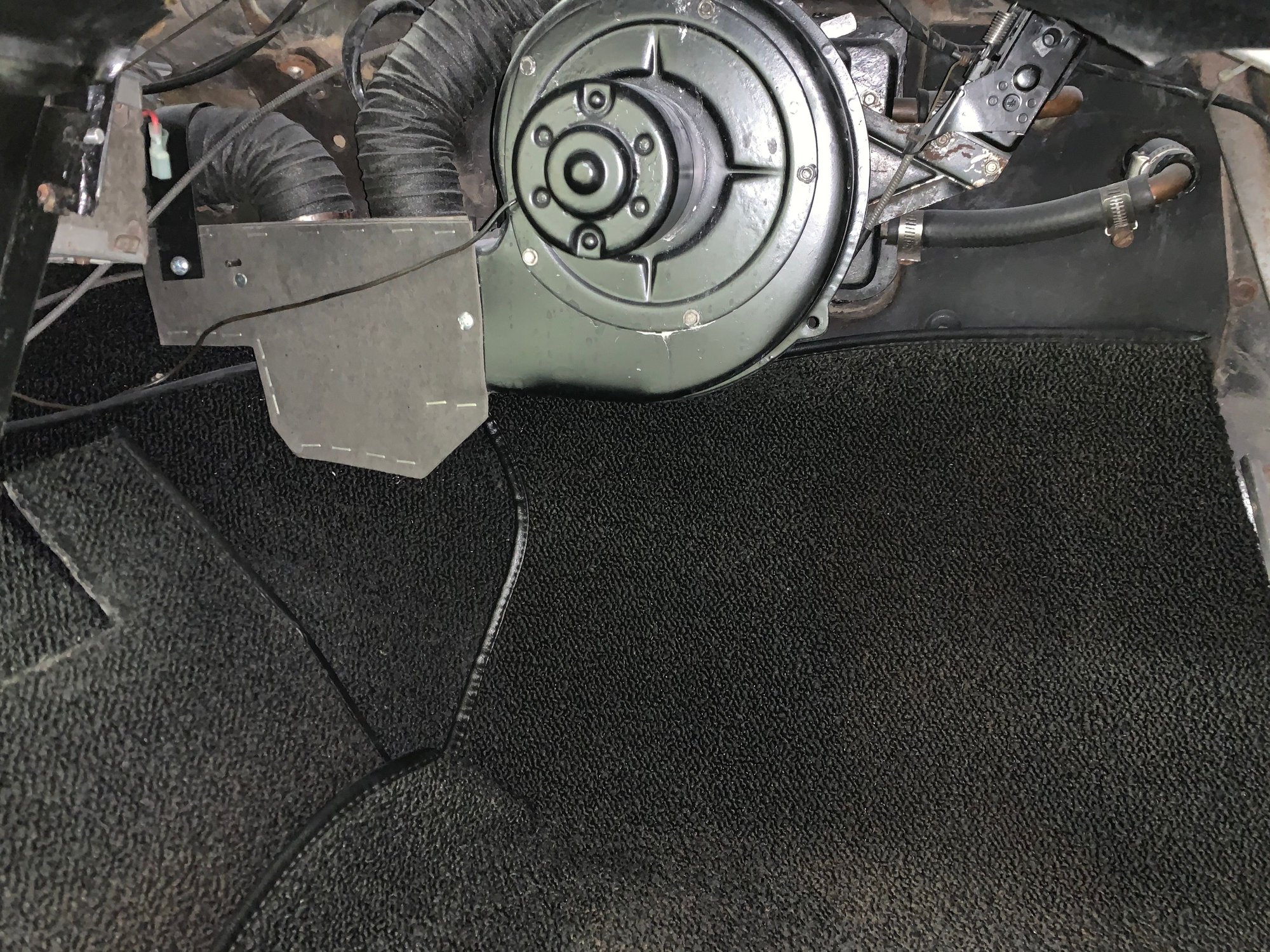

Carpet is in. On the passenger side can someone help me with the assembly sequence of heater cover, package tray, and kick panel. I would think the kick panel goes in first and captures the carpet but need help after that. Pictures would be great. Thanks in advance! Mike

It's been a long time for me but I believe you need to fasten the heater cover to the kick panel then install them together.

That is the most efficient way as one of the mounting screws for the heater cover needs to go into the kick panel....the package tray is last with particular attention paid to the right hand mounting setup.....its actually two brackets connected together to make one...

Thanks guys. I'll give it a try tomorrow. Mike
