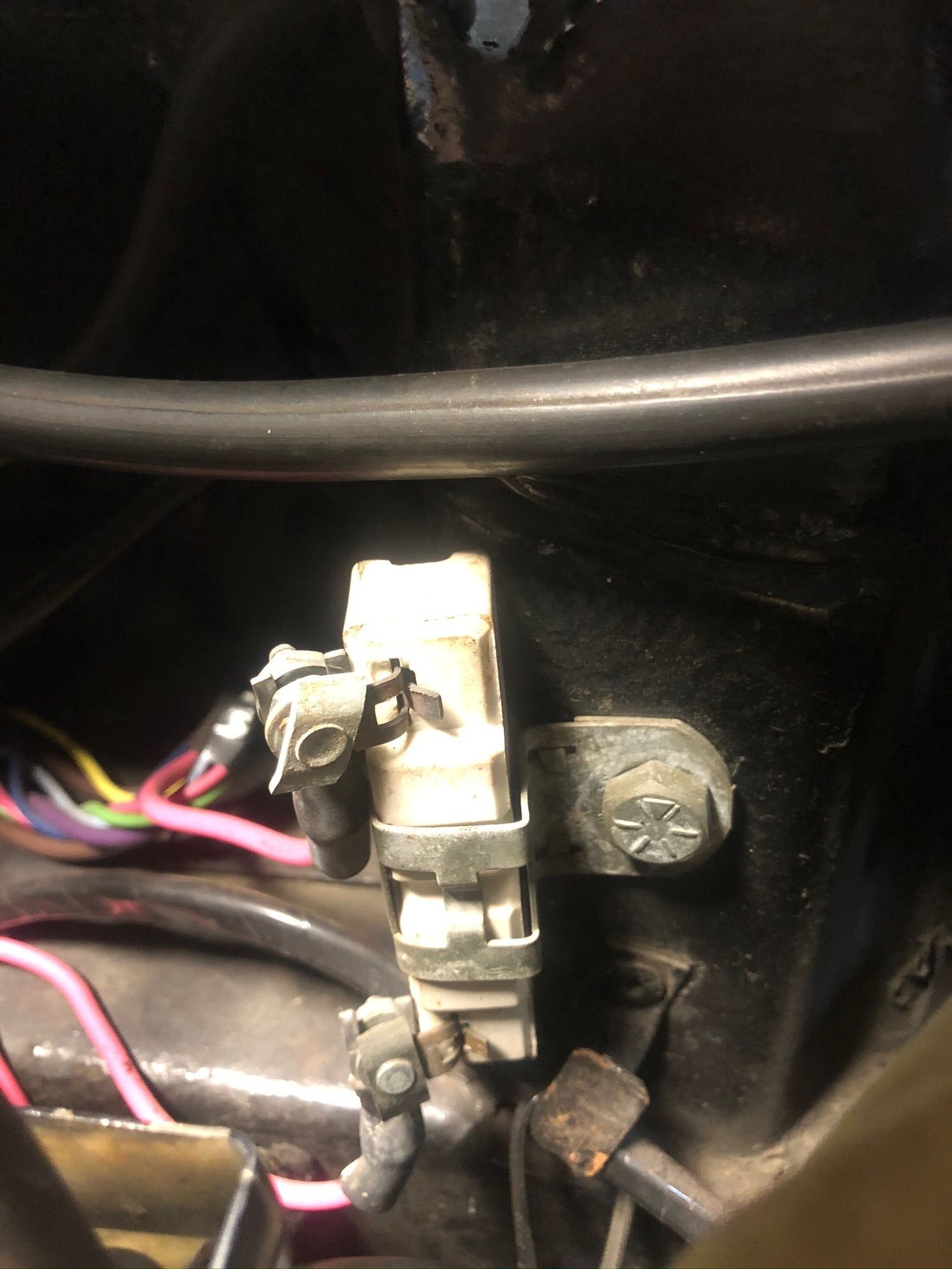

I have a 67 L79 with a Petronix in my distributor, I just installed a flamethrower 1.5 ohm coil, they recommend to bypass the resistor, if I remove the two red wires and join them together would this cause a problem. Ian

No it wouldnt, just insulate the connection.

Thanks for the response, going to bolt them together then heat shrink over the connection.ian

Connect em both on the same side of the resistor and save having a loose connection that needs shrink tube or other insulation. The resistor is a good terminal block.

Agree with Avispa, move either wire to the other end and put under same screw as other wire. Safer and cleaner, more original looking.

I just ran a jumper on the back of the resistor to invisibly short across it. Not a double E but I stayed at a Holiday Inn Express once.

Great idea to just bolt them to one side of the resistor, all good and it’s working better than my Delco. Ian
