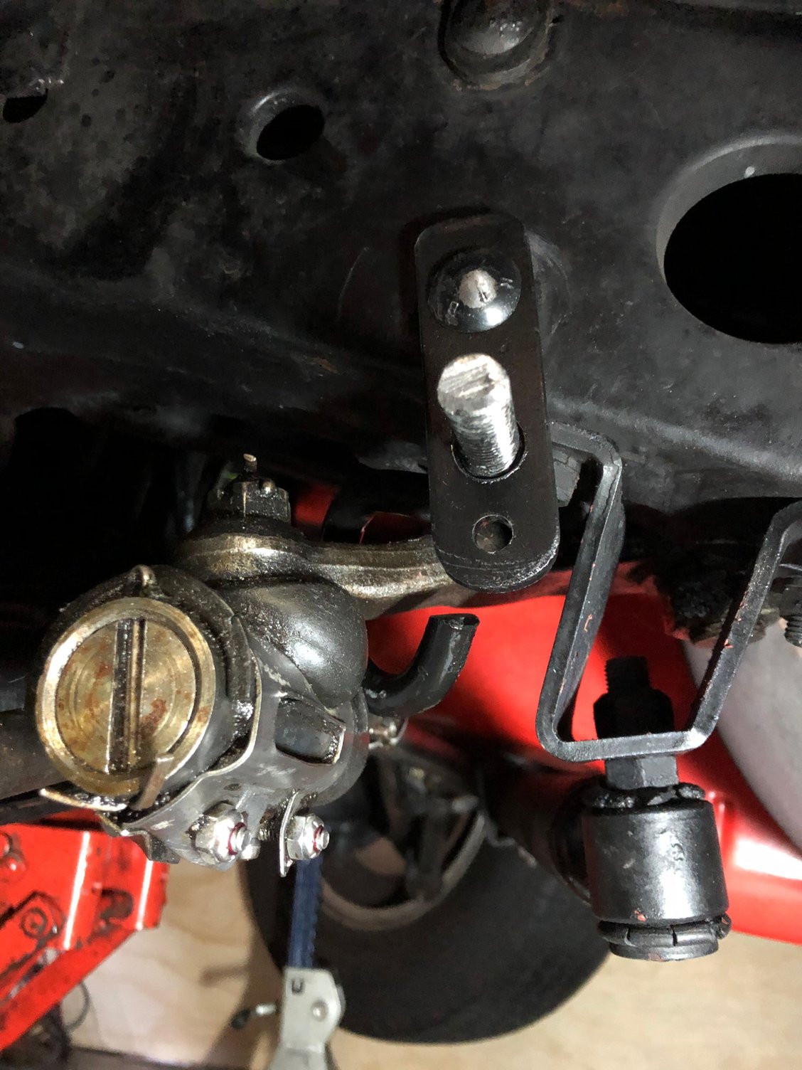

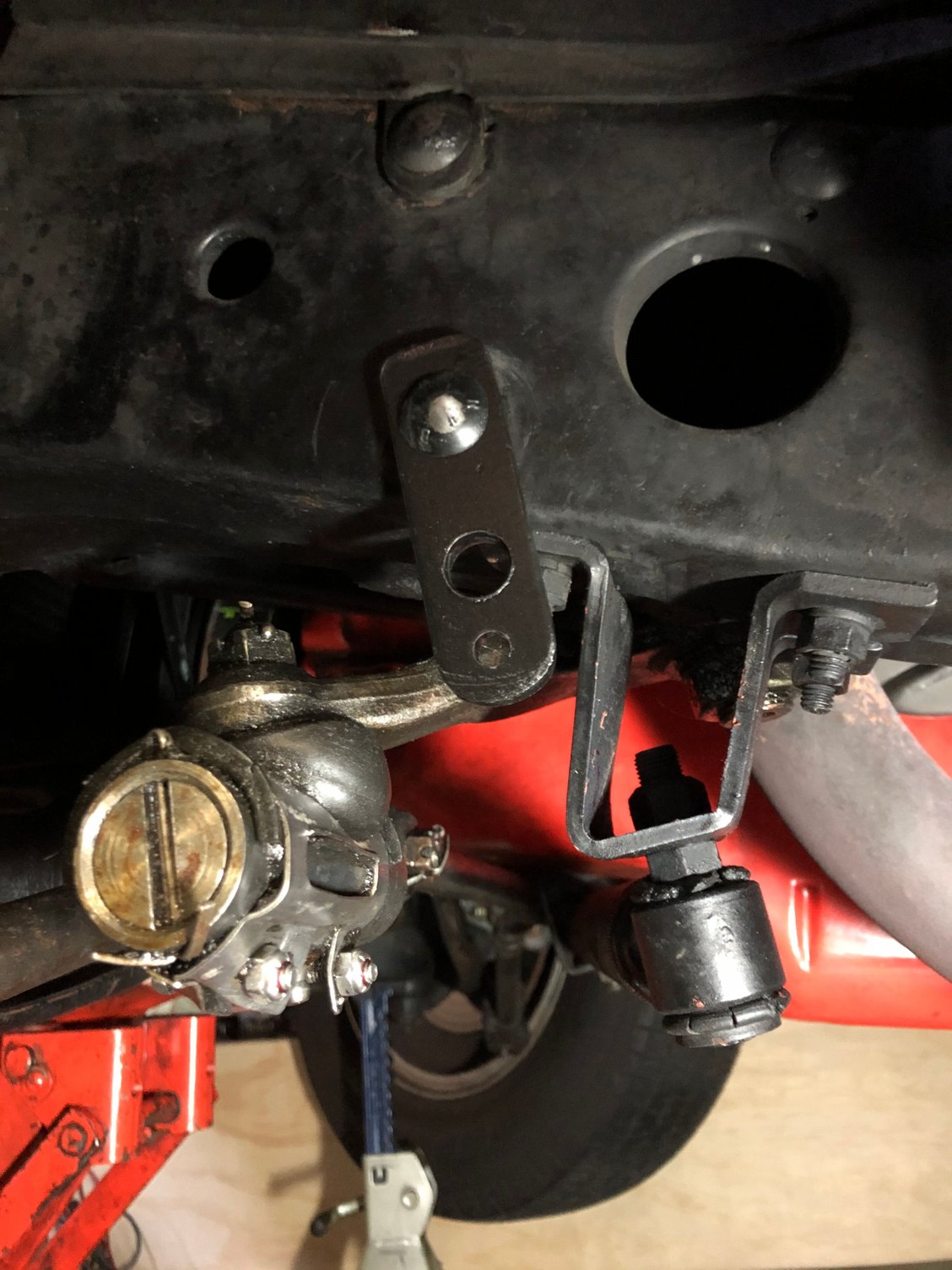

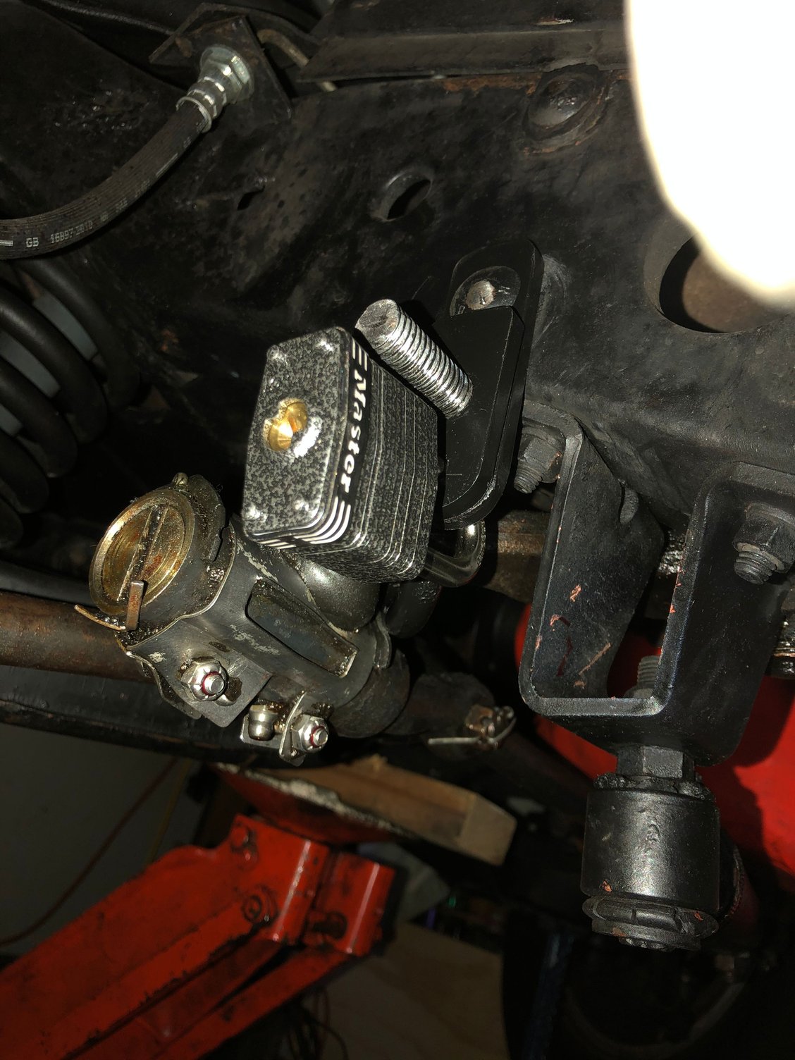

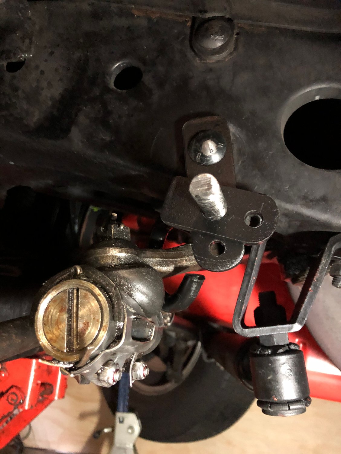

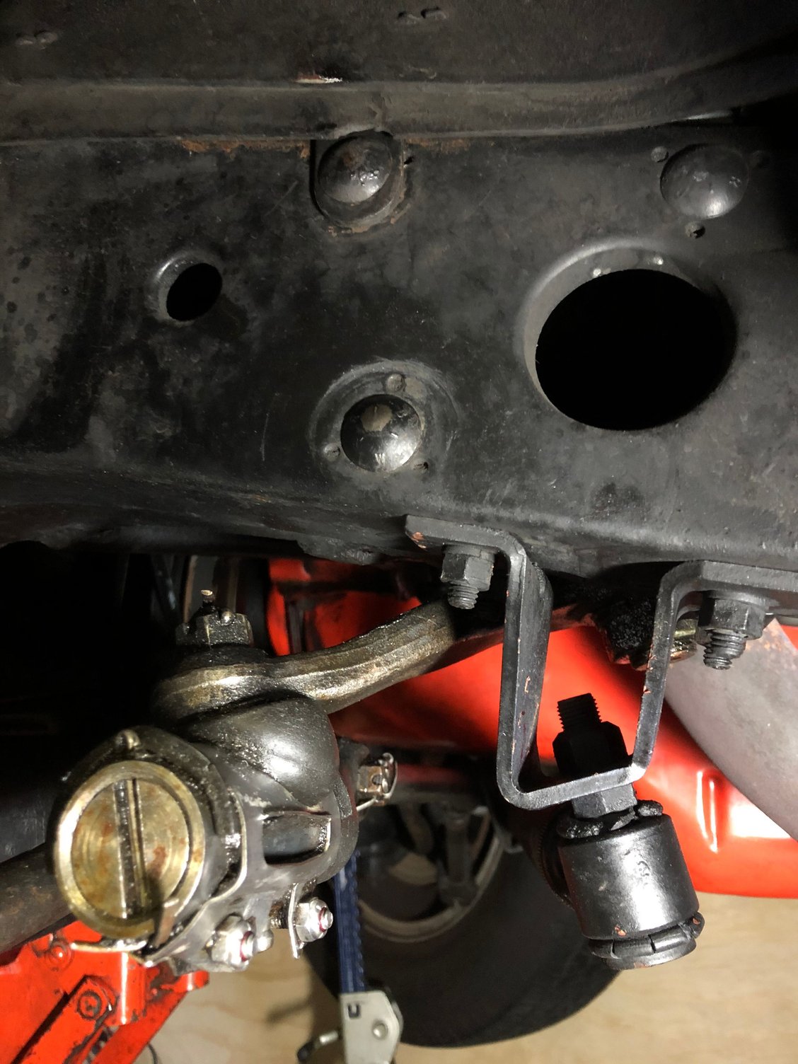

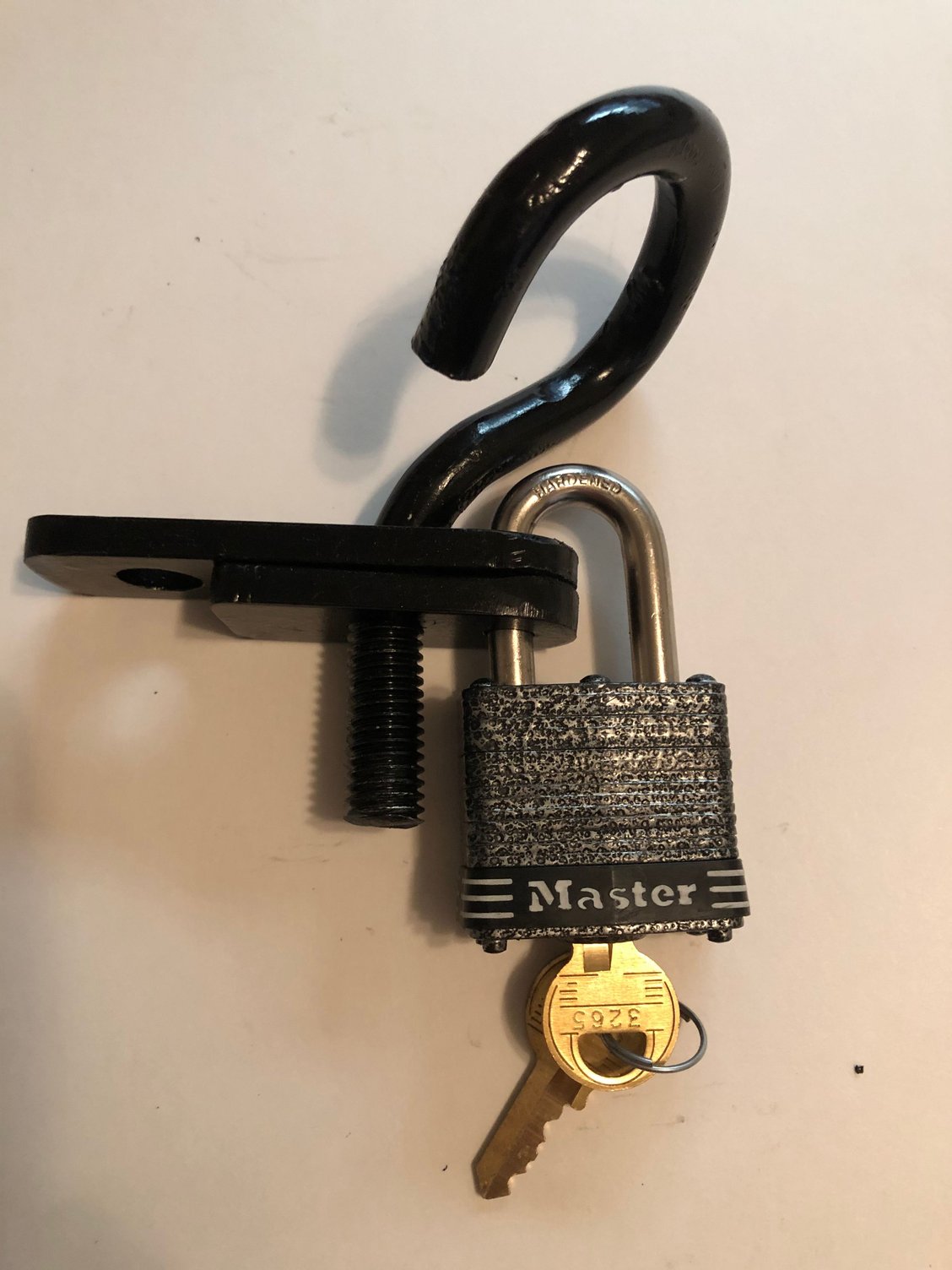

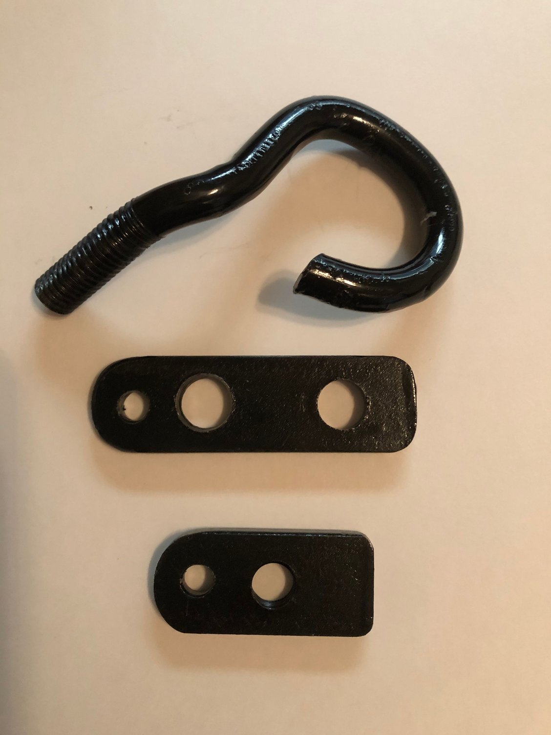

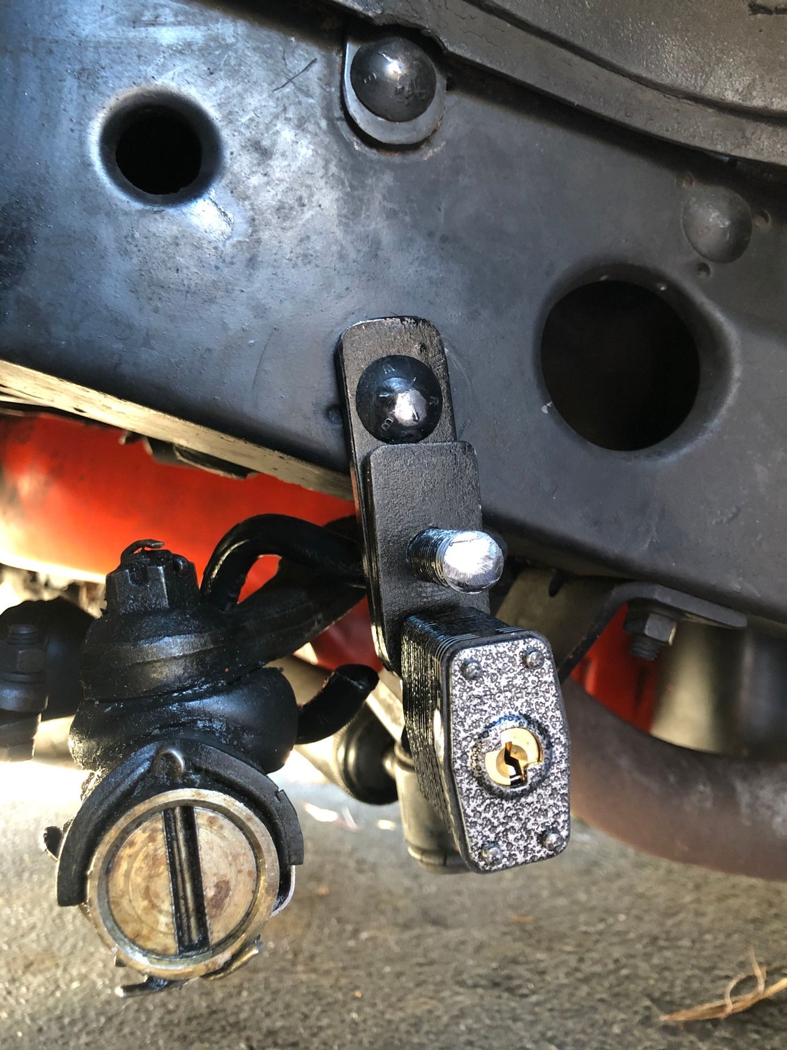

In the ‘something to do department’.
With all the rain going on here the thought to add a bit more security for overnight motel stays with the ‘64 came up.
The parts:
parts together as a unit:
frame piece mounted:
round ‘hook’ eyebolt with threaded companion piece:
lock in place:
The frame piece is secured in place with the lower steering box through bolt. The hook piece is a 1/2” round threaded modified eyebolt.
The flat stock material and lock were already on hand. Total cost around 3 bucks.
The idea (with the wheels on the ground, of course) is to have the front wheels positioned all the way to the right, then access the gap opening between the left front wheel and body to install the hook, threaded piece and lock with one hand using a needle nose locking plier.
Needless to say the acid test is gonna be being able to place a towel and lay on the ground to get it done......and get back up!
Not sure how that will go but if it doesn’t work out, no harm no foul, the frame piece comes out.
Next couple of days should be dry.......I think!
John

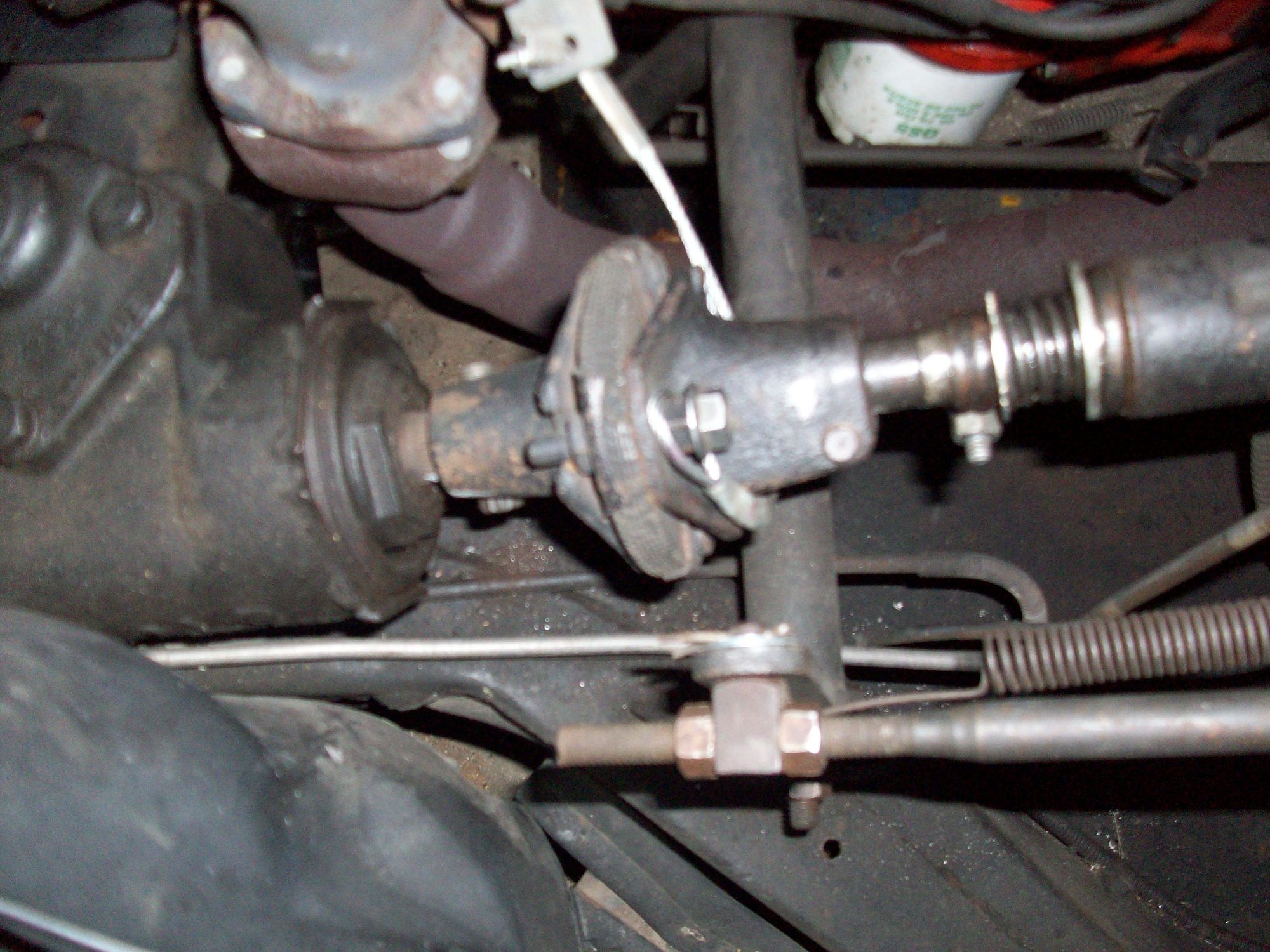

Looks like it will work if the leverage from the steering wheel is not enough to bend your eye bolt. Kind of a PIA to install and remove, but for you young guys, no big deal.
I got caught up in the OMG someone is going to steal my C2 virus when I first came to this forum. Yea, locking hood, remote alarm, dual hidden kill switches, battery disconnect, motion alarm, Wi-Fi tracking device, steering wheel CLUB, etc. My wife says I worry more about losing one of my cars than losing her. Hmmmm, have to think on that before I answer, the penalty for the wrong answer could be severe.

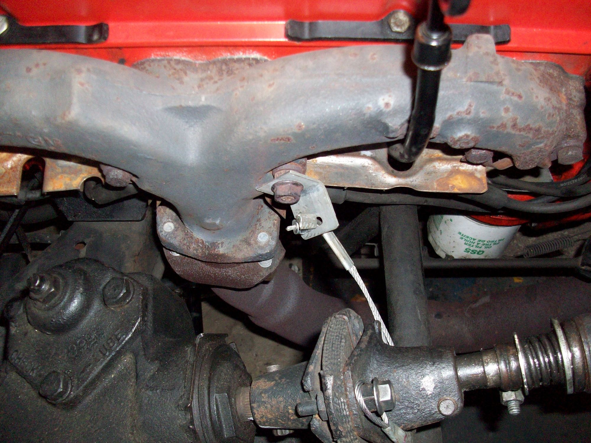

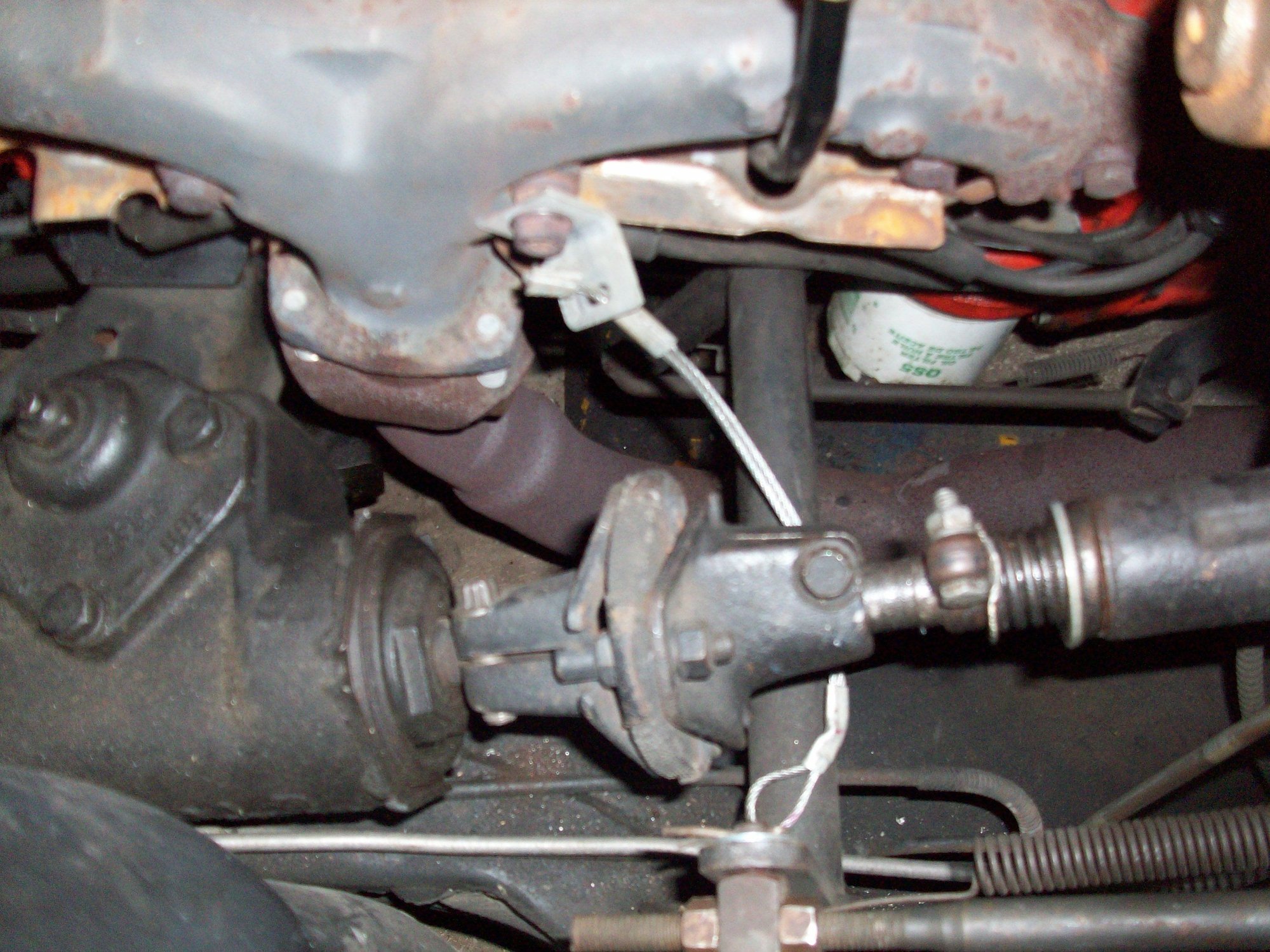

Any way, I put a little double 3/32" aircraft cable on a bracket bolted to the engine (could be bolted to the frame or other location) and the other end is slipped over one of the bolts on the steering coupler. I used a flanged nut for keeping it in place. The steering wheel is turned all of the way to the left prior to attaching the cable. Kinda BUBBA, but I know I am related to him somehow.
This only works if you have a locking hood. Mine is simple and used a electric door lock, however I also added a mechanical override. I had a post on it that didn't draw much interest.
Just a though if your lock doesn't work out. NOTHING is going to stop the professional thief and I haven't yet found a motel clerk that I would depend on to perform such a daunting task as monitoring my car for $$$PEANUTS. He could likely be the spotter for the thief.
Photo #3 - installed - Won't work if Godzilla is at the wheel and breaks the cable or 3/8" bolt, but I also have a 'CLUB' on the steering wheel that they will use bolt cutters on.
Photo #2 installed - Wheels turned fully to the left and cable loop installed over the bolt in the coupler and then the flanged nut installed. I found the nut is not necessary, but not much trouble.
Photo #1 - uninstalled - Cable bolted to exhaust manifold bolt hanging loose. You might come up with a better storage method.
I can't seem to get the pics sequenced right, but you get the idea. PS, the steering connection has been repaired - the PO BUBBA really screwed that one up.
OH YEA, after much thought, I think the wife is correct - as always.
Ron

I know you’ve mentioned this before about parking the car in front of the motel with behind the counter eyes monitoring the prize. Sounds good, I like the idea.
With respect to the steering lock, needless to say a determined thief will find a way to snag a car. The idea with this makeshift steering lock is to slow down or thwart a possible roll back attack.
Parking the car in a way where obstacles (pole, light standard, curb, other cars) get in the way ups the difficulty factor.
With the nose of the car parked forward and not accessible from an open area so the front can’t be accessed, it just seems a perp will have a difficult time dragging the car from the rear with front wheels fully cocked to one side, then onto a lift bed or positioning the car for an old style front end lift tow.
If a perp did gain access and try to turn the steering wheel against the hook I feel the steering gear would not be strong enough to overcome it. It takes some decent leverage to bend 1/2” round stock.
Whether or not the steering lock is feasible to install (laying down on ground, installing pieces, getting back up) I’ll try it out on Saturday. The weather looks to be clear and dry for a C&C drive.

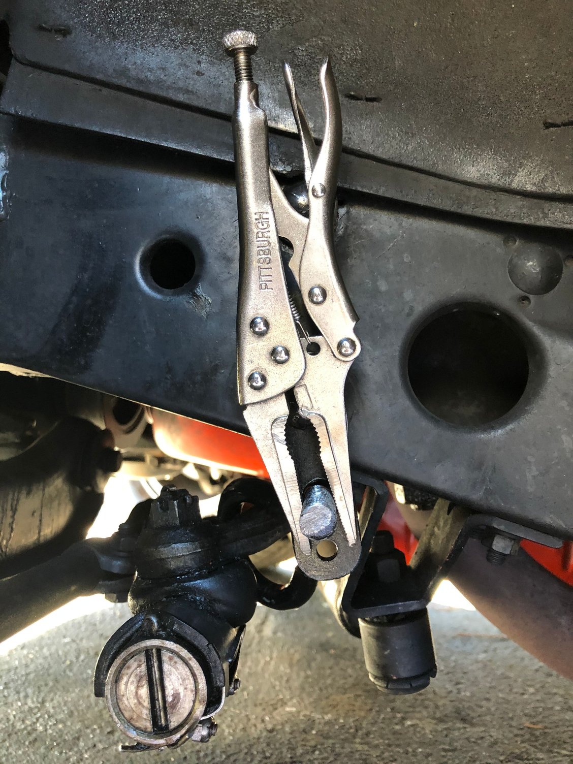

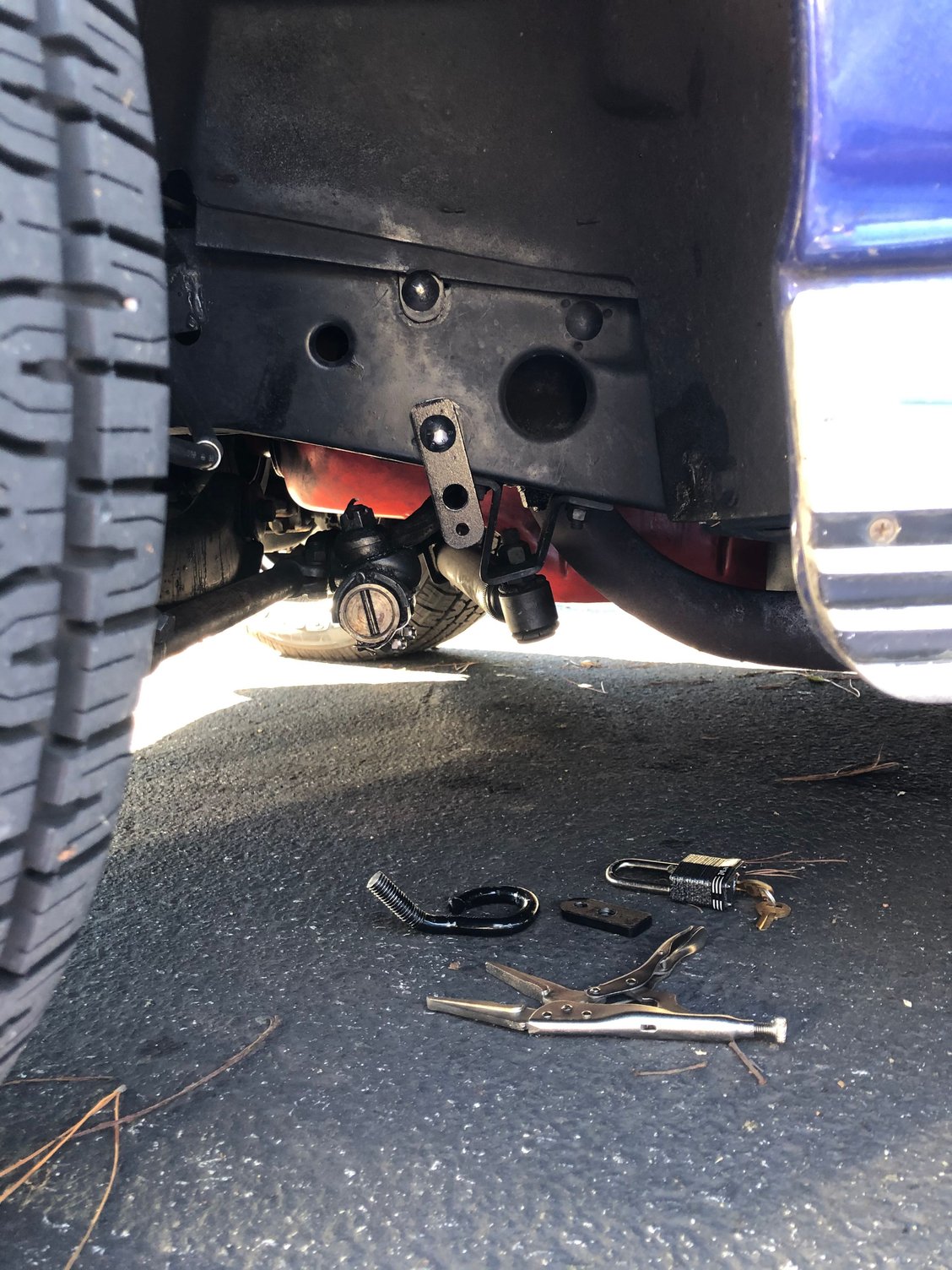

Follow up:
The pieces after laying a towel on the ground:
Hook piece and cheap needle nose locking plier to hold in place:
Threaded piece and lock installed:
Lying prone on left side and parallel with car body the open space between wheel and body allowed easy access to install the pieces with arm extended. There's enough room to comfortably use both arms to further ease the process. Installing the pieces went easier than I thought it would. Time it took to install pieces was 2-3 minutes.
John

The front wheels pointing very right is noticeable. If that is missed backing up with unresponsive steering should do it.
