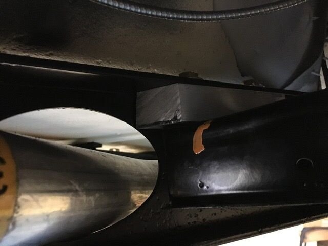

Originally Posted by racefan2
Shimming the transmission crossmember down to improve driveshaft angle should improve your fan clearance problem. I would check to see what spacers, if any, are being used on the crossmember.
I agree. I used a 3/4 bar stock to shim my transmission cross member, it helped my driveshaft angle. I bet it would help center your fan in the shroud.
I’m running a Muncie transmission.
