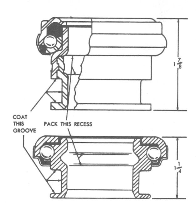

What is the TO bearing for a Corvette. Why a difference?

Corvettes use bent-finger diaphragm clutches and a 1-1/4"-tall TO bearing; passenger cars and trucks use flat-finger diaphragm clutches with a 1-7/8"-tall TO bearing. You can't intermix the two.

Short throw out (clutch release) bearings were used in other GM cars also, not just Corvettes. At least this is what I have found in the past half century of playing with cars. So, don't go to the parts store or call up the vendors asking for a special "Corvette" throw out bearing. At best, you might get a laugh out of the salesman, at worst, the price may be Corvette "Triple Gold".

In the C1-C3 era Chevrolet brand (including Pass cars) cars, there were actually three different length throwout bearings.
'55 Corvette, first design used 1 7/8"
'55-'63 Corvette, second design used 1 1/4"
'64-'69 1 7/32"
I'd list the Pass cars but this is a Corvette forum. Used to be when you bought a clutch for Chevrolets in the above years, the parts guy would always ask you what length throwout bearing you had in the car.
