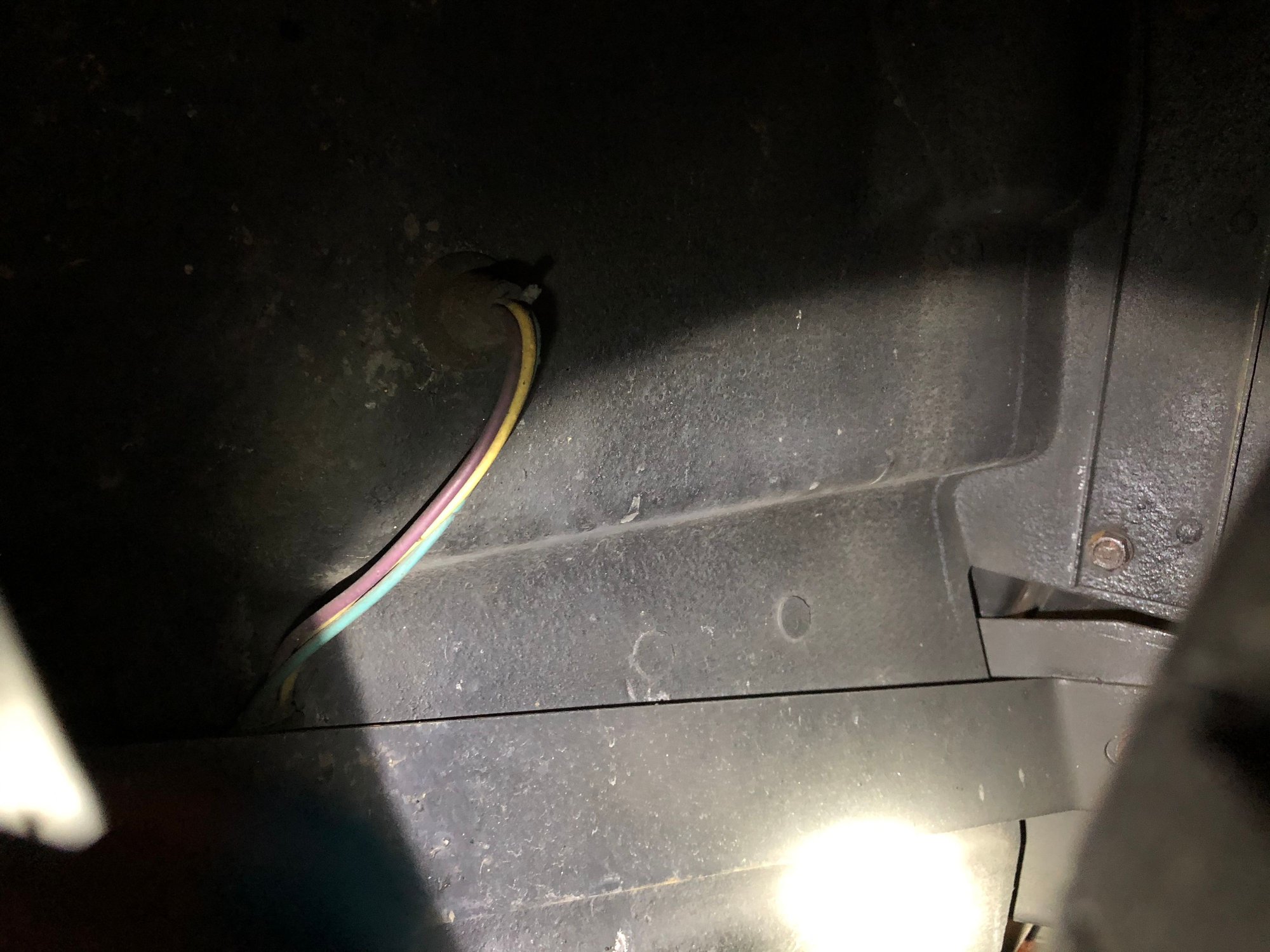

Hi, I am to put new grille mounting brackets on the inner fenders how is correct mounting of the rivets? from inside fender and out or from outside through the brackets?

The rivets are placed from the back/wheel well side and peened over from the front per my original '67. See attached pic from the wheel well side.. Dennis

Thanks, on the picture there is a bracket on inside wheel well . that's why you don't see all 4 rivets?
I do not have that bracket I think?
should it also be a rivet from top of inner fender through the hood hinge reinforcement (between the welded nuts?

that's the bumper bracket, you should have that if you have front bumpers.
