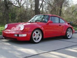

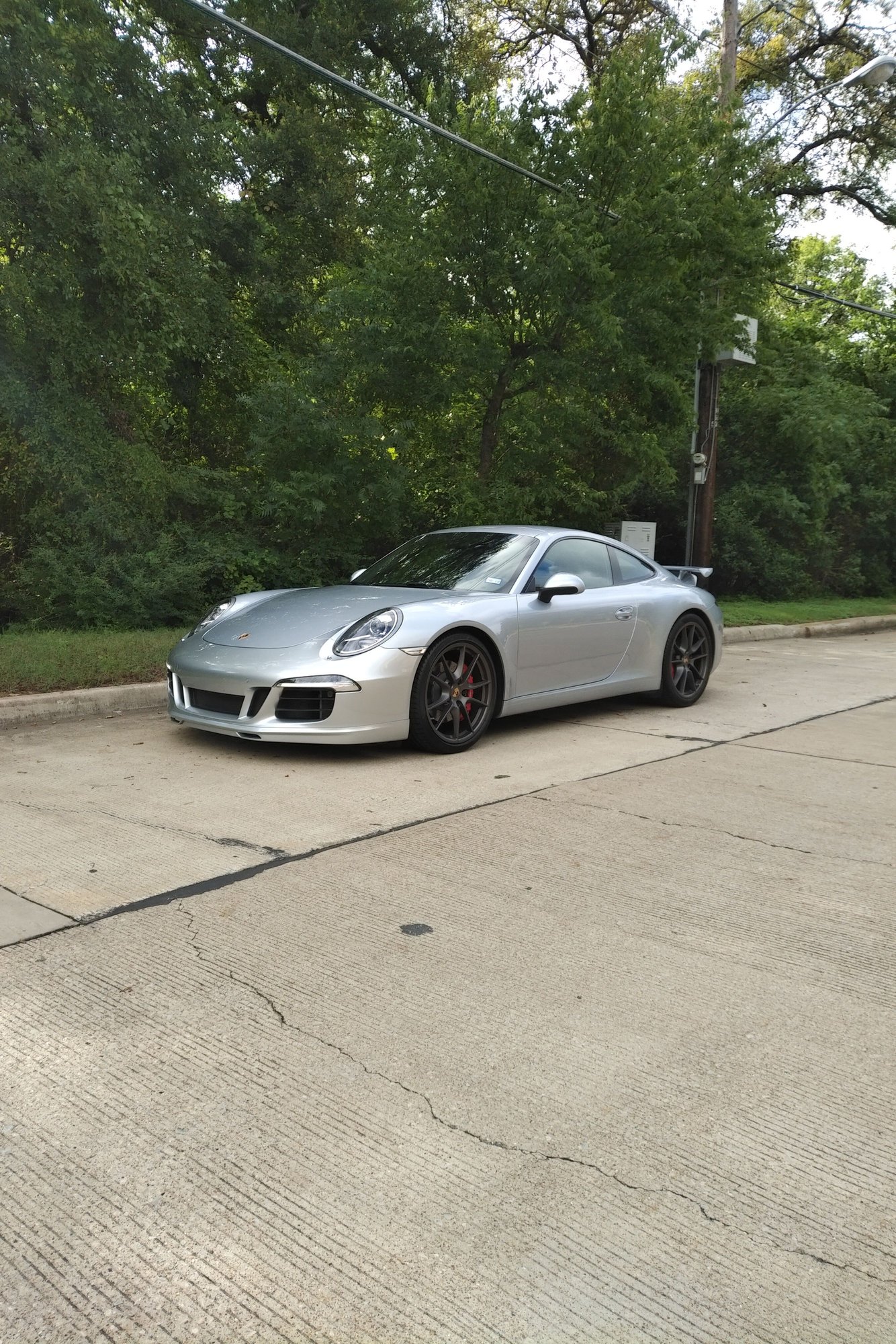

Originally Posted by kolsen911
Steve, what year 911 do you have?
I have 2. A 91 turbo and a 14S.
