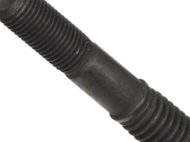

Look at the stud where it meets the boss in the head. If it has been replaced with a screw in stud you will notice a ring around the stud. If they tapped it crooked there's not a lot you can do with the head still on. If it is mostly only tilted towards the exhaust but still fairly parallel in plane to the other studs it wouldn't hurt anything. Your worst case scenario is it's out in that plane and could possibly cause the rocker arm to rub the side. If there no evidence of that from before I would say you are good to go. The stud just holds a ball as long as the rocker tip is aligned with the valve bolt it up.
If you have a bent stud just stack several 3/8 washers or a larger nut under a 3/8-24 nut and pull t out. You can buy a replacement from pioneer. Do not install a +.003 unless it already has one. You would be able to see it's a little larger where it presses in. To reinstall put a sacrificial nut on the stud with the stud just below flush put some red Loctite in the hole and drive it in to the same height as the others.

I don't know how to post pics via pm so here goes. Look at this stud you should see the top of where it meets the boss if it has one. Then this pic shows what I was talking about pulling your stud with washers. After you pull it a bit then you'll have to add more washers until it comes out. This is an easy job no need to remove the head. If you can post a close up pic of the stud boss I can tell you which you have.
