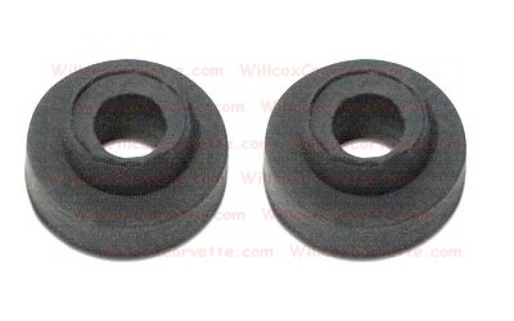

The grommet for the power stud was made on the original borg movement. it's not something that is available but you may be able for find something that will work. If I had to take a stab at something that will work it would be the speedo mounting grommet. GM didn't use any insulating grommet on the two mounting studs for the clock, the clip was a tension clip that held the clock in place and didn't require a grommet.
https://willcoxcorvette.com/corvette...cushions-53-82

Never mind... they won't work.
I just took an original movement apart and the ID of the hole is 9/32. The lip(o.d.) on the speedo/tach grommet is is the same so you'd loose the insulating lip if you tried this part.
So.... If the insulating grommet for the power stud is what you need, I've got a plenty of used here that'll work just fine. You can email me at Service@Willcoxcorvette.com I'll fix you up with one.
To replace, you'll have to lift the grounding tab and rotate it out of the way, remove the old grommet and then install one.
