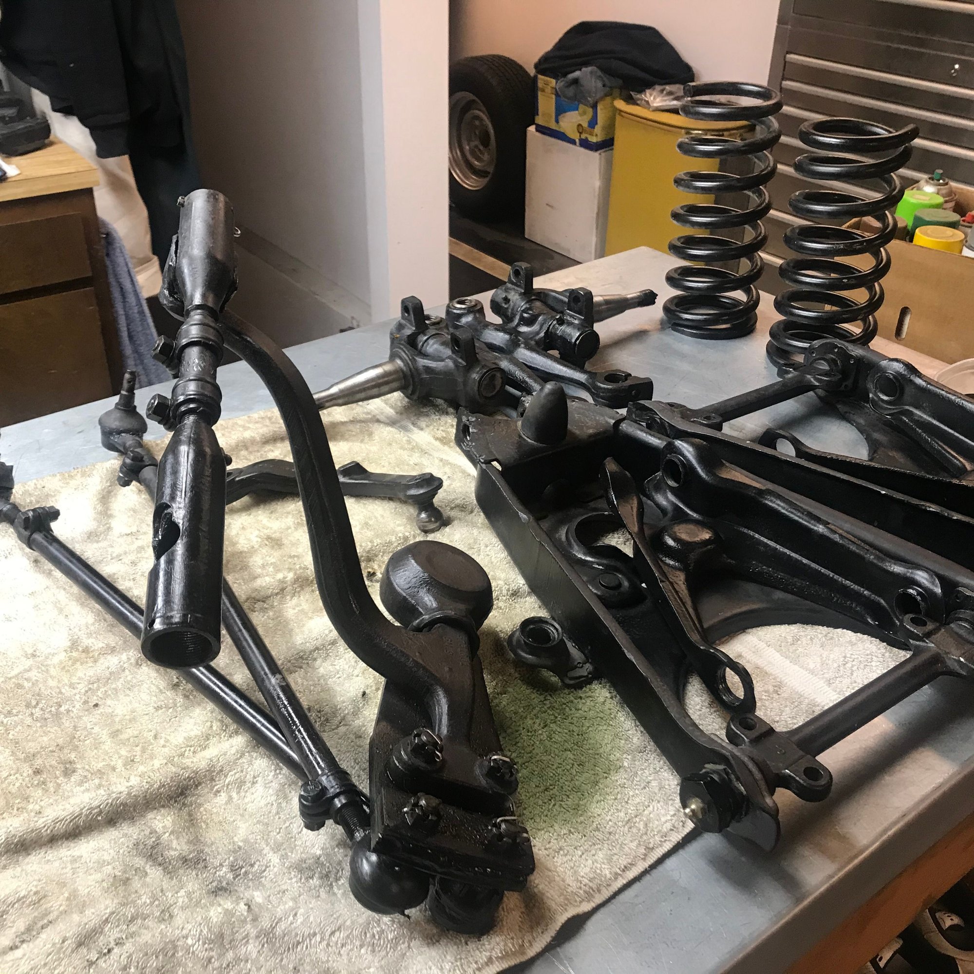

The steering box is out and in the repair shop. I was unable to get it out of the car - working alone - without removing the hood. Looks like the steering box had some play in it probably causing some of the slop. Other things that could contribute to poor steering was the lowering of the car by cutting the springs - unbelievable what someone would do. Knowing how the geometry is affected by cut springs it seems to me if someone wants to lower a car dropped spindles are preferred. As mentioned earlier I like stock height cars but somewhere in this cars past it was lowered. Buying a used car is like adopting a child, its history is sometimes unknown.
I've removed all of the suspension; A frames top and bottom, knuckles and spindles, looking for warn out parts, I see nothing of the sort. With new springs, new seals in the A frames, an overhauled steering system and correct geometry I'm hoping for a better driving car. Here is what it looks like with the front undercarriage removed and the parts on the bench... Al
