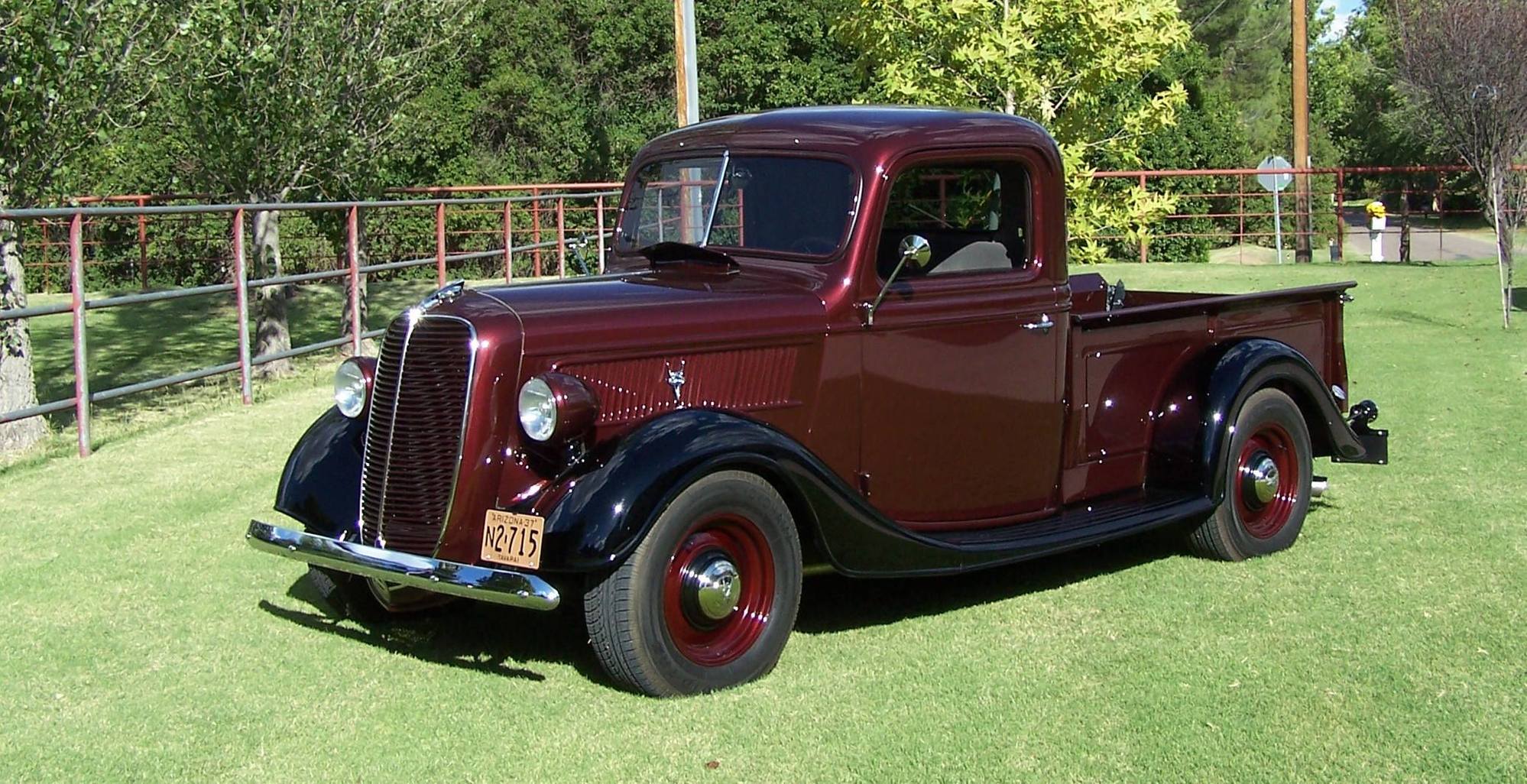

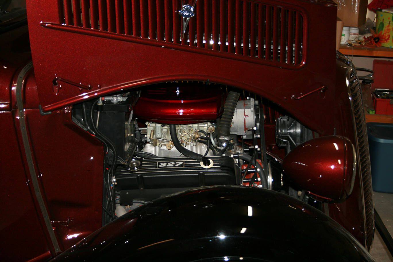

I added remote solenoid to my 327 Chev powered '37 ford pickup, but it was more for making a good location to run a bunch of power wires from, and remove the smaller wires from the starter, than anything else.
You can see the solenoid at the left rear corner of the valve cover
Doug
