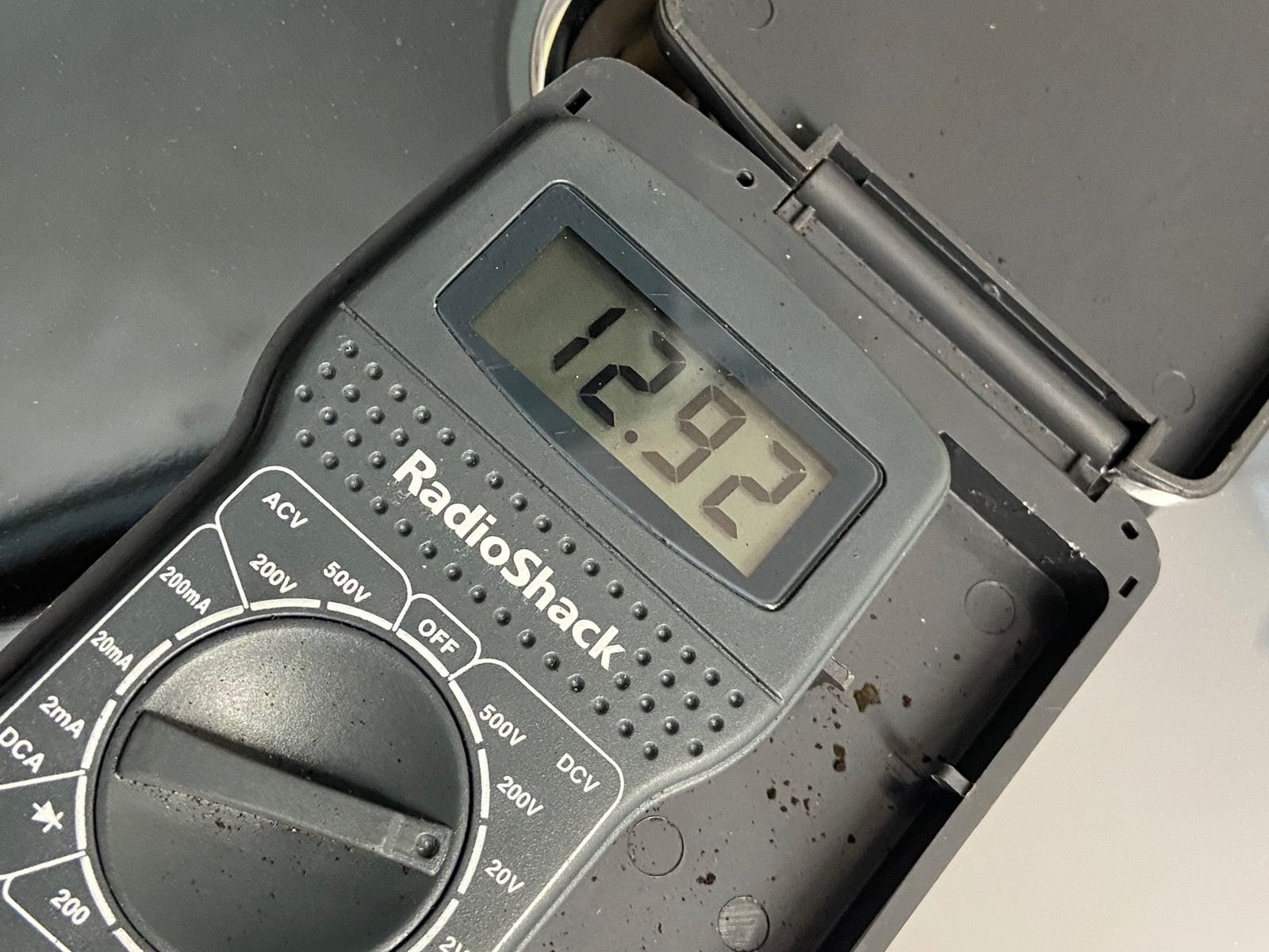

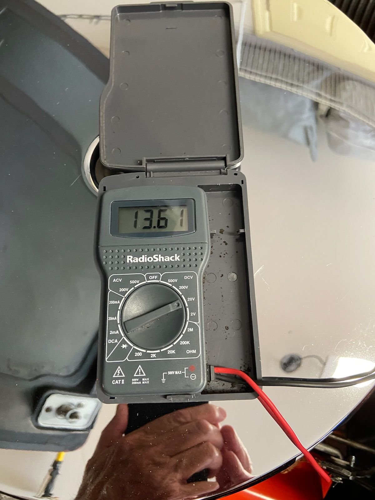

I may have nothing to be concerned about. Here are the voltages at the battery running and off. Must be because I keep the battery tender on all the time, the battery doesn't need a charge.

I'm not a generator guy, but those voltages look good to me. I don't think you have a problem.

If you run the car at a fast idle and see the voltages (or even a bit higher) in the first pic then you’re fine.
