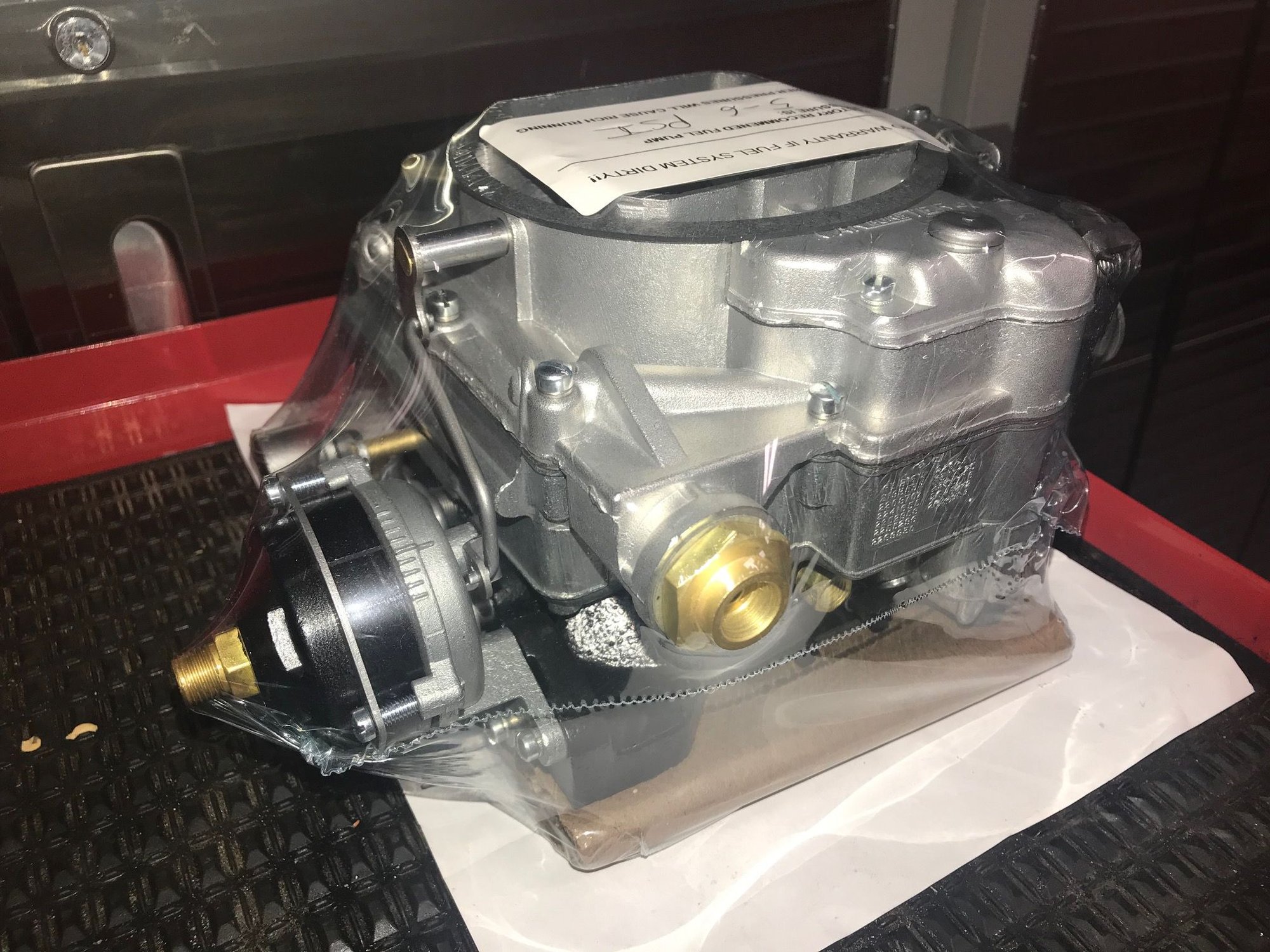

'56 through '61 had the high chokes on dual quads....
63 and later C2 carbs had the low choke and the brass air vent tubes were eliminated:
I've rebuilt a few (dozen)

And here's a real oddball I mentioned above (finally found a picture of it), a 1956 El Dorado dual quad setup with two chokes:

Frankie; That plastic wrapped 63 WCFB looks like a "Daytona" work of art.. Please confirm...
Aloha,
Rene
Yes - a Daytona complete restoration...
