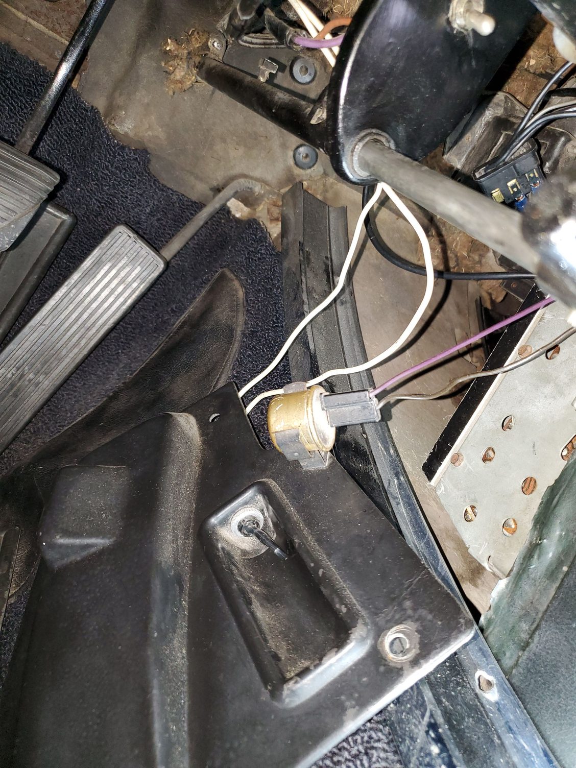

Default Help identify another switch
Switch is below the flasher on the console side panel.

Had a 66 many years ago with a switch under the dash near that location. It was a kill switch.

Appears to be added. Chase down the wires and find where they go...

Approximately where the power antenna switch would be mounted.

That side panel is from a 67 corvette for the vent cable.
^^^^^^^^This, switch is an add on, not factory.
Yes i agree, was just pointing out the side cover is for a 67 not a 66 side plate.

My car is a 65. Somebody must have added a few incorrect things along the way.

It happends, nothing that cant be changed back.
Tracked it down. It was a wire leading to where the left horn was located. It ended with a connection that at one time in the past had an extra radiator fan. There was a piece of tape with electric fan written on it. I have eliminated the wires and switch.
