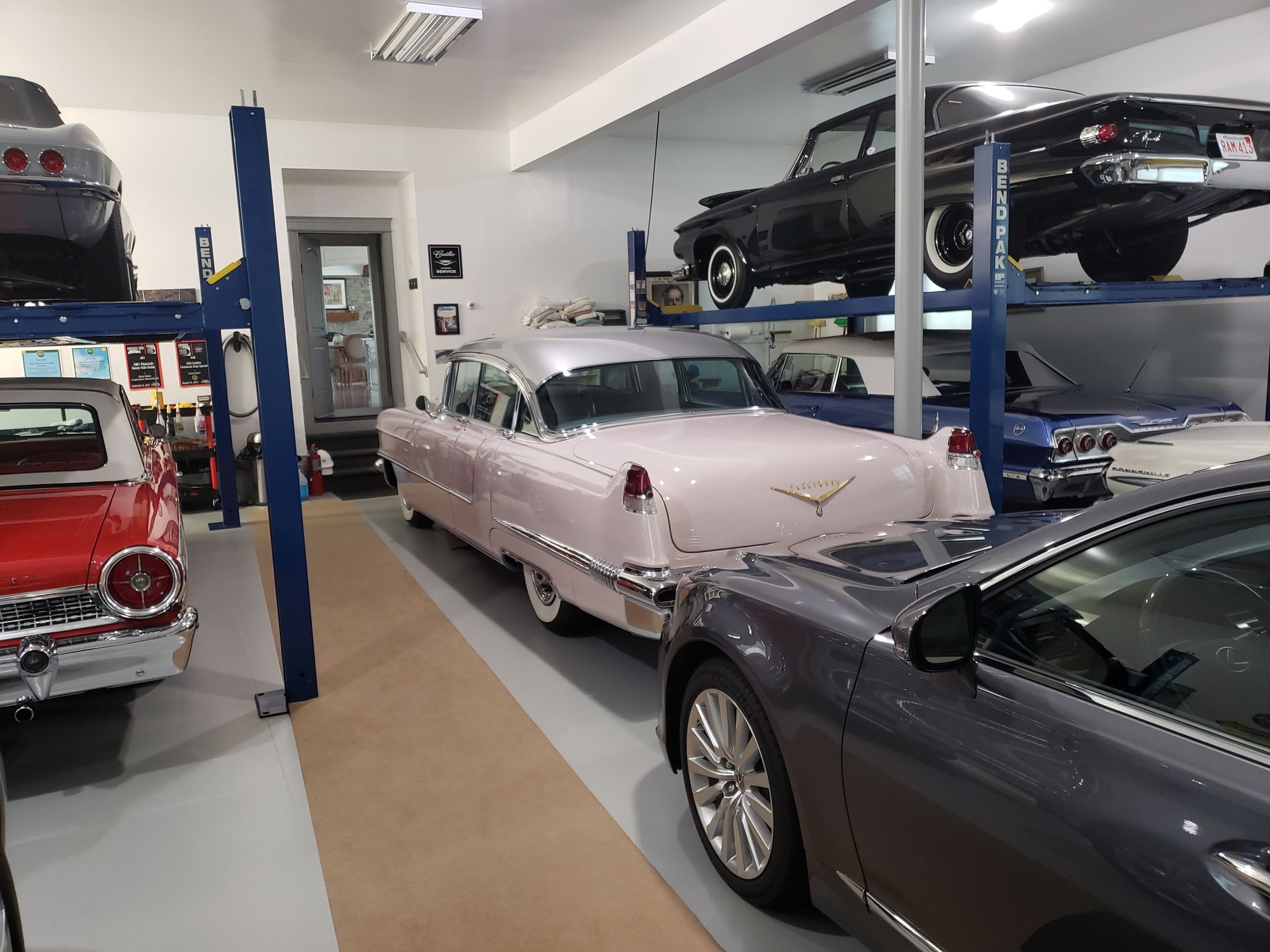

I'm sympathetic to the mop or at least the use of one. I avoid them. I did this garage in epoxy just for that reason. Only thing that can hurt it is battery acid. It makes cleanup easy but mandatory. With a garage like this you can't leave oil, ATF, gear lube, coolant and stale gasoline laying around. It's unbecoming. Back when I was broke and had only my 63 Impala in a 1 car garage with a cement floor I never even looked under the car. So much for success. Now it's, "holy **** there's some petro-olium on the freaking floor" and off I run for my spray bottle of 70-20 Simple Green and micro-fiber towel designated as such but which has been recently repurposed as a virus defence mechanism. So those spoiled cars of mine better fuc&ing contain themselves until this is over.
Dan
Dan
Nice Caddy, by the way, love the color. We used to have a car show at Cadillac engineering. Some of the cars that would show up were amazing, the early 30's V16 cars were spectacular...
