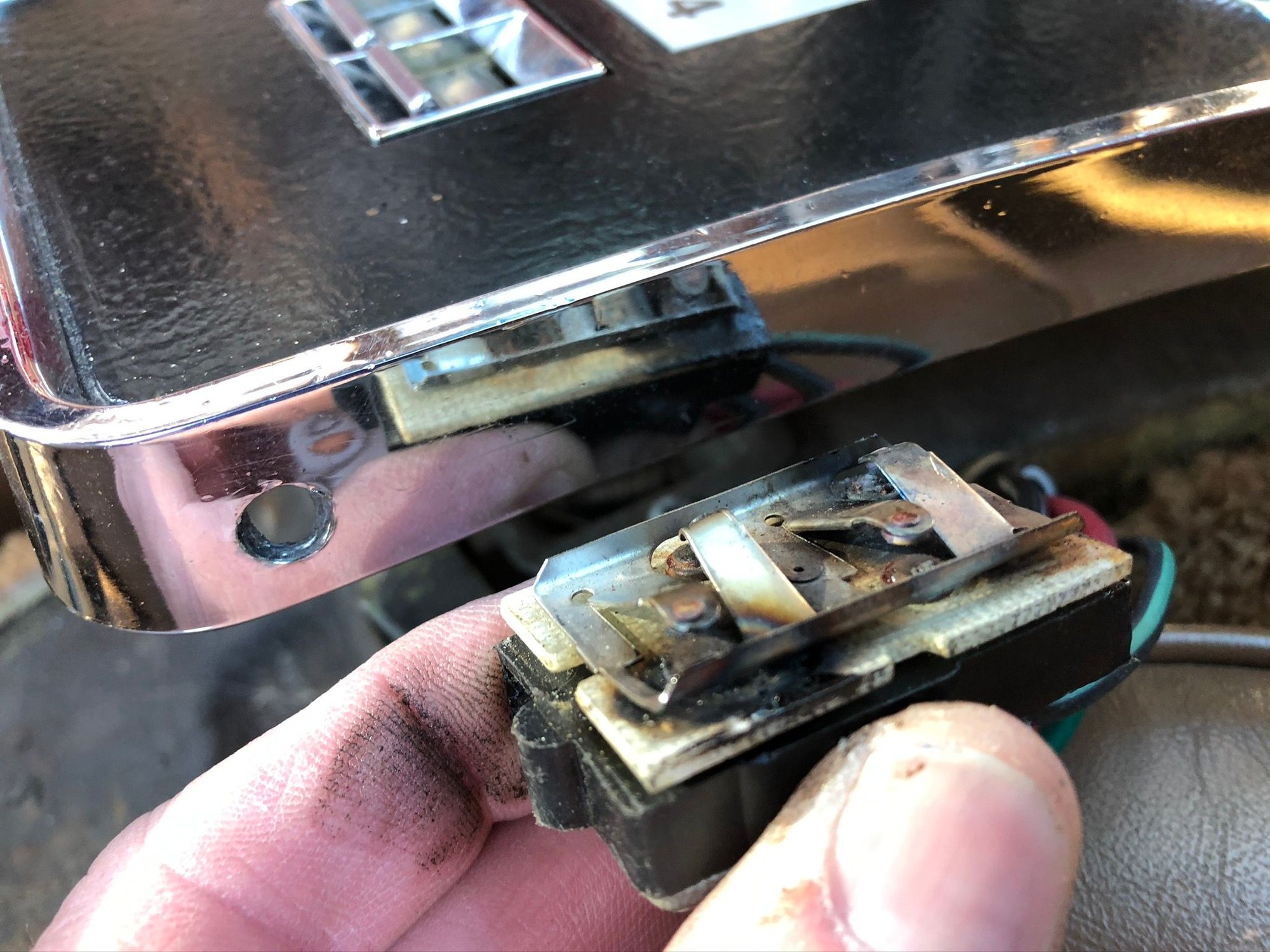

My car is a 64 coupe. Just before going on a drive last week, I thought I saw a wisp of smoke in the interior. The drivers side window was already down. A few minutes into the trip, I attempted to put the passenger side window down, but neither switch would work at that point. So I, “took apart the whole interior of the car,” and discovered that the switch and wiring harness were burnt. I ordered a new harness from Ecklers and cleaned up the contacts inside the switch case. Upon re-wiring the thing back together, I got a small spark when I tried to get the window to operate again. I traced the wire out of the (now removed) console, under the carpet and up into the dashboard. I cannot easily reach the portion of the wiring at that point, but believe there is evidence of some past rodent activity in that area. So my thoughts went to a few of the wires being gnawed through and causing a short. The likely solution at this point will be to purchase a new switch to compliment the new harness and hope for the best. I took several photos of the original switch/harness so I could see where to re-wire the new one, as none of the wire colors match one another. That could also be the problem. I really appreciate all of the feedback. I’ll let you know what happens.
Probably should have just ordered a new one, but it actually looked pretty good once I went over it with some sandpaper and a file.

Just an update on my power window issue. So it turns out that not only did my switch burn out (as is apparently typical with after market equipment I'm told), but the short also fried both of my motors located in the doors as well. I had my electrical guy trace down the entire wire run, including looms, harnesses and power supply tie-ins, and he found no problems. He also stated that in all his years (as well as his boss's), he has never encountered something like this. The problem has been rectified, but I thought I'd pass the info along so you'd know what can ultimately be happening should anyone experience similar difficulties.
Cheers, Henry
