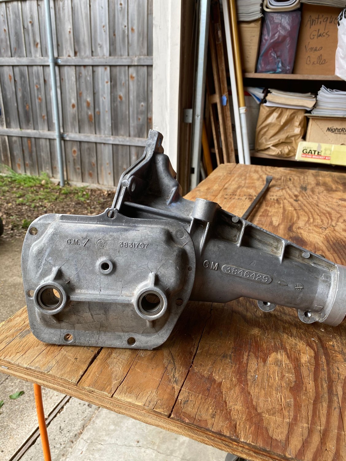

Oops! I fat-fingered it! My apologies. Are these the correct side cover and tail housing
for my 1964 Muncie 4spd transmission? I think these are the correct ones. I just want
to verify. Thank you to 66racer. He supplied the parts.

According to the Chevrolet by the Numbers book, both of those numbers, the Side Cover Casting Number and the Extension Housing Casting Number would be correct for a 1964 C2 Muncie and also correct for a 1965 C2 Muncie up until February of 1966. C.J.

Ok great! Thanks for the confirmation.

It’s a little low

That's what is on my Mar64 car, it's original stuff.
