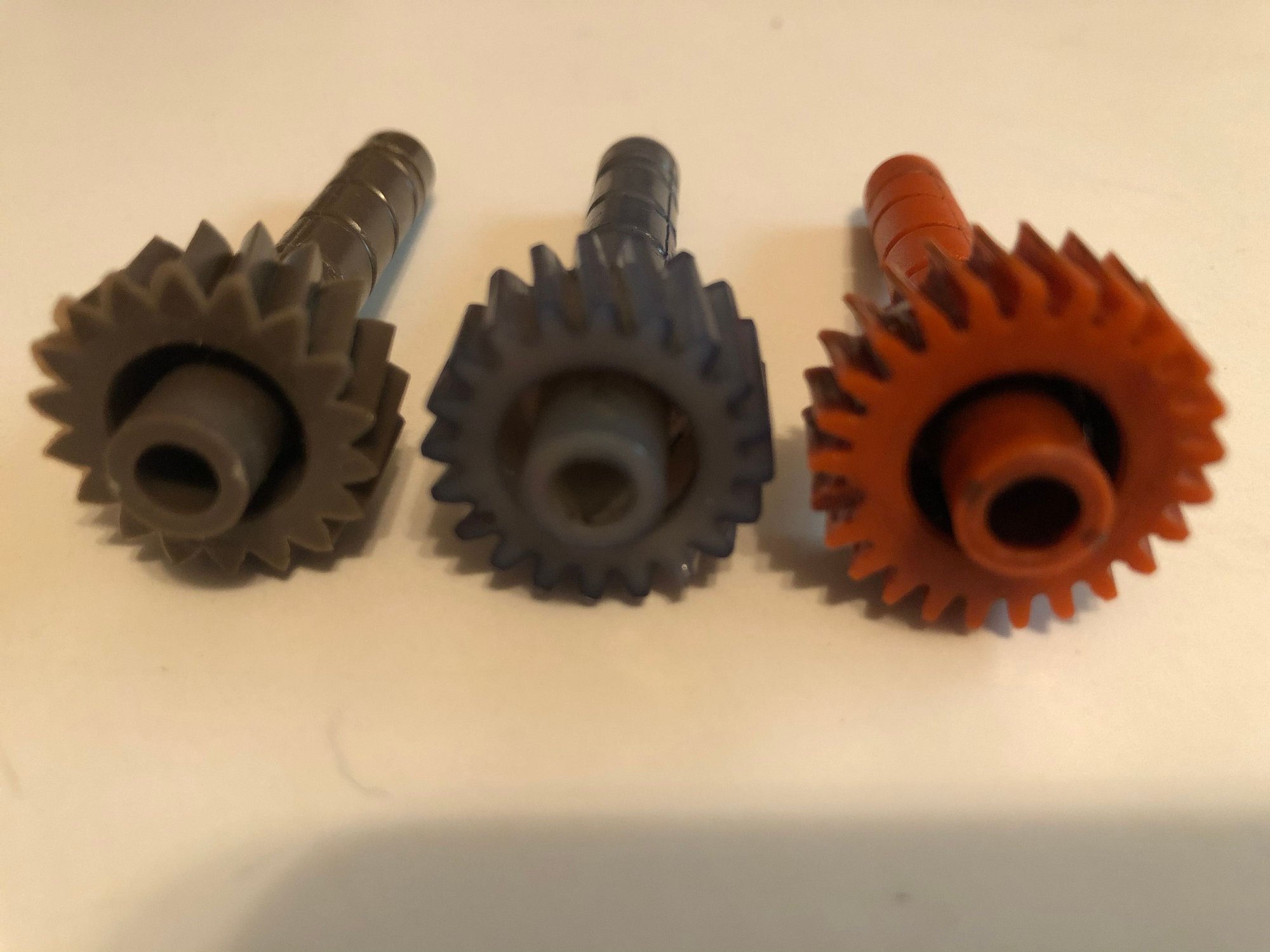

I just went through this on a recent Muncie fix. Before the pumpkin was changed out for a 3:08 the rear gear held 4:11’s.
At the time running the 4:11, I wasn’t aware of the different sized drive gear on the output shaft and how this was related to final drive ratio.
It appears my car originally came with a 3:36 final drive ratio. The only evidence was the blue 20 tooth driven gear that came out of the bullet when it was swapped for a ‘correct’ 25 tooth orange colored gear.
It’s been quite some years but I think I remember noticing the difference in size between the two driven gears but figured it was because of more teeth = larger gear. A duh moment that should’ve been a
clue!
Anyway, in goes the orange gear. The mph read out was pretty close........3000 rpm @ around 60 mph with the 4:11. The car was driven that way for years. Why the orange gear didn’t break or get chewed up I don’t know. All I know is it worked lol.
With the recent Muncie fix a correct for 3:08 brown driven gear was purchased. On a recent drive, cross checking with the GPS shows speedo reading 5 mph high. A step up to a 19 tooth driven gear would bring
the mph down (5 mph differential between tooth count) to fairly correct, but the tooth difference between brown and blue gears is 2 teeth (18 vs 20).
Might try the blue gear again......just to see difference.
clue!
John
There is a 19 tooth, GM 3987919, natural (white) gear.

Old Apr 14, 2020 | 04:29 PM
mrg's Avatar
mrg
Joined: Nov 2001
Posts: 4,424
Likes: 619
From: northern CA
I should have checked. I wasn’t aware of the 19 tooth gear. ..Thanks
John
