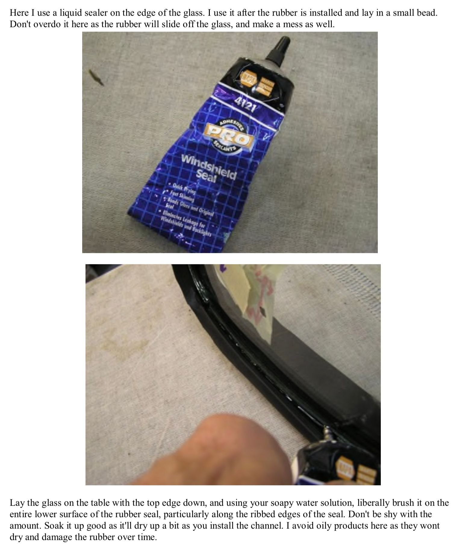

I am not an expert, but I have been studying a few here on the forum. If you can move the windshield up and down, it is more than a sealer issue. The ST-12 states to apply a “medium bodied non-hardening sealer” to rubber channel. I used 3M Auto Bedding and Glazing Compound 08509 and Rich Mozzetta suggests a NAPA 4121 sealer in his instructions (photo excerpt below).
It took me several attempts to get mine right, and one of the problems I had was not getting the windshield completely in the lower channel (ST-12 excerpt below). When I placed the assembly on the car, the bottom of the windshield was out of the rubber seal (photo below).
On another attempt, I did not hit the upper post attaching nut plates with the screws and that let the windshield “float”, so that is an area I would ask you to focus on. Good luck!
Windshield out of lower seal.
Rich Mozzetta’s (Rich5962) instructions:
